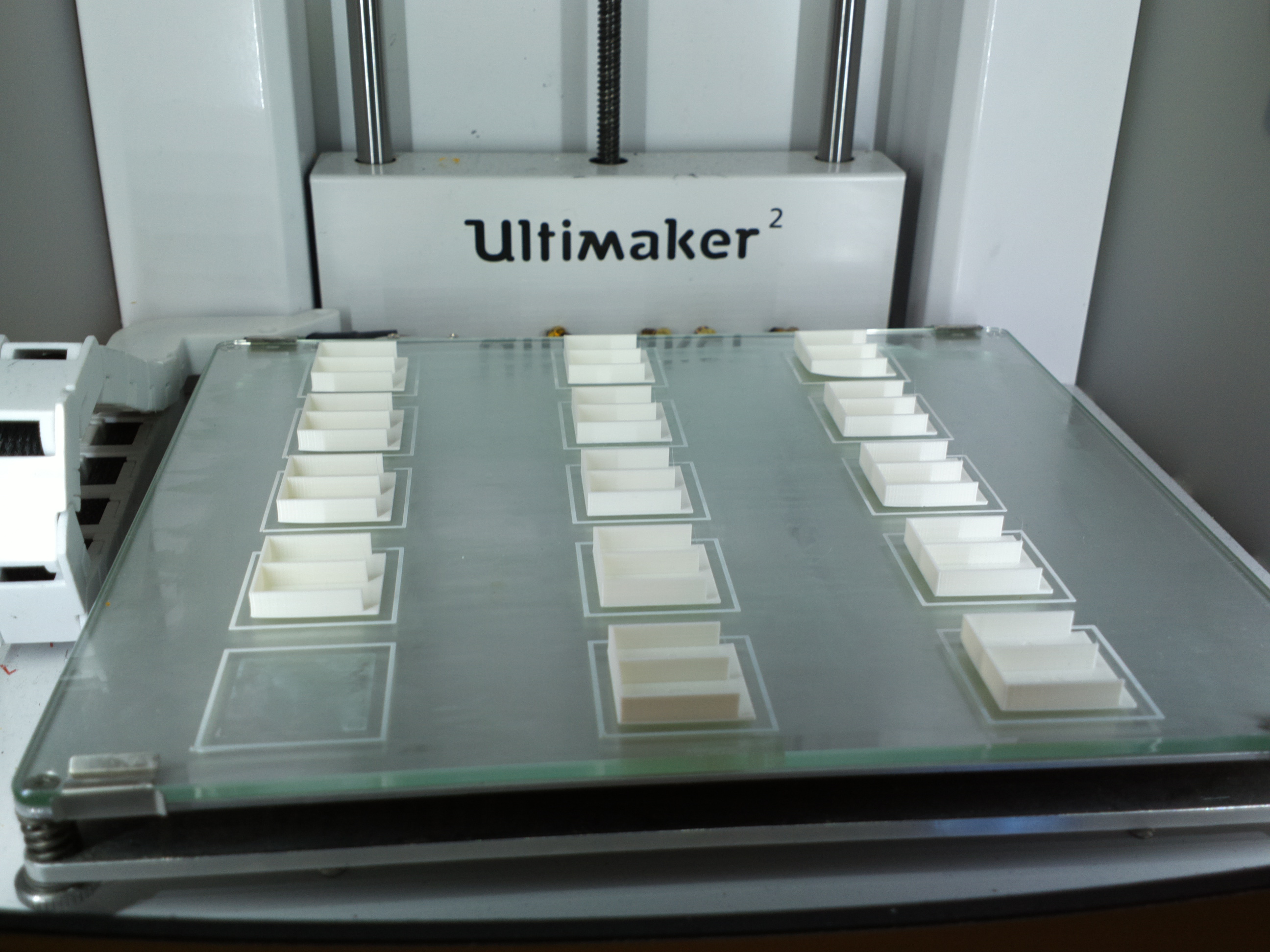

This it's the same object, printed at the same speed on2 machines. Oiled, cleaned and with very good umo+ gt2 belts and misumi shafts.
At first sight everything looks ok on both.
Lets check the umo+ and look at the 2 of the 27
More about that gap later. I finally found what makes the umo+ suck a bit (and we should design something to fix it)
Ok now um2
So, um2 looks better at doing flat layers (it really does) but... (ok more about this later)
So. First of all umo temp was 210, um2 had to be 220. But not because I can't print at 210, but because on um2 hotend at 210 this happens.
Check from left to right 210-215-220C using faberdashery pink.
To get the glossy 'on' on um2 I must print 10-15C higher than umo. Ok this might be the pt100 but also, I can print at 210C without any feeder problem. And on umo I never got this matte effect not even at 185C. So it's weird but I have this effect on faber pla's (mint, blue, pink, vanilla). So I think must be because the hotzone of um2 hotend it's just smaller (umo hotzone it's almost 2-3 times longer).
