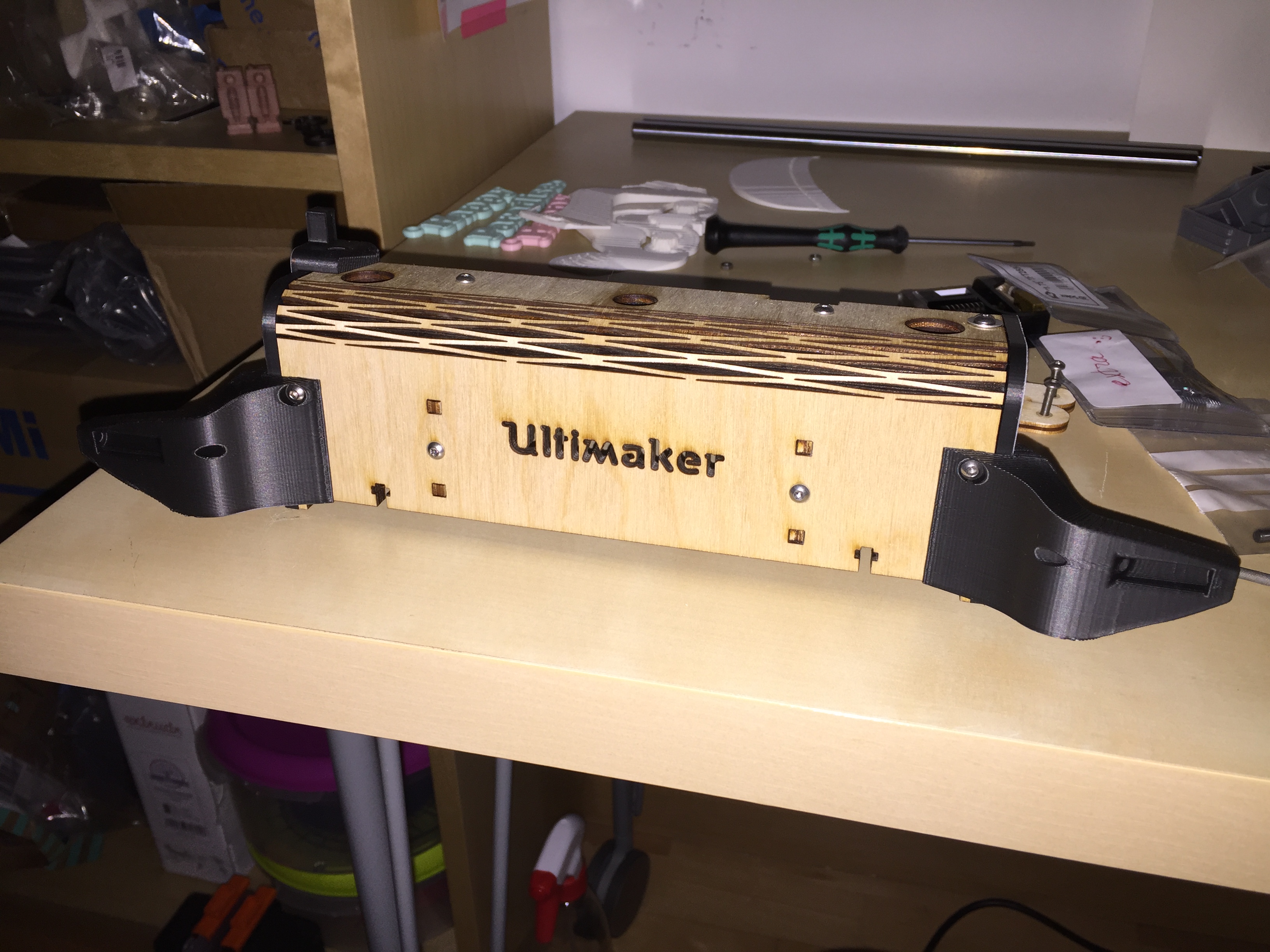

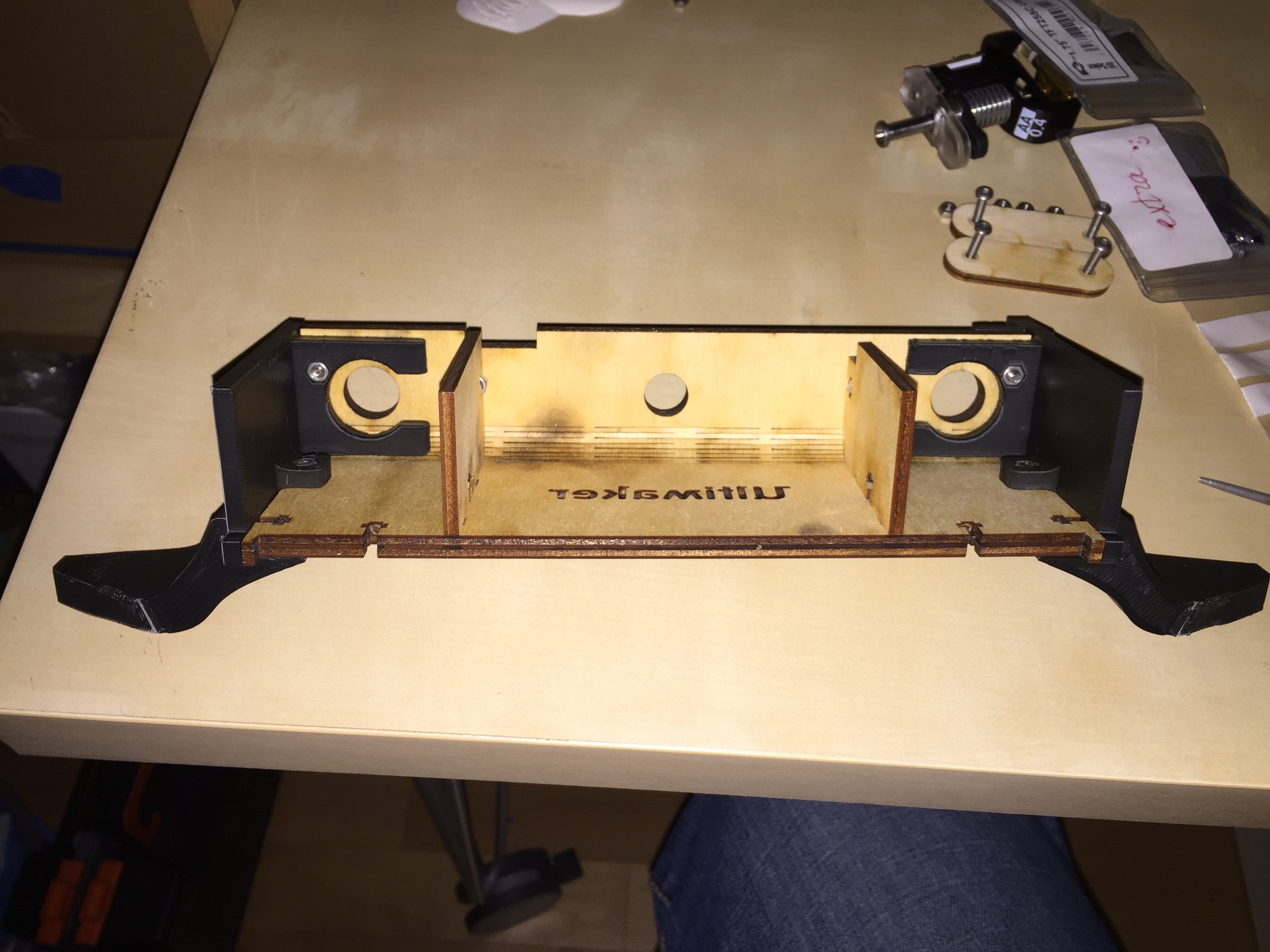

Neotko
Posts: 1142
Joined: February 7th, 2016, 7:02 pm
Location: Madrid
3D Printer(s): UMO+ x2.5
Re: Z-axix linear bearings
Post by Neotko »
This is what I made for umo+ for Gudo mod
I'm very busy this week specially with a cold and being half time on bed, so I will probably upload it this weekend.
antiklesys
Posts: 183
Joined: February 13th, 2016, 8:01 am
3D Printer(s): UMO
Post by antiklesys »
Neotko wrote:This is what I made for umo+ for Gudo mod
This looks interesting Neotko, I also saw in another post (the one about removing pla prints with window cleaner) that you printed a replacement part in PLA for the remaining wooden part of the Z cover. Do you have a link to that design too?
As I made my own HBK (but it's basically the same as the UMO+ just with chinese parts) I don't have the wooden pieces and would need to print it all.
