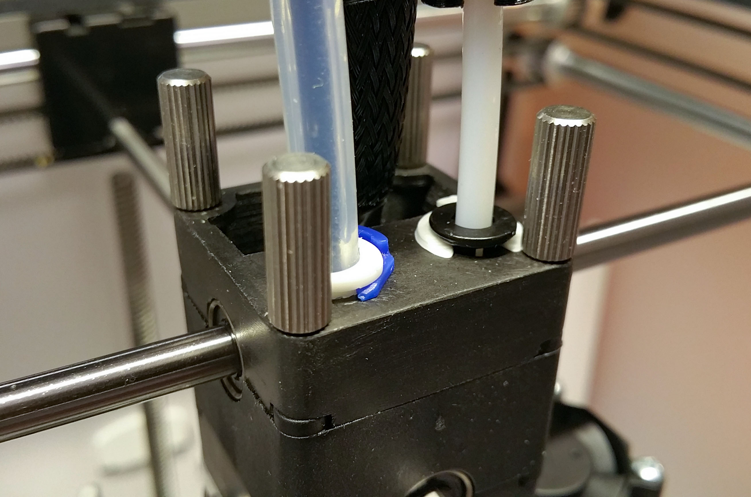

I will admit, I have some apprehension about this filament since there's been discussions that the UMO printhead may not last long at the temperatures needed for this filament (240-260C). Will the peek survive this for long? Or is this filament better suited on something else?

I did set a 25x25 fan focus on the ptfe coupler/peek to avoid surprises but even so after half a colorfabb xt spool at 255ish the lower part of the peek/barrel started to deform. I'm more worried about that stuff melting (releasing toxic fumes) than it being destroyed since I got a bag of china peeks for emergencies.

Okay, I would just hate to take apart that print head if the PEEK and teflon coupler got got cooked and deformed.

Finally found the photos of the old peek. I killed it some months ago and now I'm just using a china peek on the main machine. The deformation did stop at 250C and never got any worse (I killed it by boiling it on oil... I know bad bad idea).
