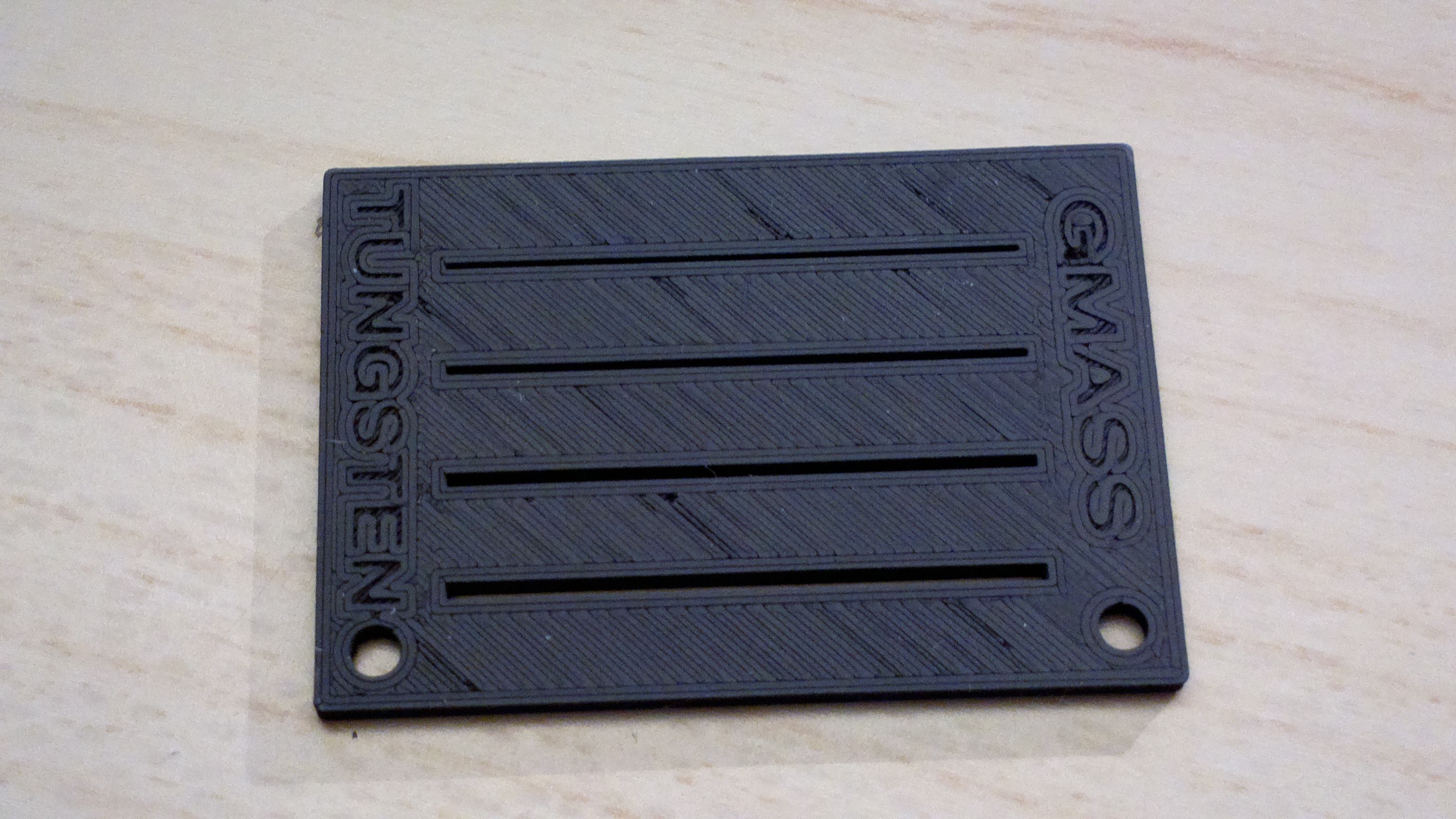

We intend to use this for printing components for our X-ray diffractometers, here is an example of a test piece I made:
(This one does not have a particular purpose other than testing how well this filament prints)

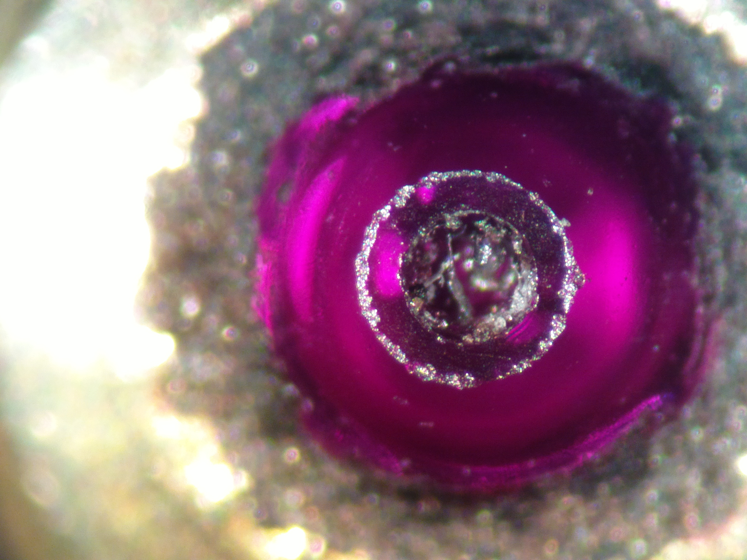

The last point means the ruby is not safe anymore. Tungsten may be softer than Ruby but the sheer size of some of the particles means you can still break chips off the ruby. Here is how the tip looked after a few hours of printing:
That wear will not affect the printing quality and the nozzle will likely survive for a long time, but it is good to be aware of this.

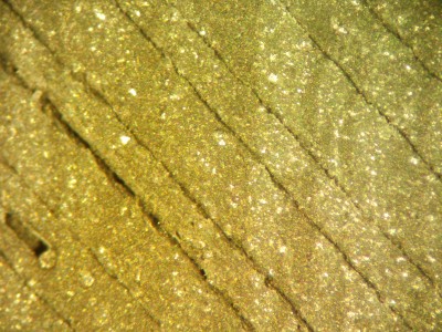

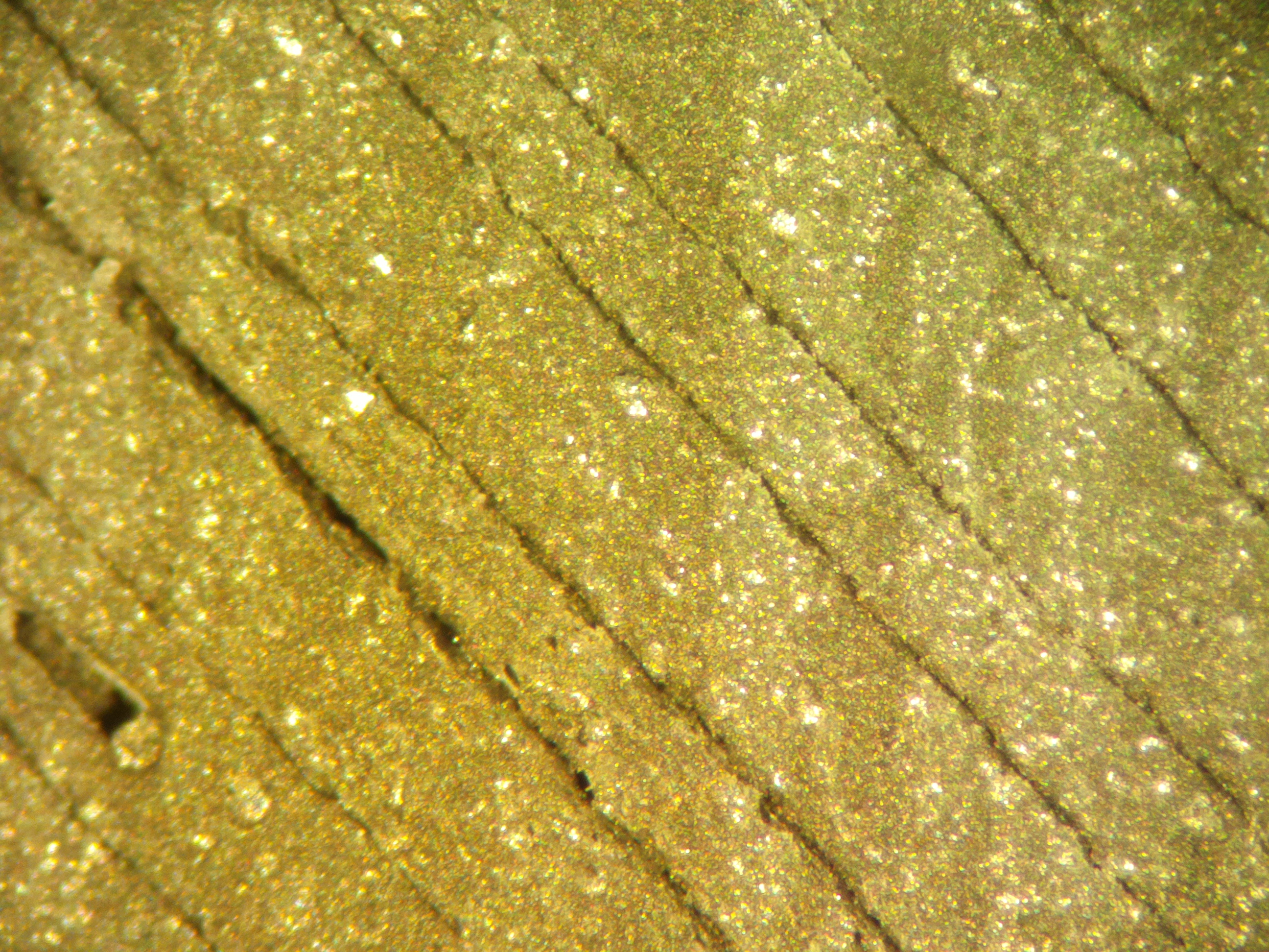

I used diamond lapping film to polish the bottom surface of a print to check for large grains and here is how it looks.
The line width of this first layer became a bit uneven, but the average of two lines is 0.8 mm. You can imagine when I started printing at 0.2 mm initial layer, which was more like 0.1 mm in reality, and those huge particles get caught between the glass plate and the ruby (you will hear it :roll:)
That is why I would not print with less than 0.3 mm initial layer.
