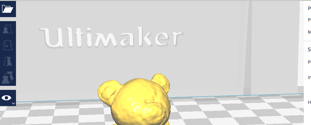

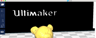

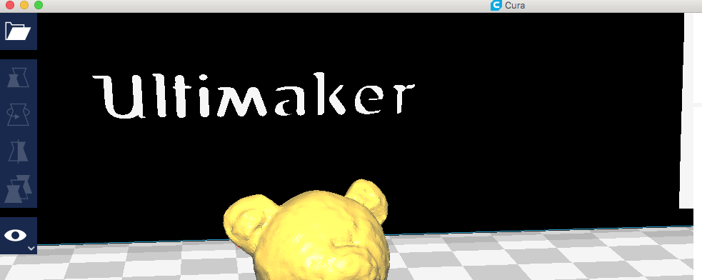

Drawing artifacts. Typically the 'Ultimaker' backround will go black for a split second when you change a parameter or hover something, giving a 'screen flash effect'.

It is not the only part going 'black' at random, but that one I can reproduce easily

Amedee wrote: Drawing artifacts. Typically the 'Ultimaker' backround will go black for a split second when you change a parameter or hover something, giving a 'screen flash effect'.
Those are graphic driver issues.
