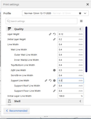

Is there a way to print out Cura's setting under Profile?
- CismontGuy

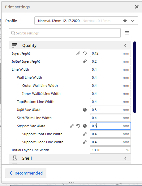

Re: Is there a way to print out Cura's setting under Profile?
Thanks. I just gave this a try. Obviously it does show you what the setting are but a little hard to read. Good suggestion, though.
I put the page breaks in to try and sort it out a little...
Other option is to make screen shots and save. Cismontguy
The Screen shots are actually the best, it does take many screen shots sometimes.
This is one reason why I am starting to Use Prusaslicer If I attach a single 3mf project file an you load it all my settings are included.
There is no guess work no question everything you want to show me or I want to show you is included in the 3mf file.
