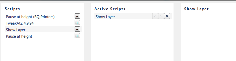

Just for your information: I tired it today but unfortunately the whole postprocessor plugin freezed/was not able to start.Amedee wrote:Here you go!

yes, that´s the way I did... strange... which cura-version do you have installed 2.1 or 2.1.1? don´t know if there is a big difference, but maybe...
Checked again, with new download, copy/paste... same behavior...

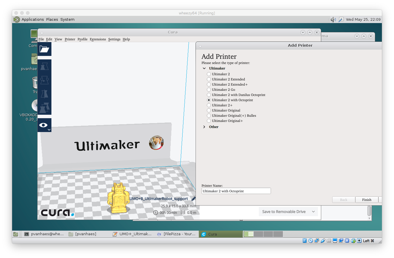

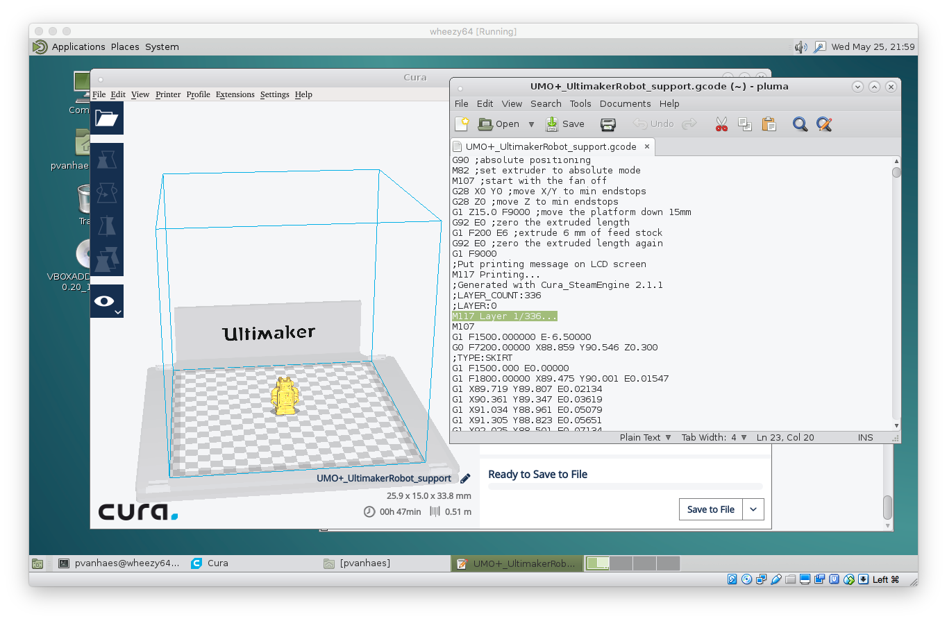

Re: How to port a postprocessor to new cura
So it works...
... But there is a problem somewhere with this Linux build.
At first I could not get it running: as soon as I opened an STL file, Cura would just freeze, with almost no system activity. So I decided to trace it to see where the problem was, but then it ran.
Tried again without trace: still works!
So now I can't reproduce the problem anymore -- probably a race condition, but difficult to instigate
Bottom line, problem is not in my code
BTW, the printer profiles are working as well
