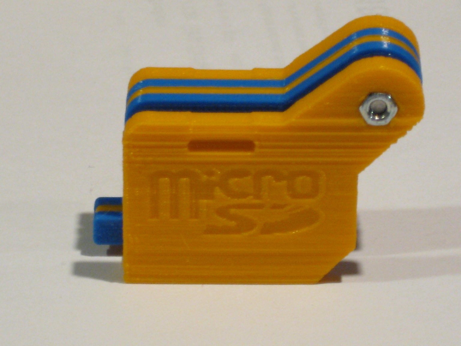

Yesterday after a long run of no bad Prints
Wavy lines only occur on the Y-Axis. Filament PLA
Layer Height 0.2mm
Print Speed 72% // slower than I normally 3D Print.
Printed model Rotated Model 90 degrees and can see no shifted layers.
Not G-Code using same Sliced code on 2nd 3D Printer with no Shifted Layers.

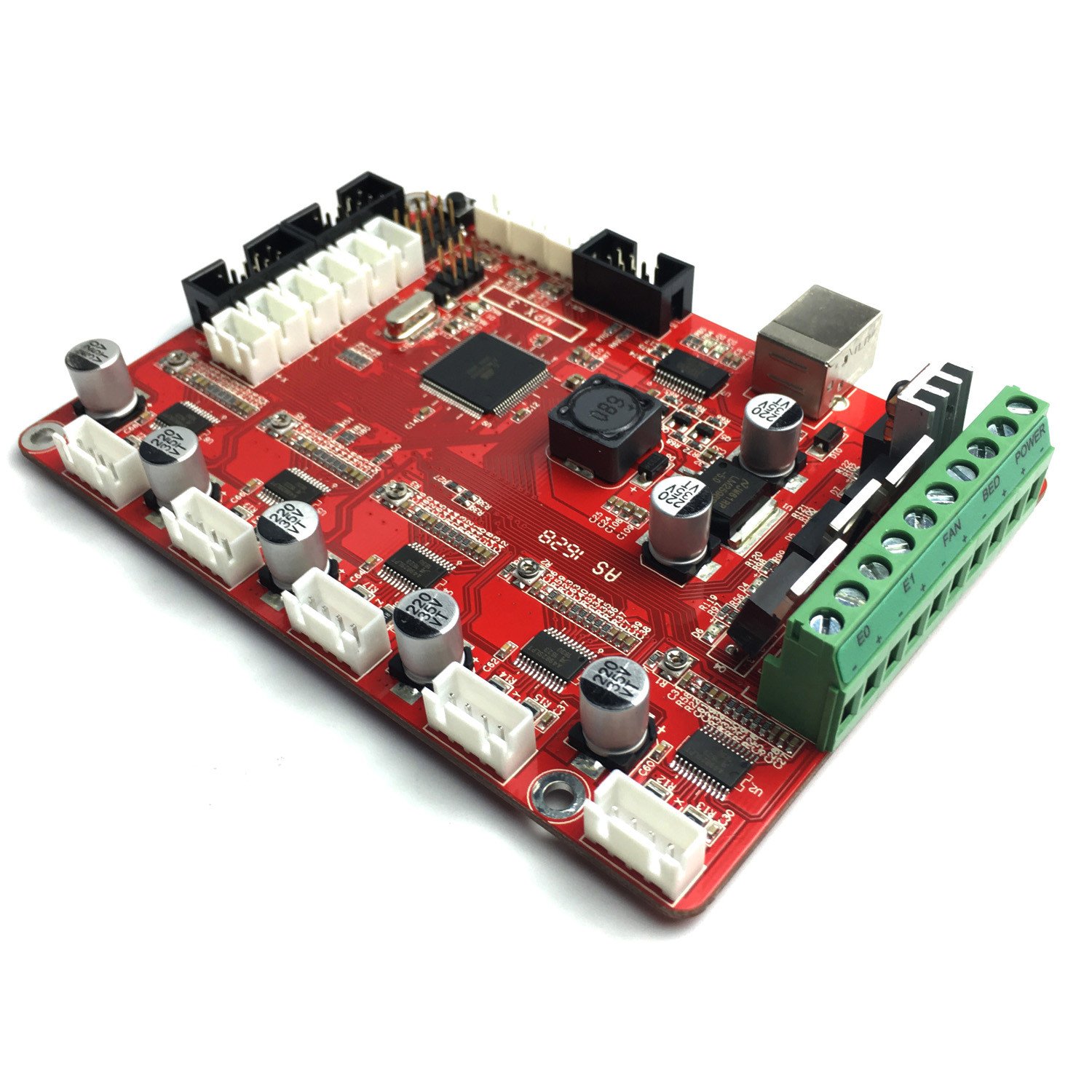

Adjusted the V-Ref current from .420 - .480 even this was working the same maybe a little more Shift.
Thinking the V-Ref maybe a little too high Adjusted down to .350 stepper would not move at all.
Tried adjusting back to .420 would not adjust A4982SLPT Driver chip V=Ref Pot, the is Chip dead.
Installed the Backup Controller with Marlin 1.1.5 Setting for Slow Z-Axis Stepper movement, Flashed to Marlin 1.1.7 much better preformance.
Now I get Thermal runaway when I run up to 86 percent print speed slowed down to 60 percent Print Speed with a perfect Print.
Will replace bad A4982SLPT Driver Chip.

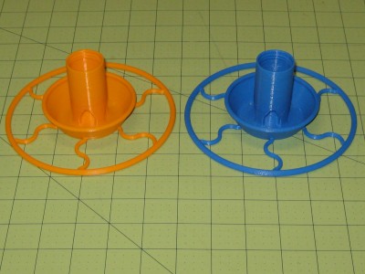

Today I doing layer height testing, I 3D Printed some solid Z-Axis couplers to see how they work.
In the photo the Left coupler was printed with Aluminum strain relief couplers. the one that are cut in a spiral shape.
The coupler on the right was printed with the Coupler Installed I just 3D Printed.
You can see the Layer shifting on the right coupler it has a measurement of 2mm which is the rise per revolution of my Lead-screws.
T8-2 single start - 8mm lead screw with a 2mm pitch single start.
Returned the Original Couplers to the 3D Printer perfect Prints again.
I am now going to adjust the Couplers on the 3D Printer that has Layer Shift.
Inserting the 8mm Lead-screw only enough to catch the locking screws.
Inserting the 5mm Stepper motor shaft leaving about 10mm of the Stepper shaft exposed.
A microscopic change for the better nothing to write home about.

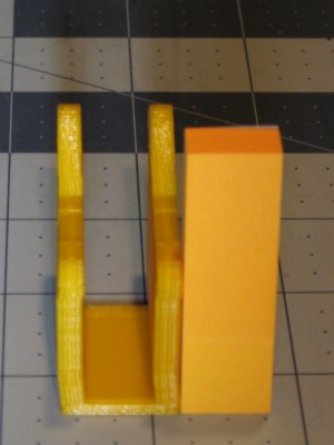

Found the molded Right Z-Axis lead-screw mount is split down the linear bearing tube. This may be what is causing the Y-Axis layer Shifting.
This would be the smaller of the two Z-Axis lead-screw mounts. Was told that the molded parts were better guess not.
Temporally Epoxied to do some testing will verify with further prints for layer shifting, will ordered or 3D Print replacements.
