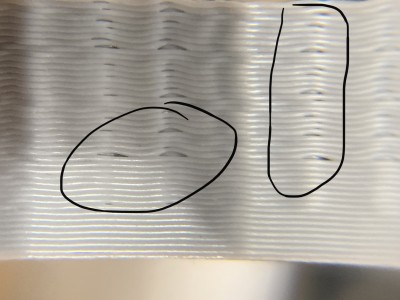

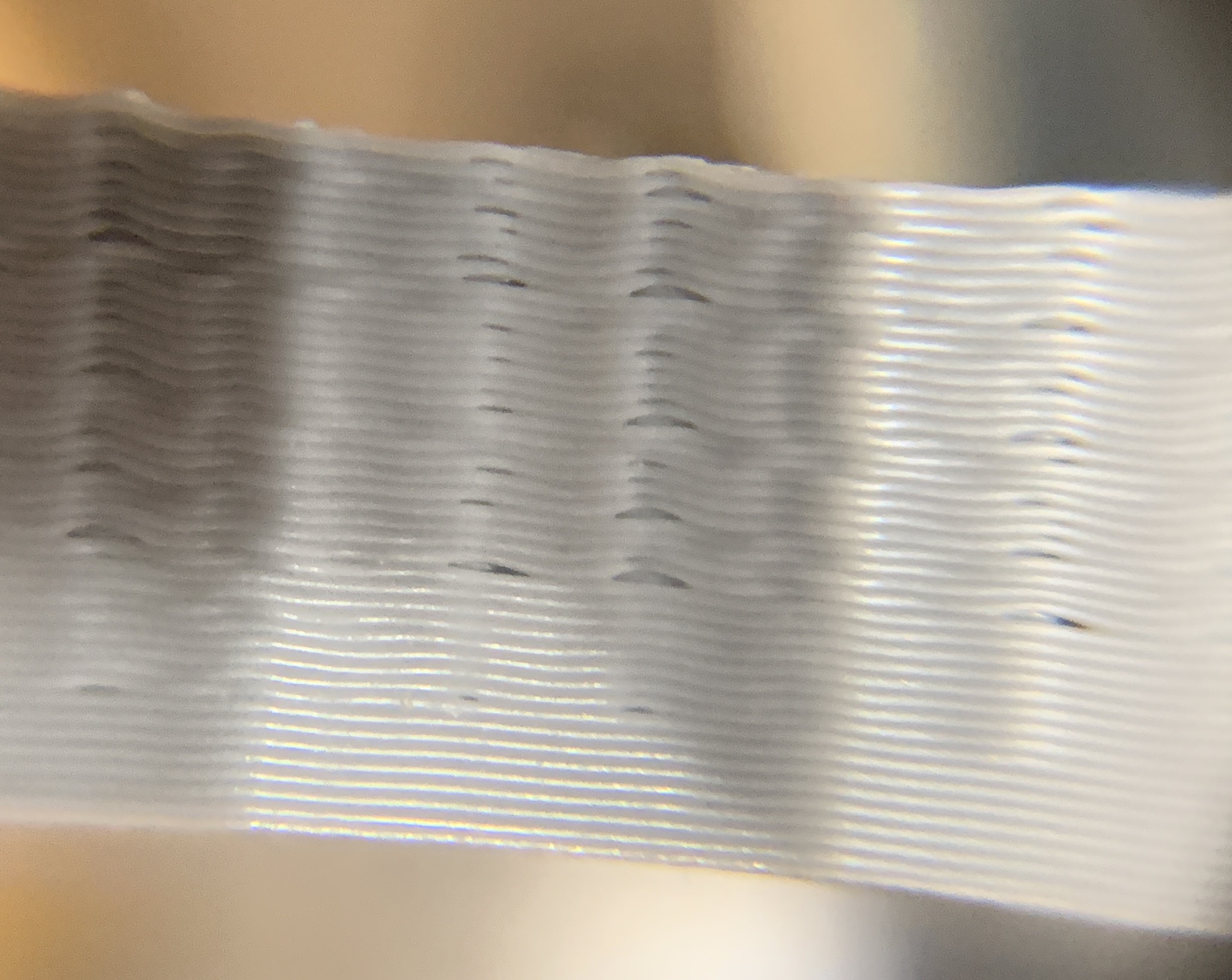

Hi all, I bought a new printer which is an ender 5 and it seems like a well built printer. However when I’m trying to print the piece in the image below, I’m getting these little jumps/bumps on the outside walls that’s making my print not looking good please see images to see or explain more of what’s going on.
I am using an ender 5 printer
I am using Cura 4.4.0 version
I am using 0.25 mm layer thickness
I am using wall line count of two printing speed 80 mm/s
I am using 0.4 mm nozzle with PLA
What settings I should be adjusting to possibly fix this problem. I’ve tried multiple things but it seems nothing is getting me good results any help is appreciated
I need to fix these bumps on my print.
Re: I need to fix these bumps on my print.
Try a smaller layer height. I print with .2mm as standard, and smaller for finer detail (.16 for fine, .12 for super detail). You might also want to lower your speed. I print at 50mm/s with wall speed of 25mm/s.
