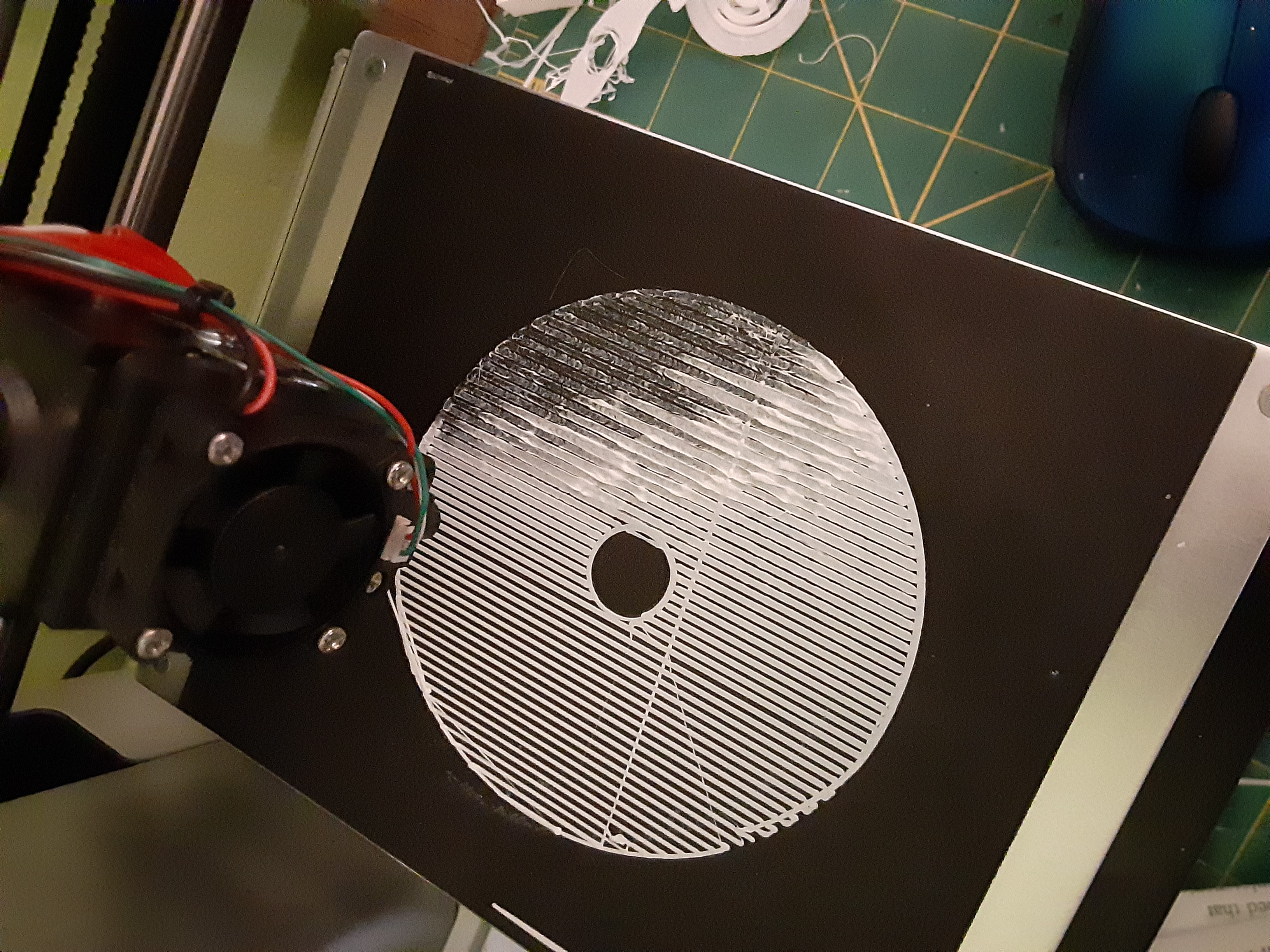

I have a monoprice mini select v2 and it was working fine for a few prints but then this started happening and I don't even know how to describe it to sind a solution. It always happens on that side of the bed. Any help will be appreciated

This is a bed leveling issue.
On one side it prints correctly, the other side is squished until the filament can no longer be extruded.
However I do not know how to correct at this time, Will search the web to see what can be found.
Watch the Bed Leveling video in this Web Link.
https://www.mpselectmini.com/bed_leveling
