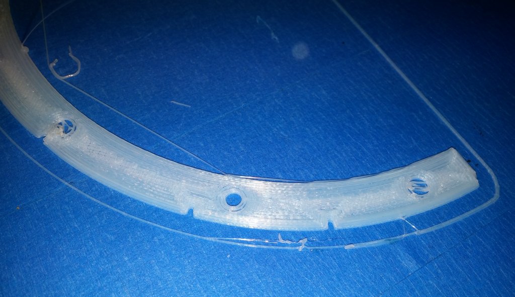

Progression on the HIC i3 is getting better every day, however I still have issues with 'stringing' on dome or circular shaped objects. This image is of a BB-8 top dome piece, left to right: original printer settings, some calibration, then on right with a center support that broke off and left stings of fiament in the top:
Here is the tops of the center and right dome parts:
Then today, a Star Wars Thermal 'Detonator' thing from the movie, well here is the lower part, outside and inside view. You can once again see stringing near the top in the inside view, outside looks good enough and is usable I figure:
(Object located here: http://www.thingiverse.com/thing:185165)
And just started printing the Thermal's top part and it started stringing on just a few layers after the start of the print:

I am not 100% sure, but from the pictures I see, this is not stringing, this is bad layer adhesion. So if this is the case printing colder will make it worse...
Your model has steep vertical angles, so there is little overlap between layers (check the 45° rule)...
A couple of tips that might help, depending on the situation:
- Print hotter to get better adhesion
- You have not mentioned your layer height, but if possible you can use thinner layers, so you get more overlap on layer by layer basis
- A tiny bit of over extrusion
- Ensure you print the inner walls first; use 3 walls instead of 2.
('Inner walls' in 3d solid printing terms, not in the inner part of your object ) - Don't print too fast -- if your 'perimeter speed' of 40mm/s applies to all perimeters then it is OK (it is not clear from your post if it is for all perimeters or not)

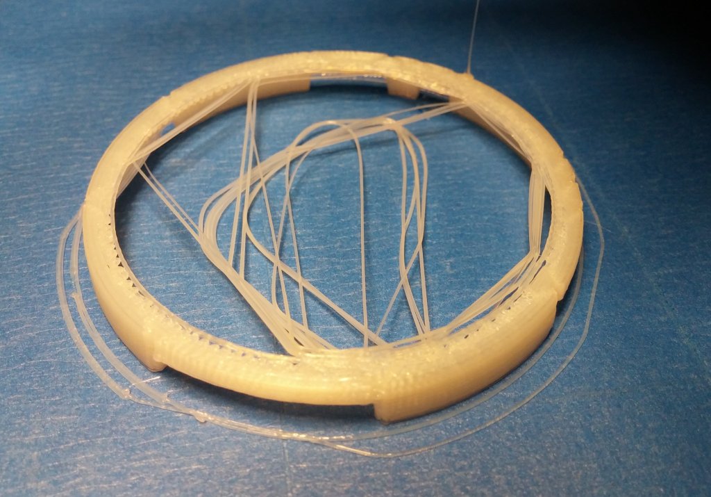

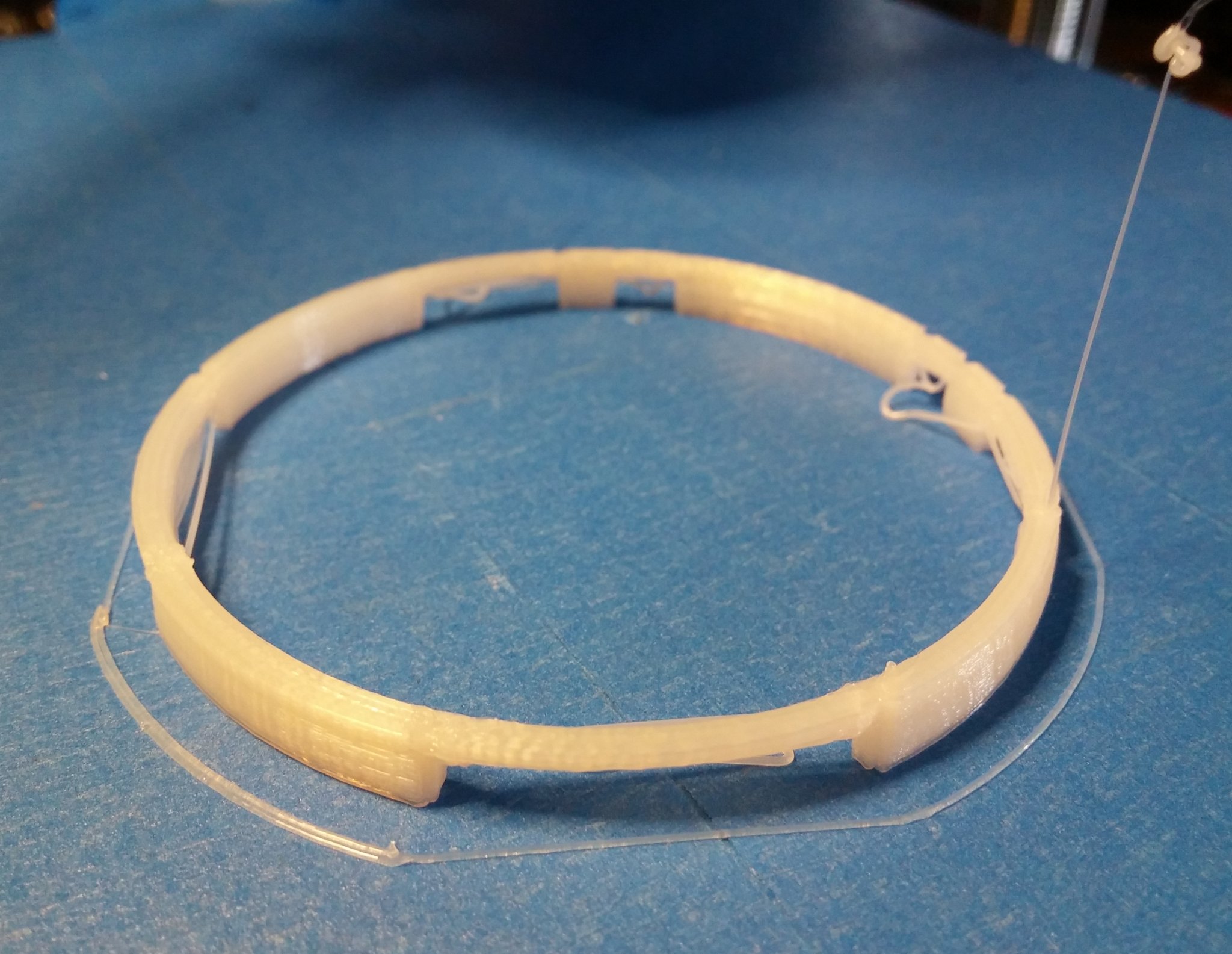

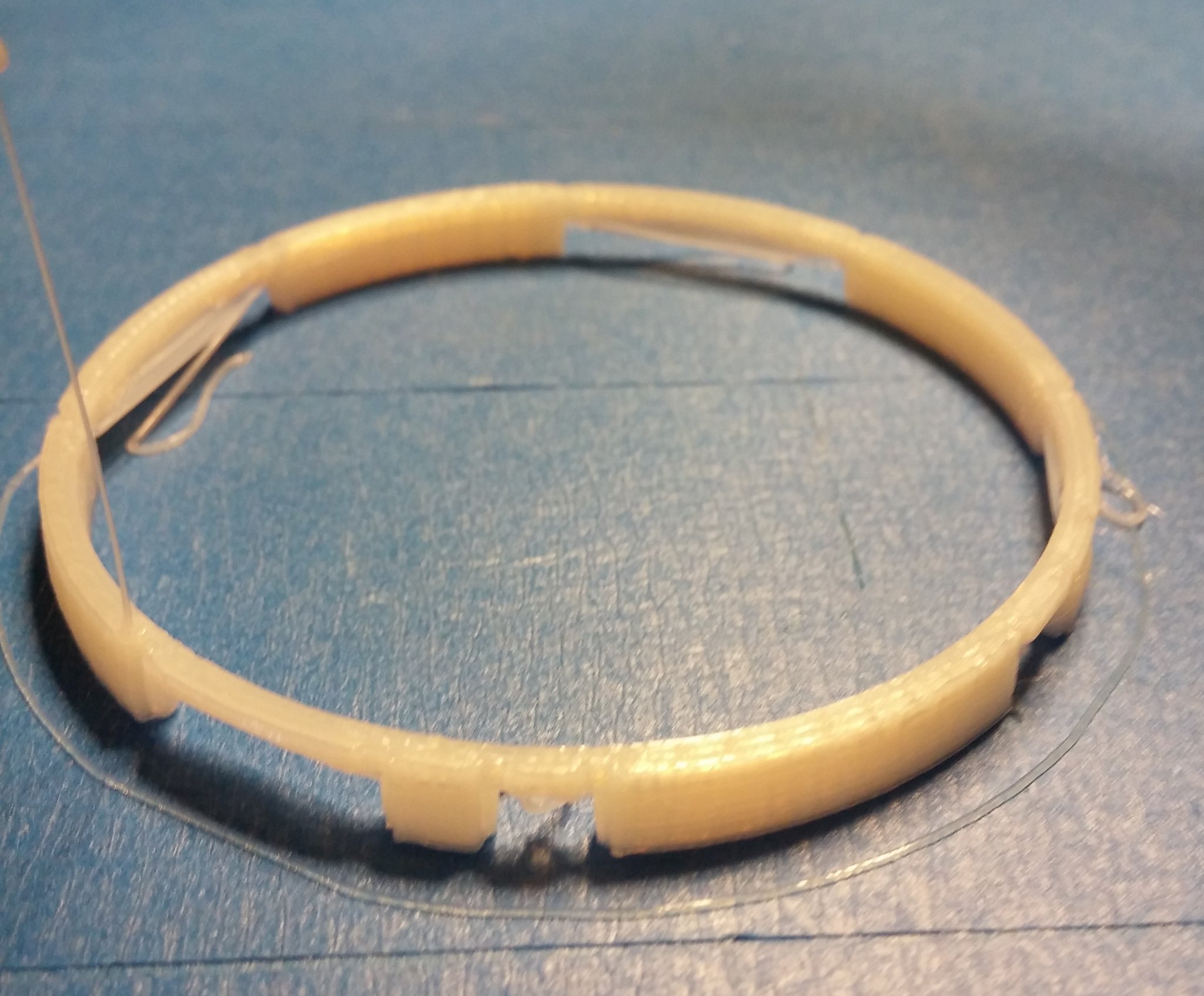

Printed a just a few layers of the object shown below and is not a angled part. Yet after a few layers it appears to have adhesion issues, again a circular object which seems to be the problem (along with angles show in previous post). View 1a and 1b show inner adhesion issues and also look closely at the holes inside the ring, has same issue. However some of the holes printed fine, makes no sense to me. Same print setting as before.
View 1a : Ring with inner adhesion issues: View 1b : Ring with inner adhesion issues: View 2 : Ring re-printed this time with print speeds lowered a little and only 3 perimeters (my default setting). Things improved quite a bit: View 3: For reference, Host screen shot of ring object: View 4 : And again, the object without angles, only circular (after just a few layers printed, bottom layers adhere?): Looks like a combination of speed and temperatures. I cannot see lowering the speed a whole lot, it will take forever to print parts and this printer should run at least 50mm/sec max print speed (for a 'slow' setting) and up to 80mm/sec for draft or fast speed. Default still to 120mm/sec max travel speed.
If you have any suggestions for a circular calibration object let me know. I'm going to make those changes, inner before outer and increase temp.
Thanks again for all you help. Cheers..

Yes, walls and perimeters are the same thingsChip Luck wrote: I would assume inner walls means inner perimeters? Slicers use different terminology, I would assume with Slic3r with inner perimeters set at 3 it will print one outer and 2 inner perimeters or walls.
I would go to 0.15 (or 0.1, but that will take a very long time...)Chip Luck wrote: // Layer height was set at 0.2mm
Yes, that will offer a bit more material to rest on when you print the outer perimeterChip Luck wrote: // Slic3r was set to print external perimeter first for some reason. Will be unchecking that option to print inner perimeters (walls) first.
I am not sure why you would want to recalibrate after changing temperature. It is very common to tweak temperature for prints.Chip Luck wrote: // Nozzle was set 205c. PLA print rated at 190-220c. Will up temp to 210c, however extruder/flow will need calibration
You probably need to review your expectations here. On the Ultimaker my default speed is 40mm/s and I play in the 30-50mm/s range. I don't think a Prusa i3 can go much faster than that... I worked with a Mendel 90 (which is a more stable version of Prusa I3) at the FabLab, and the speeds were very similar.Chip Luck wrote: this printer should run at least 50mm/sec max print speed (for a 'slow' setting) and up to 80mm/sec for draft or fast speed.

I looked more closely to the the print and now appears the reason is due to large gaps/bridging on the lower layers. If you look at the object now, it has quite a span to accomplish after the scattered bottom pillars are printed, we have not even gotten to the dome yet. I'm surprised the machine even pulled off attempting to bridge a gap that large. Second object printed post above changes follows, and did not go high enough this time to show there is an inside flat/flange that was causing all the other adhesion issues on the previous print.
So the question now is, how to print this thing? I assume supports will be required for bottom and possible the top dome area, going to give that a try.

Indeed you need supports. One think it's to print a linear bridge, but a curve one, that's just black magic. Supports, don't be afraid to use them, they are to support you... Worse pun ever...
Re: Dome and Circular objects 'stinging'
Alternatively, cut it in 2, print separately and glue...
