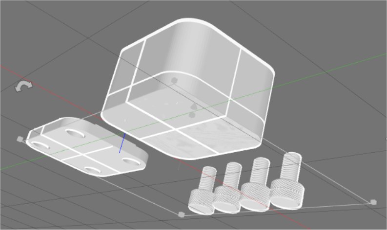

I downloaded the model from https://www.thingiverse.com/thing:3032434
I found that when I used Idealmaker slicer to split the model the lid was in 4 parts the box accounted for 8 parts.
I tried a 2nd slicer MatterControl below is a good view of what was seen..
I Tried to use ThinkerCad an online slicer, this also failed.
