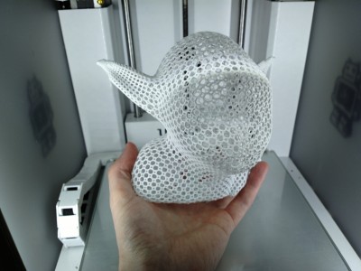

Anyway, I did a retraction test with the latest iteration of the pancake feeder today, and it passed :-)
Retraction speed 30 mm/s and retraction length 0.85 mm certainly speeds up things
I think it printed in about 12 hours compared to the 17 hours predicted by Cura :)

I'm sorry, I haven't made myself quite clear. I recently installed a flex3drive on my printer and I'd like to see how it compares to your pancake stepper. I meant to ask for the model of Yoda. I found one on thingiverse but it seemed to not be the same as yours.

It was a little bit tricky to get the first layer right, had to drop the model a mm or so because the bottom wasn't really flat. I'll post some pictures tomorrow when it's done.

Hmm, S3D estimated a printing time of about 13:30 hours, but it was off by a lot. It has been printing for about 20h now, but it's still only 2/3 done. It's looking pretty good so far though:
There's are a few tiny hairs in some places, but nothing that a quick blast from a hot air gun won't fix. If you look closely on the right side on the inside of the ear, there's some strings hanging there. That is due to an error in the model, it has an overhanging piece that could never be printed without supports:
Edit:
The print was finished this morning:
I'm quite pleased with the result. The top of the head came out a lot better than I had expected. The bridges at the very top sagged a little bit on the bottom, but you have to know it's there to really notice it.
The overhangs did also sag a bit here and there. Those probably would have turned out a little bit better if I had set the print order to inside out. I used outside in because the first layer required it, as there were many single dots of infill that would not stick properly without laying the outline first.
I printed it in Makerpoint Pearl Gold PLA at 185° C, 50mm/s, 0.15mm layer height.
