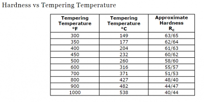

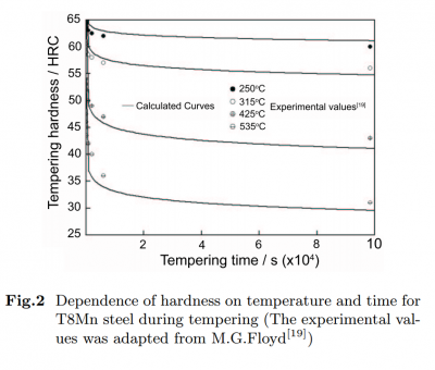

Re: Tungsten nozzle: "Premium Nozzle for precise 3D print results"
Yes, I had a look at another page: http://www.threeplanes.net/toolsteel.html
It seems the change in hardness is marginal though: Here is another source that includes tempering time: http://www.jmst.org/fileup/PDF/2004454.pdf So it tempering should only have marginal effect on the hardness/wear resistance, even if kept hot for ~27 hours as in the last figure.
In other words, I would not use this as a sales argument for tungsten nozzles.
Interesting subject though, I would never have thought about this if it was not for the tungsten nozzle
