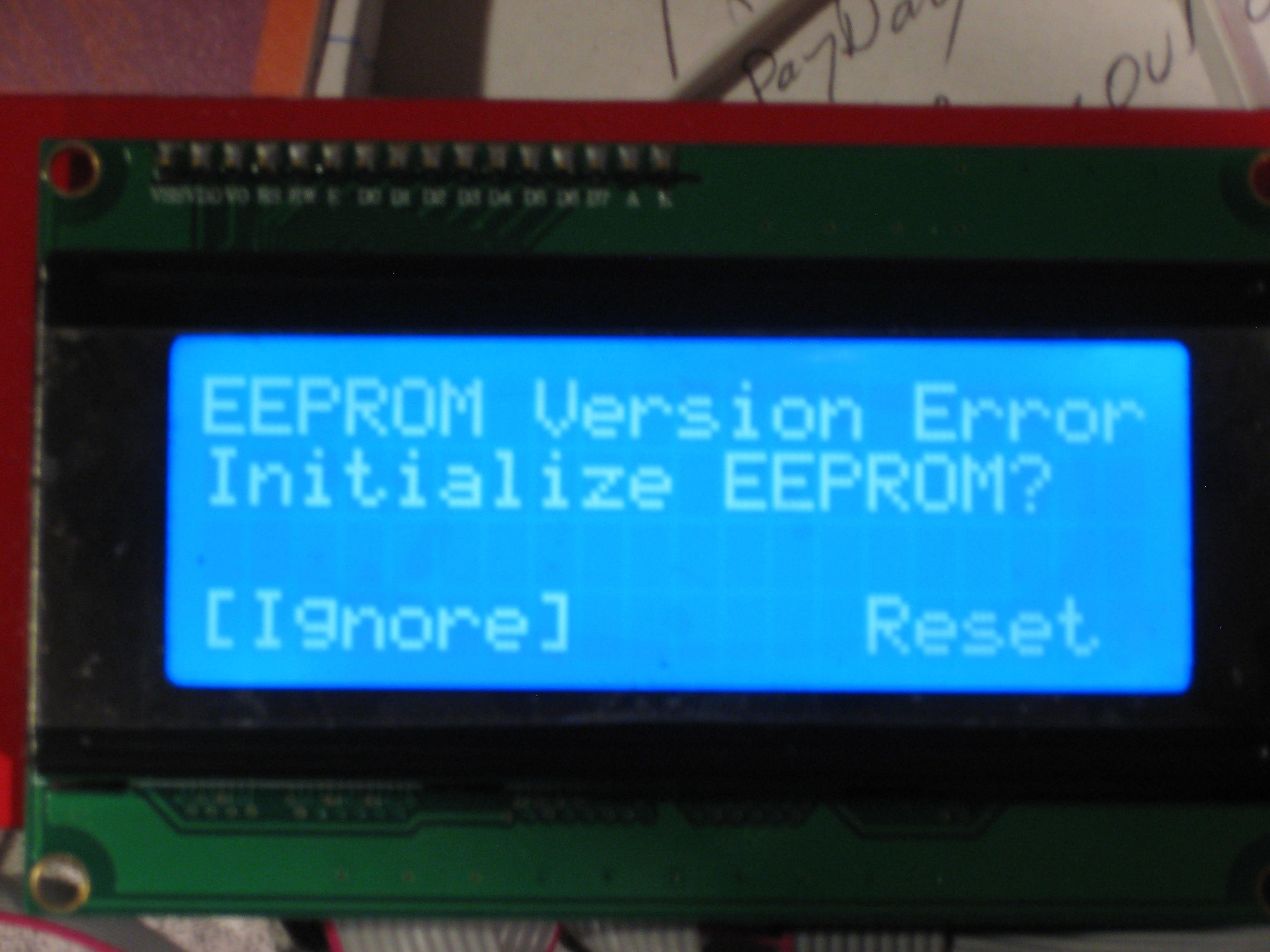

Wow! on reboot Screen showed to Initialize EEProm
This Compiled Marlin not presently in a working Hictop Printer it has been uploaded to a Dead stepper driver Hictop Controller.

Re: Marlin 2.0.6
Well if it was smart enough to detect that a new firmware was present.
Why does it not have a single Reload button to reload and save the new Firmware's configuration.
Still Have to send M502 and M500

Actually just flashed Marlin 2.0.6 on a working 3D Printer and the Reset button does load and save firmware defaults.
No further need to M502 / M500
