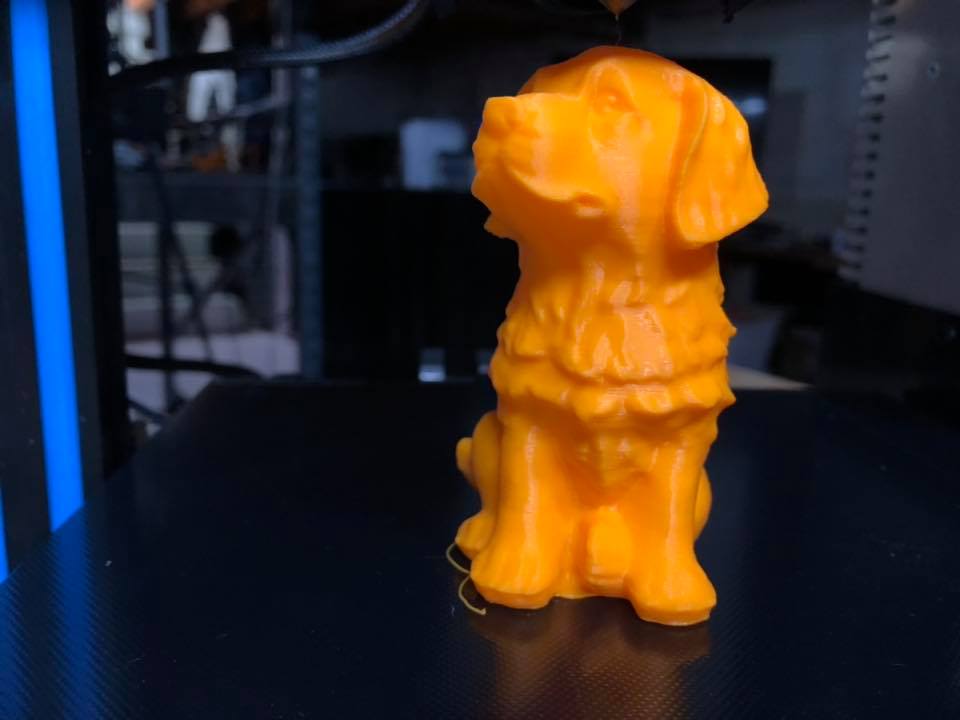

The test print included on the SD card...and it takes full size SD cards (yay!)...is a dog test print. It sets the bed to 50C and PLA temp to 210. I found 50 to be too cool and I had part of the print lift a bit on the front.
But over all, a decent print.
