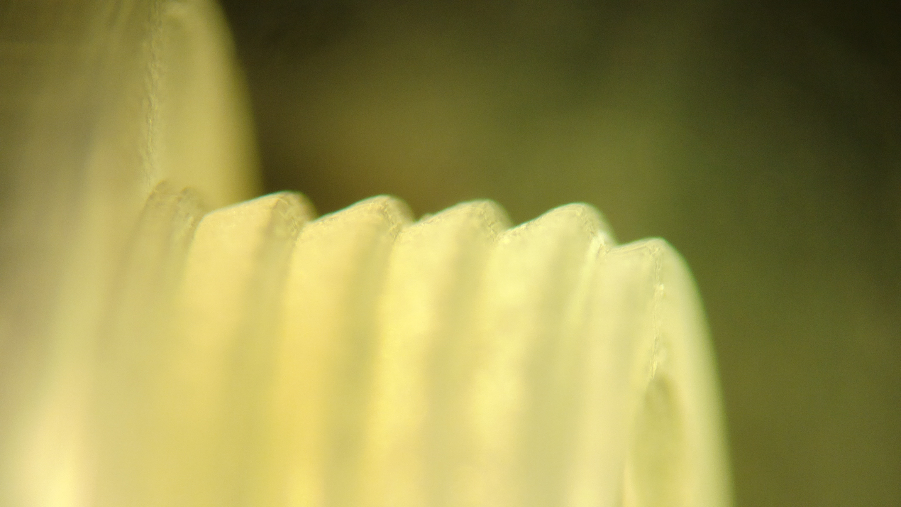

I did try to print the spacer on the Form 2 by the way, but the treads came out like this for some reason: SLA is tricky in this sense, it is much more difficult to predict what will work and what won't than with filament based machines.
