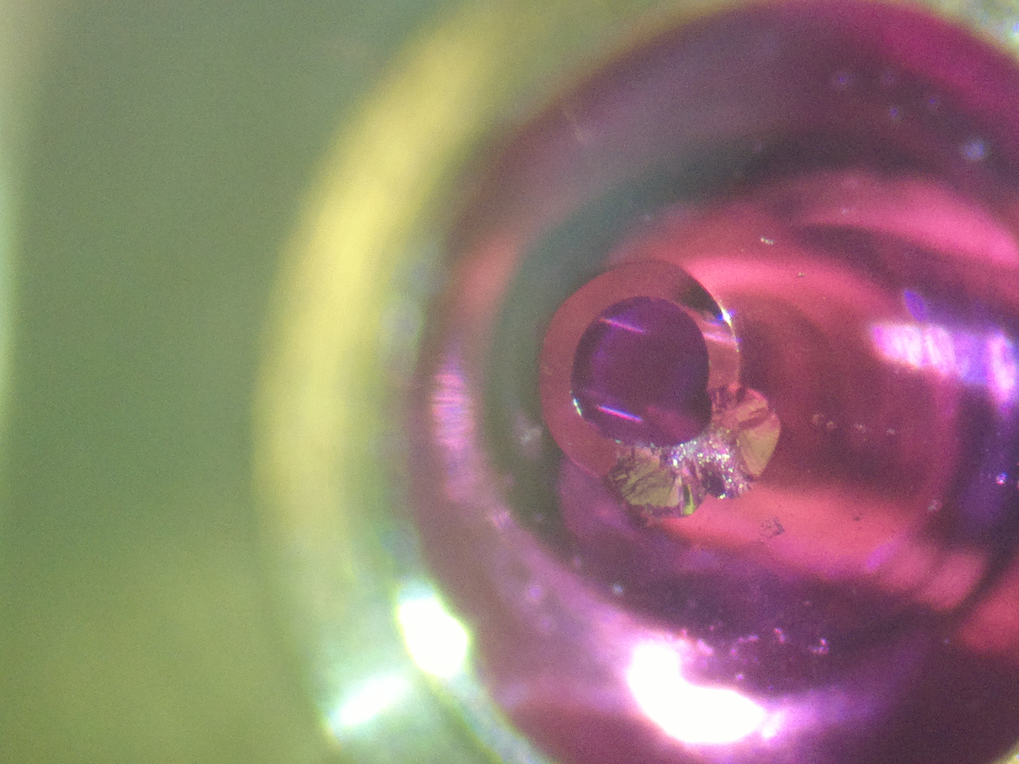

I'll just say WOW, these new nozzles are superbly machined and a real work of art...!
The orifice is spot on and perfectly centered:

Re: Super hard nozzles - Test pilots
Nice photos!
I would say the nozzles are almost too precisely machined, it scares me slightly, but so far it seems to work
For the next batch I will make some changes as I mentioned before, to make the functionality rely a bit less on precise machining.
