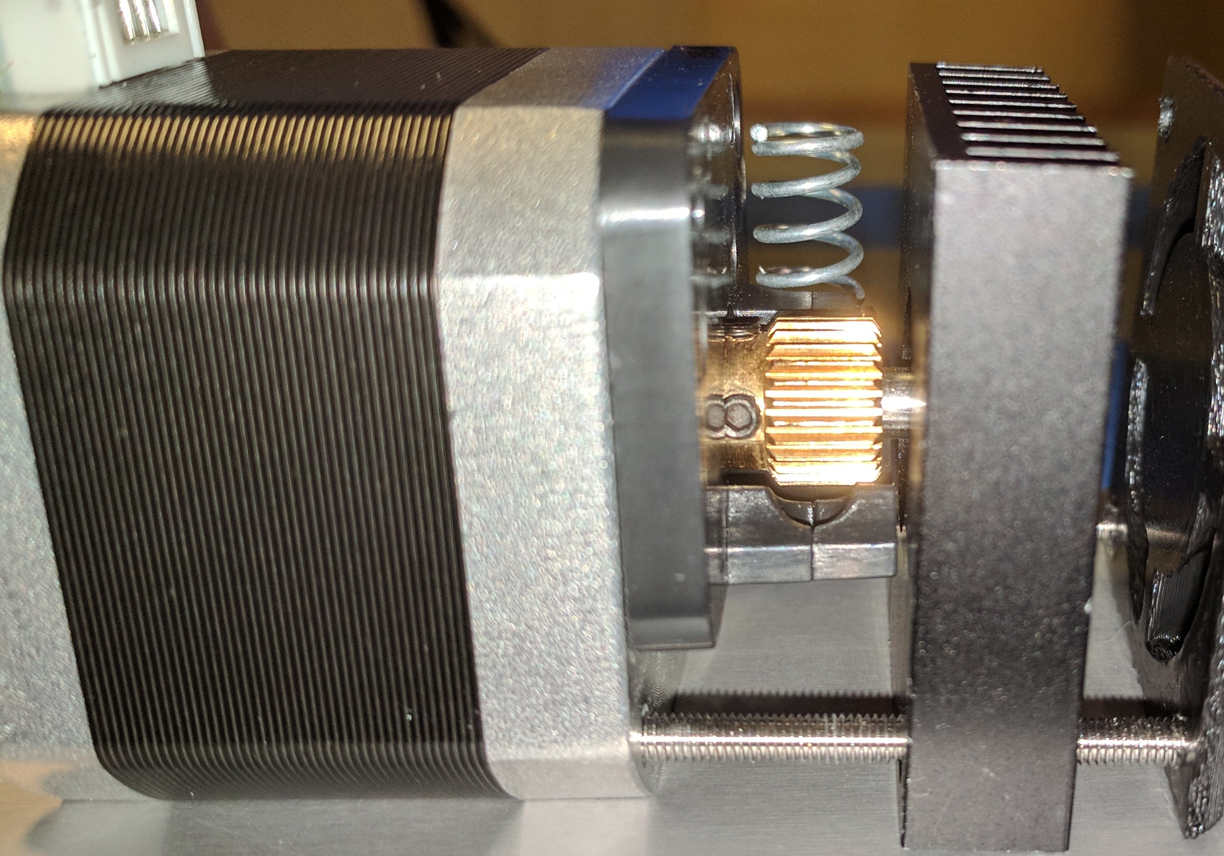

Take you fan off, take a ruler place across the stepper Extruder gear see if it the too far extended and rubbing against the Heatsink.

It could also be the filament gear is rubbing on the heat sink. Take the fan off, take a ruler place across the stepper Extruder gear see if the gear is too far extended and rubbing against the Heat sink. I had to put the extruder gear on backwards to keep it away form the heat sink.

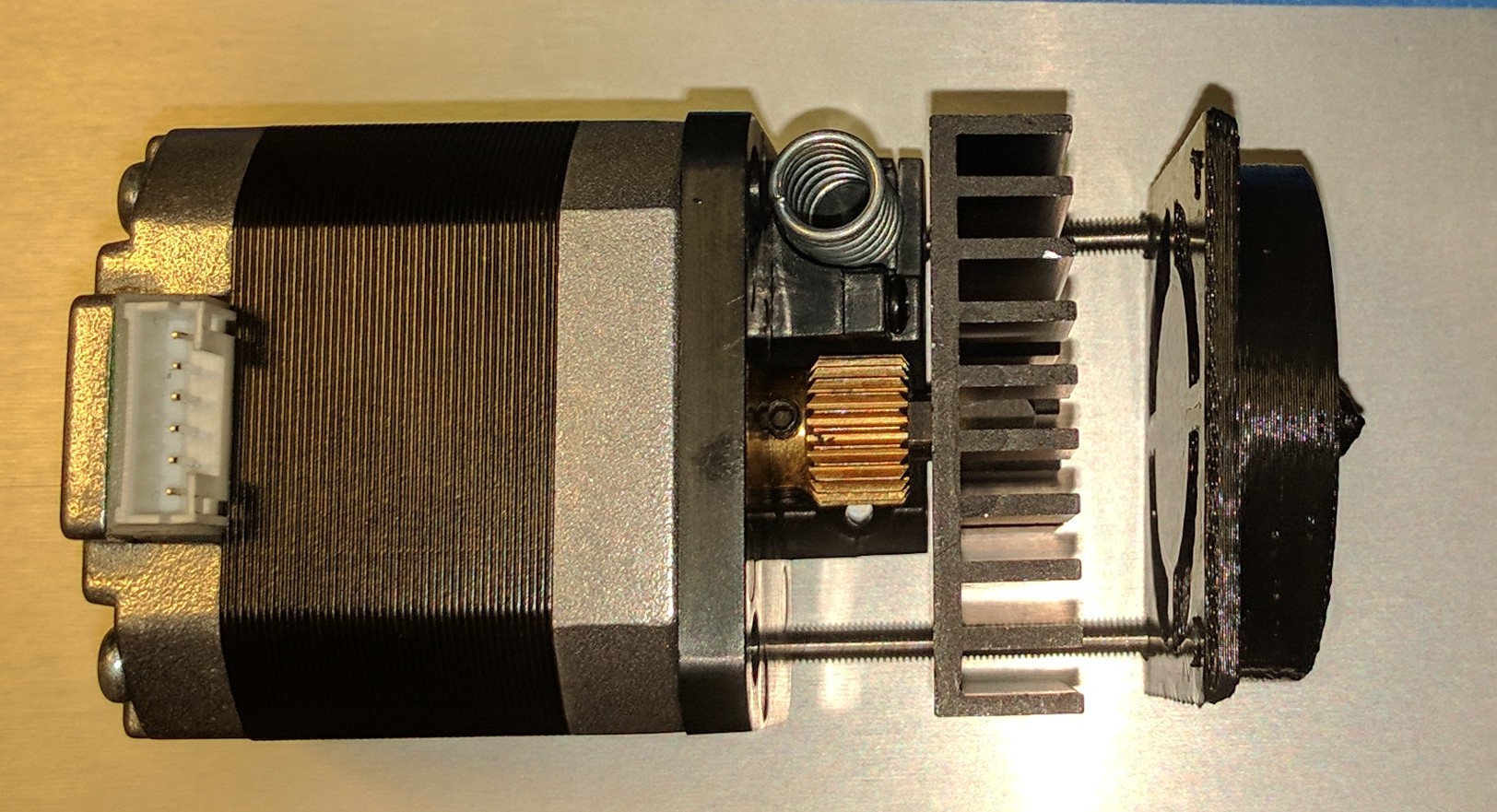

There's nothing for the extruder gear to rub on. It's recessed closer to the motor than the edge of extruder assembly. The heatsink for the fan has a cut out larger than the diameter of the gear (so even if it were sticking out, it wouldn't rub).

Does the gear rotate freely? From the pics, it looks like the gear may be too close to the motor (enough for the set screw to bind). I could be wrong though.

Seems to spin just fine.GrueMaster wrote: ↑September 14th, 2017, 10:34 pm Does the gear rotate freely? From the pics, it looks like the gear may be too close to the motor (enough for the set screw to bind). I could be wrong though.

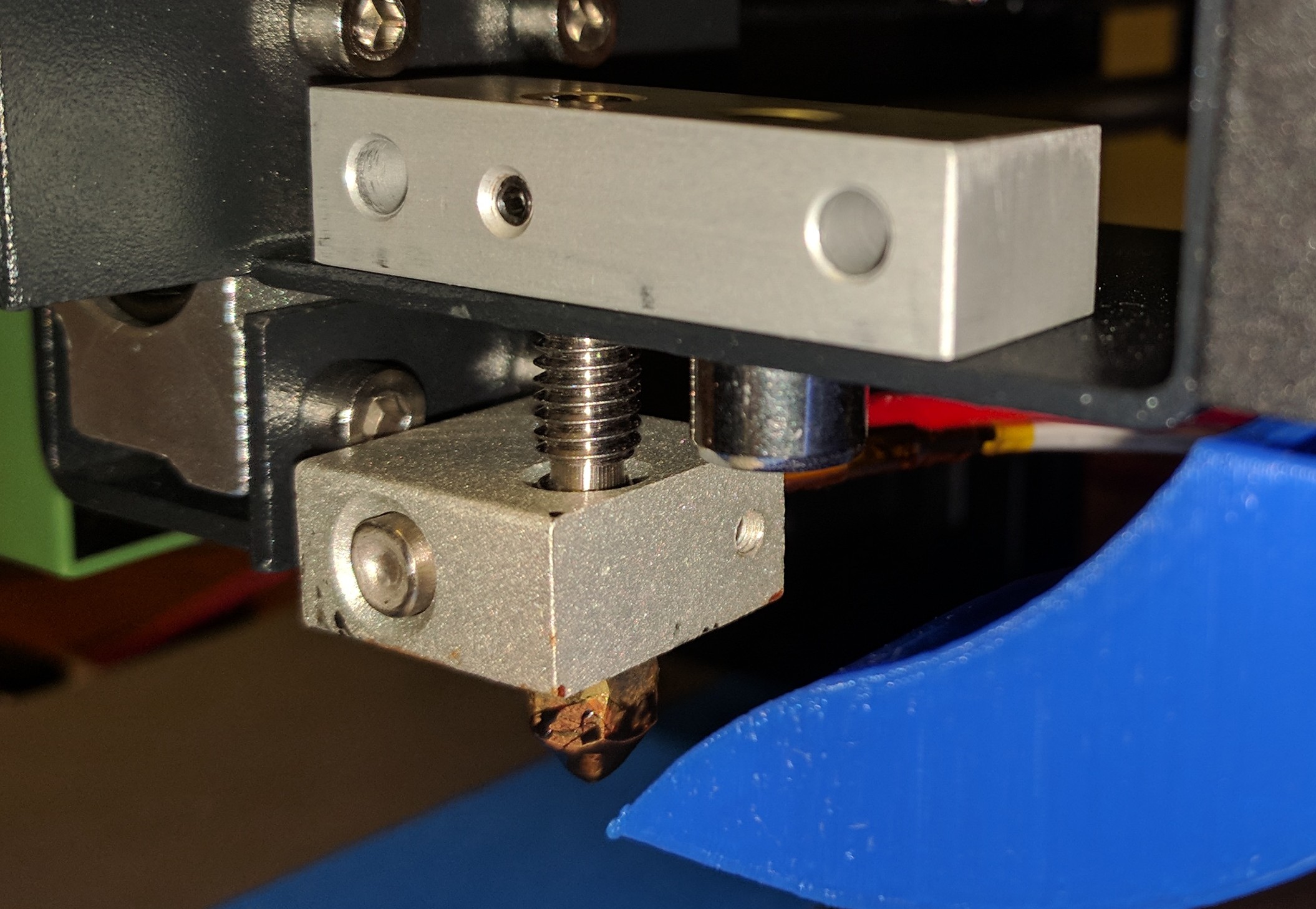

Before assembling check the PTFE lining in the throat for distortion, this can be done by pushing filament thru with it when dissembled.
When assembling the PTFE goes to the Bottom, screw the Nozzle into the heater block until two threads are exposed. then screw the throat into the Heater block and and tighten you should still see 1 thread on the Nozzle when tight.
When Assembled, I leave the throat a just below the the surface of the stepper Heat sink block.
I know what they said but it works better if it is a little lower. Before assembling I feed the Filament down into the Throat to help Aline the pieces.
When I insert filament I estimate 60mm of filament to make sure filament is feed to the Bottom and resting at the nozzle.
Now preheat the nozzle to 200 degrees using the LCD extract some filament.
What do you have on the hot-bed if it is bare aluminum you will have lots of problems, I would have Blue tape it is more forgiving.
Setting the Nozzle height. Auto Home, using the LCD lower the nozzle to lowest Z-Axis. Check the height of the nozzle by sliding a piece of paper between the nozzle and the blue tape. If you can feel a little friction you are at the right height if paper slides freely you are too high for 3D Printing.
Adjusting the Nozzle height can be a real pain as Hictop did not give us a good way to accomplish this.
Lower nozzle to the lowest height using the LCD. Slide a piece of paper under the nozzle, loosen the proximity sensor lower to the paper tighten Sensor. Auto home lower to lowest z-axis height slide paper under nozzle if slight friction you are ready to print. Not correct Repeat until correct.

Now, on top of the no extruding issue, the printer has decided to start printing well above the bed. I've changed no hardware or software since my last posting of issues.
I manually lower the z-axis so the nozzle tip is juuuust above the bed (sheet of card stock paper thickness), level the bed (checking 9 points on the bed), push the assembly back to the center of the X-Y plane, hit print...does it's homing in the front left corner, goes back to the 'center' position but is at least 2-3mm above the bed.

I noticed the thermistor was loosely in the heating block, so I tightened the set screw. Once I powered up the machine, I got temp errors - I assume because the set screw was causing a short. How tight is that screw supposed to be? I've ordered new throats, nozzles, and heat blocks...maybe I should order a new heater/thermistor set, too.

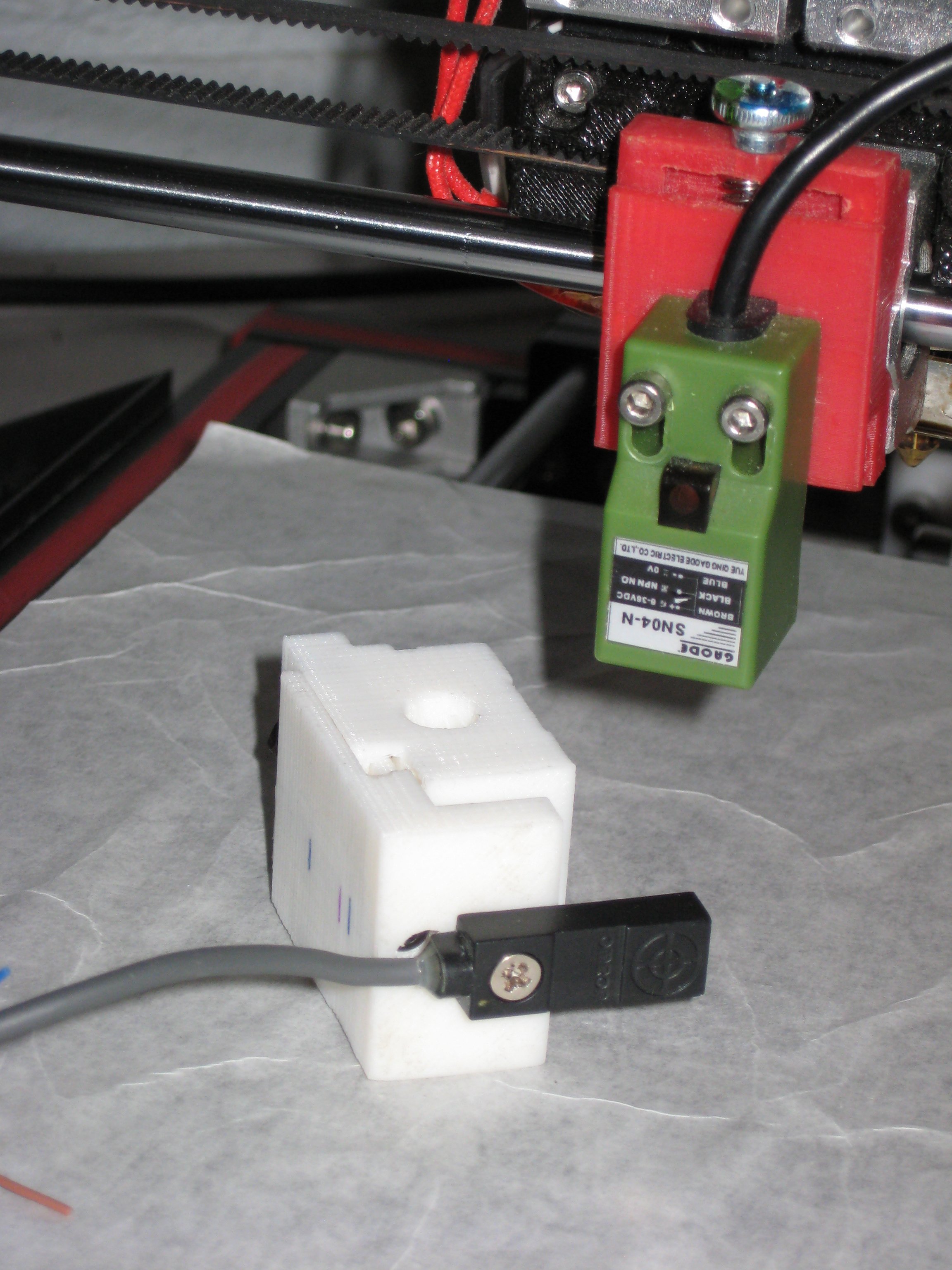

Using an adjustable Proximity sensor mount. I can set the height of the Sensor thereby adjusting the height of the nozzle to micro millimeters.

I have a different Sensor and A filament run-out sensor installed on mine. I am using the Low Profile sensor on a different slide mount than shown.

What do I have to change in the configuration.h file to switch from the inductive sensor (auto-bed leveling, etc) to the mechanical switch?
Re: So many issues...
If you are referring to SN04-N to end-stop, the SN04 acts like a No switch. don' believe there are any.
If there is it would be the line in red. Bed leveling will not work but does not need to be changed.
Soon you will be reinstalling the SN04-N on a slide switch.
