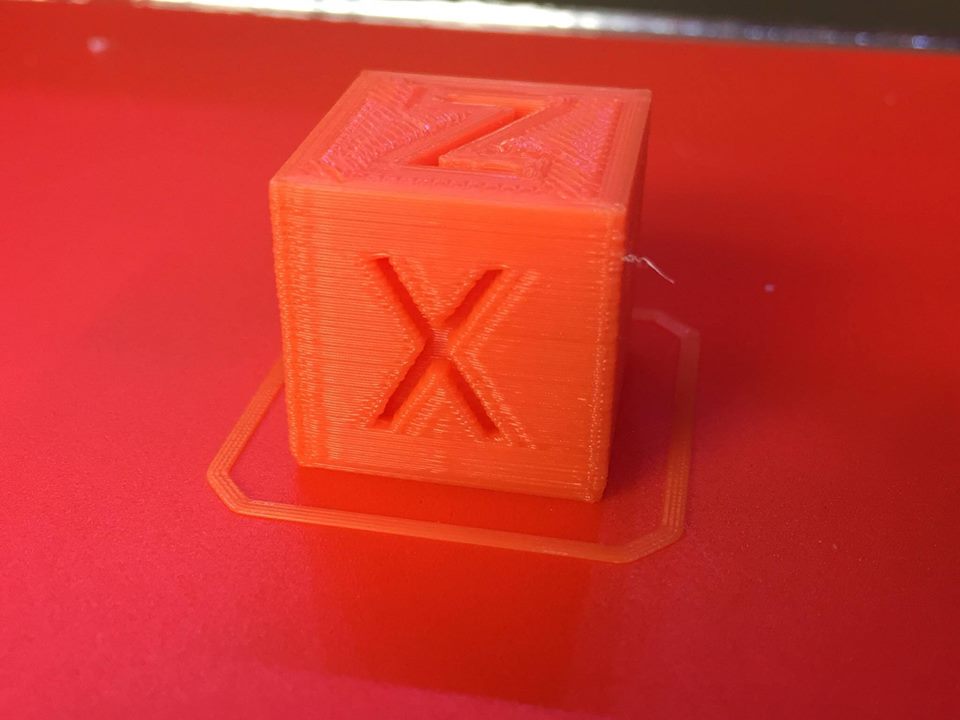

Still getting ringing....
Slowed down acceleration and xy jerk....and it's still there

Could be belt / pulley screw tension?
Maybe some other source of wiggle in the gantry?

It was actually the S3D profile! Made a new print profile and all the ringing went away
