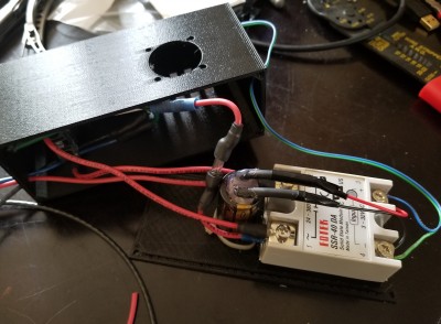

I have everything wired up, I just need to connect to the printer's power supply and test it.
I wound up designing my own, smaller enclosure, that includes a place to hold the capacitor securely, a 30x30 fan and vents. I decided to add the capacitor because if OctoPrint restarts for any reason (installing a new plugin, for example) it resets the ramps board which would cause the relay to unlatch and I'd have to push the start button again. Not a huge inconvenience but I wanted to make it as smooth as possible. I also added an inline fuse on the hot lead coming right from the mains power.
The cap is 10v, 22mF (millifarad) -- or 22000uF (microfarad) -- which should (in theory) give it 2-3 seconds of power to the 5v side of the relay to keep it latched during a reset.
Hopefully I get a chance to test it after work today. If all goes well I'll update and include a link to the capacitor I used.

It works! Have to hold the button down a few seconds to power up, but it stays on whenever OctoPrint reboots and when the ramps board resets, which is what I was going for. There's about a two second delay after sending M81 until it turns off because of the capacitor but that's no big deal.
