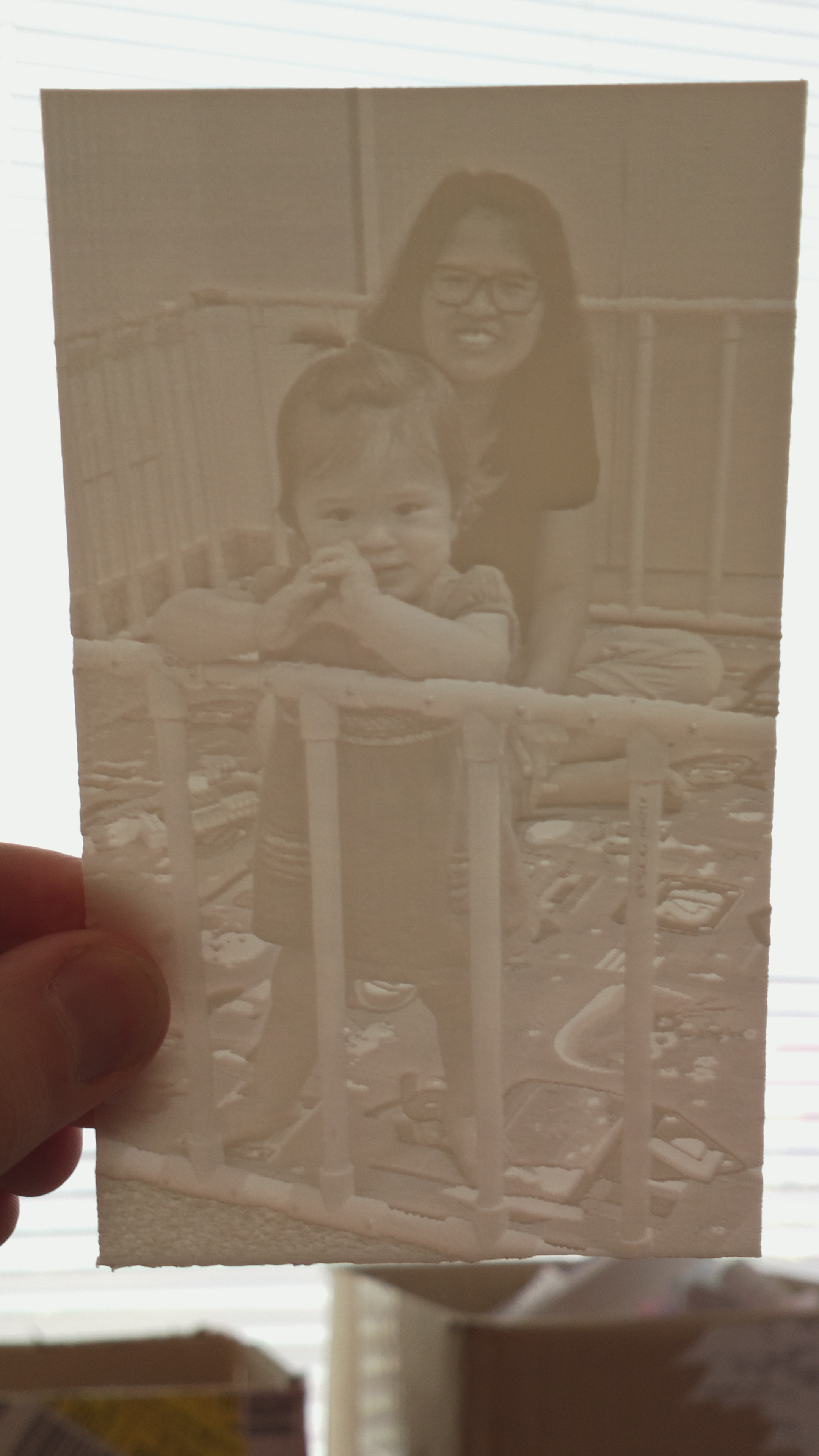

First Lithophane
First Lithophane
Turned out a little thick, but still looks good with backlight.

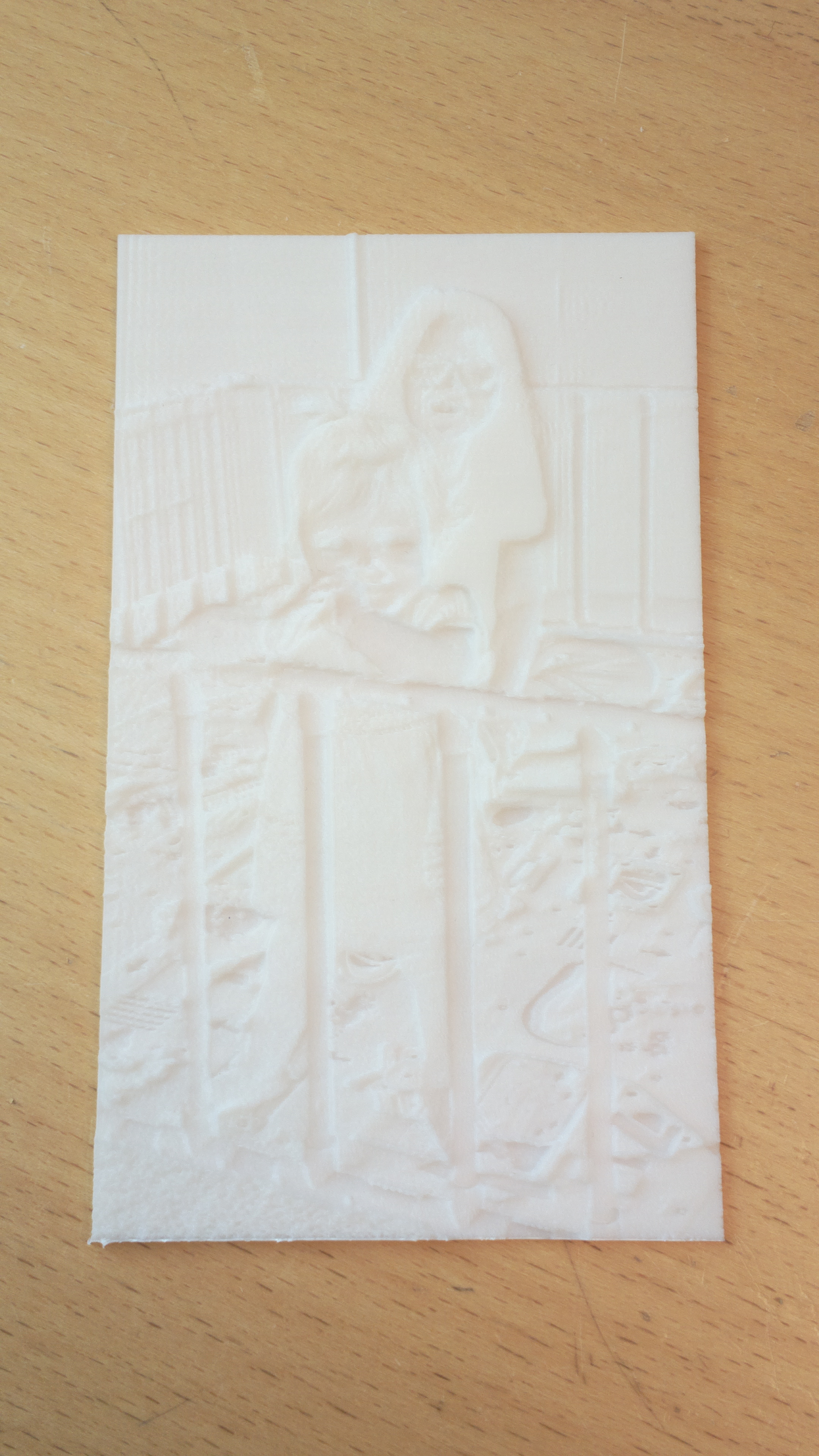

Original

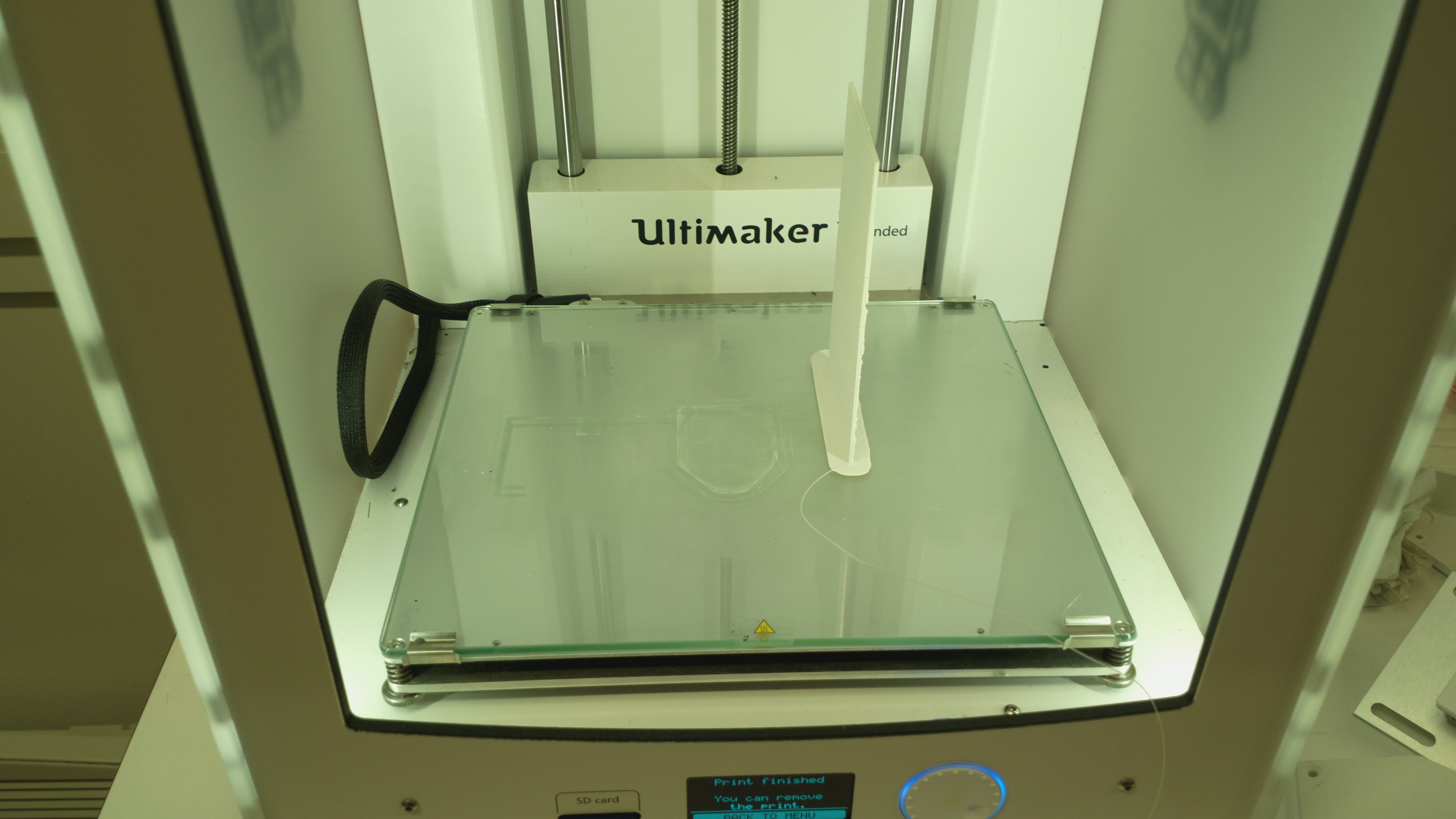

You are doing it wrong, print it standing on the long edge instead and you will get much better resolution!
You obviously need to use 100% infill.
White PLA works well, natural/translucent materials are too transparent.

Re: First Lithophane
On end, good tip. I do use 100% infill. I also need to adjust the thickness.
