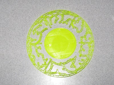

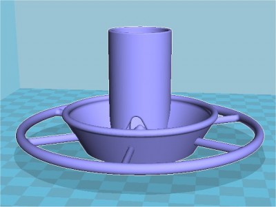

The First print I tried was a Pop Bottle Bird Feeder using the Tree Support. It starting looking strange so I stopped it to learn more about the setup.
It started printing what looks like a upside down tree branches on the hotbed trunks in the air. Trunks stopped at the Base where the Birds stand around the perch ring.

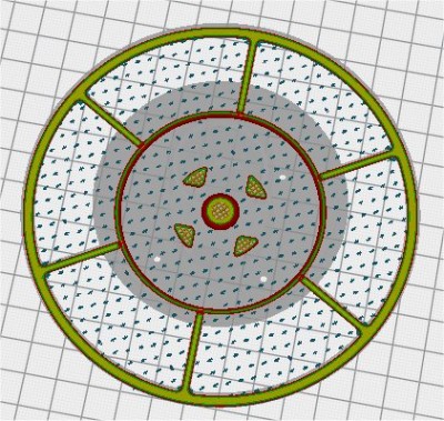

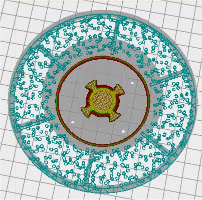

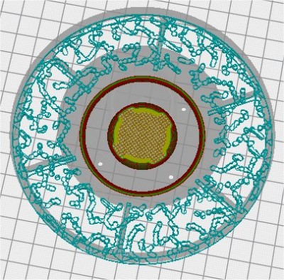

Layer10
Layer20
Layer33 Any way I am a little confused. I thought the Tree would work from the base to the Supported area branches on top.
So I will relook at my settings to see where the tree got inverted. And see why it is trying to support air.
I ran a repair on the Bird feeder STL with no luck, Tree support still upside down.
STL file was so large placed it in google Drive here is link
Layer10
Layer20

I printed the 2nd Model using the support Tree. And discovered the the trunks are big cypress trees and the branches are very tiny.
In fact some did not reach the surface area they were suppose to support, learning the support Tree will be an interesting learning experience.
