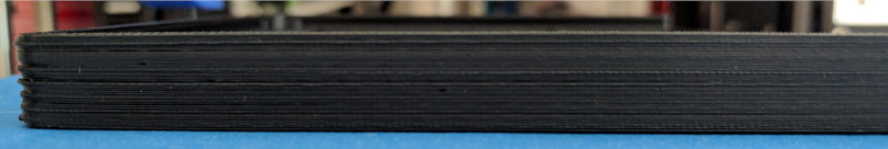

Hi folks. I could really use some help, as I'm at a loss on this one. Recently I started printing some storage containers for a board game and, initially, things were going fine. The last few sets of prints, however, have developed the 'wave' / ribbed pattern you can see in the pictures. I'm printing two of the containers at a time, 'stacked' along the Y axis.
It's most prominent at the ends of the Y-axis, but is also found on the X-axis.

First - Side view of one of the containers. The wavy / rib is most present near the part of the print towards 0 on the Y-axis and fades as it gets closer to the middle

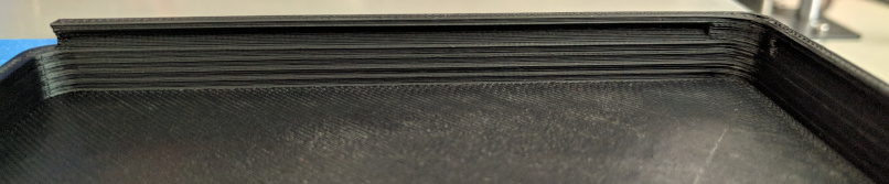

Second - side view of one of the container's inside.

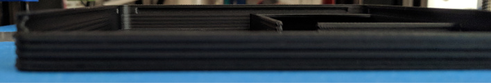

Third - top of the 'top' most print on the Y-axis. It's Y-axis bottom is fairly smooth

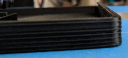

Fourth - bottom of the 'bottom' most print on the Y-axis. It's Y-axis top is mostly okay

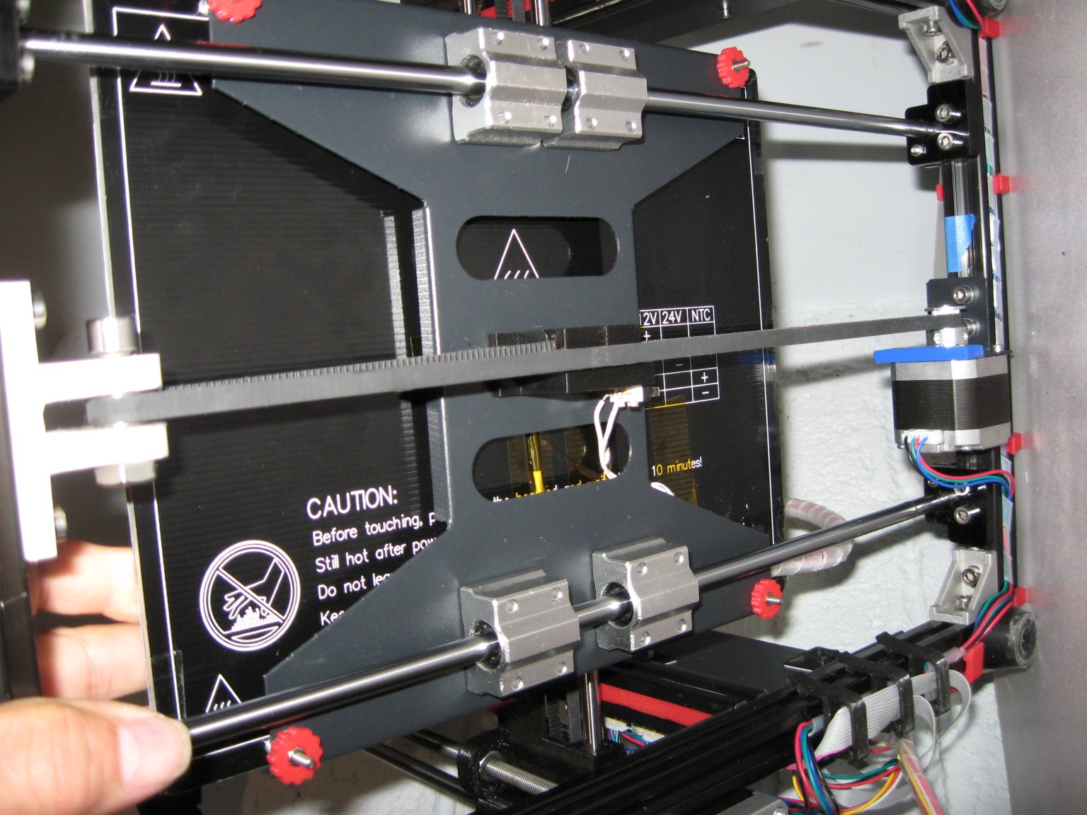

I had a small problem like this with by 3DP11 and 3DP12 solved by adding a 4th Bed Plate Bearing to both.
