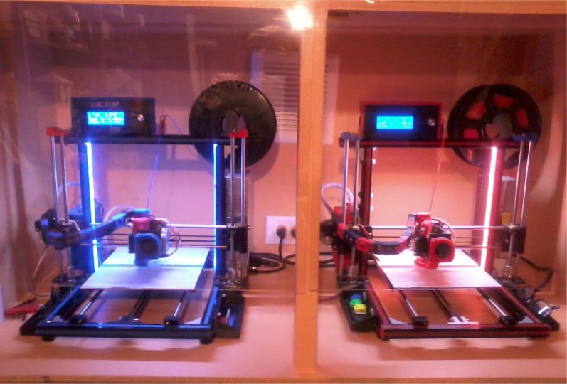

After printing the PLA at such high temperatures the room stunk of the fumes even with the vent fans running.
So I took my Ionic Breeze turned it on full, withing a few minutes the fumes were gone.
It sounded like a smoke eater as it cleaned the pollution out of the room.
This means my environmental 3D Printer enclosure leaks or not moving sufficient air to keep fumes from leaking into the room.
The design was fashioned like a dust free work station, where Air is blown into the case thru a filter to keep dust out the case.
Where in my design the air flows into the case from an opening that measures 4' wide by 6" high front/bottom into the case through
the case to the vent location top/rear and outside the house.
See in this picture
If someone can see a flaw in this design please post help full information.
Successful 1st ABS Print

I assembled the case from a sheet of particle board an a 2"x2" a 1/2"x 4" boards
Cutting the sheet of plywood into 5 pieces from the single 4X8 sheet.
1xBottom 24-5/8 X 48 x 5/8 inches
1xback 24 X 48 x 5/8 inches
1xTop 24-5/8 X 48 x 5/8 inches
2xSides 22-3/4 X 23-3/8 x 5/8 inches
I added a center brace 2" X 2" X 22-3/4" to fit the height
I added a top plate with a 1/2"x4" to fit across the top to mount hinges
All pieces were wood glued together.
Then I added two pieces of plastic 24" x 18" attached with two 24" hinges to the top plate.
Placing the Room fan in the back wall center top
Using a single dual plugin center bottom (" NOTE: upgraded to two dual plugin") wired separately to two 500 watt Battery backups.

Re: Successful 1st ABS Print
You mean ABS, right?Roberts_Clif wrote: ↑November 7th, 2018, 7:39 am After printing the PLA at such high temperatures the room stunk of the fumes even with the vent fans running.
Sounds like your exhaust is not properly filtered. There are plenty of DIY instructions available that can be modified for your useage. One I saw even uses an Arduino if you feel like getting really fancy.So I took my Ionic Breeze turned it on full, withing a few minutes the fumes were gone. It sounded like a smoke eater as it cleaned the pollution out of the room. This means my environmental 3D Printer enclosure leaks or not moving sufficient air to keep fumes from leaking into the room.
The design was fashioned like a dust free work station, where Air is blown into the case thru a filter to keep dust out the case. Where in my design the air flows into the case from an opening that measures 4' wide by 6" high front/bottom into the case through the case to the vent location top/rear and outside the house.
UPDATE:
I just noticed you are venting to the outside. Does your outside vent have a fan to help suck or are you relying on the intake fans to push it out? You want to have suction, not forced in. Being in a house with two large dogs, I fully understand the dust concern.
- Posts: 1384
No I forgot to remove the PLA before printing at ABS temps, And the fumes were not ABS just really strong fumes.
Remember not all PLA is not the Same, some cheaper brands are mixtures of cheaper materials.
I am using a bathroom vent fan on the back of the Enclosure and piping it to the Outside vent with flexible aluminum duct pipe.
It is highly possible it is leaking though I wrapped it with duct tape.
Oh!!!
Thanks for the Info.
