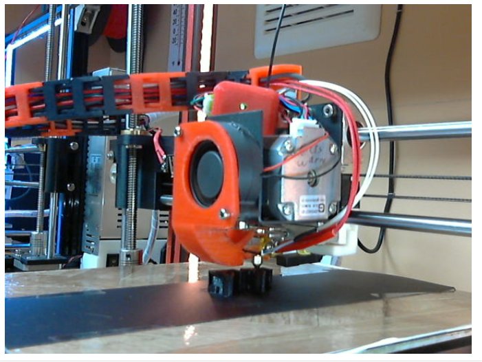

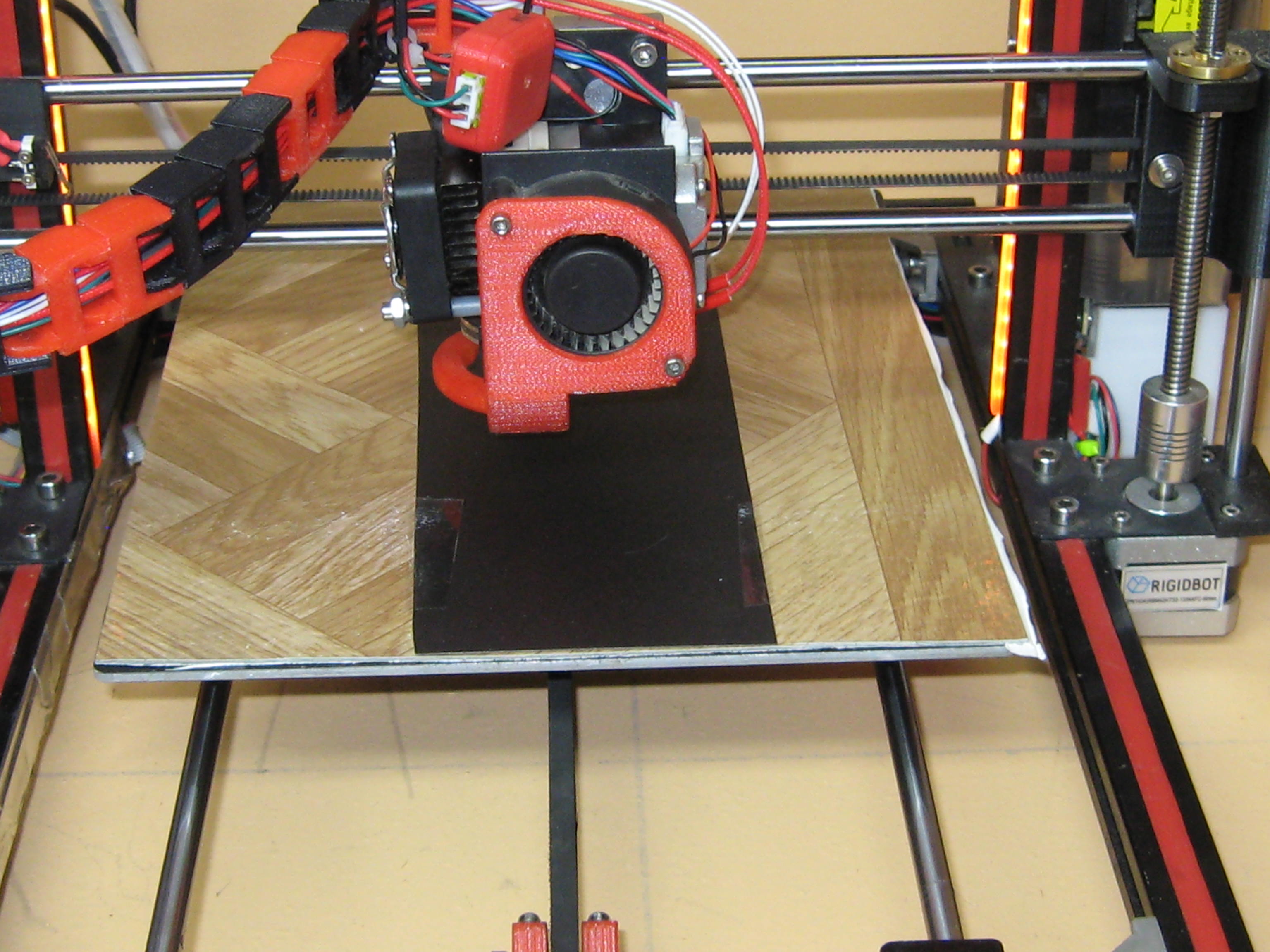

Taped Vinyl Flooring to the Bed, Taped Bed surface material to the Flooring.
Taped Aluminum Duct Tape to the Flooring. Removed the Aluminum Duct Tape. Now to Print.
