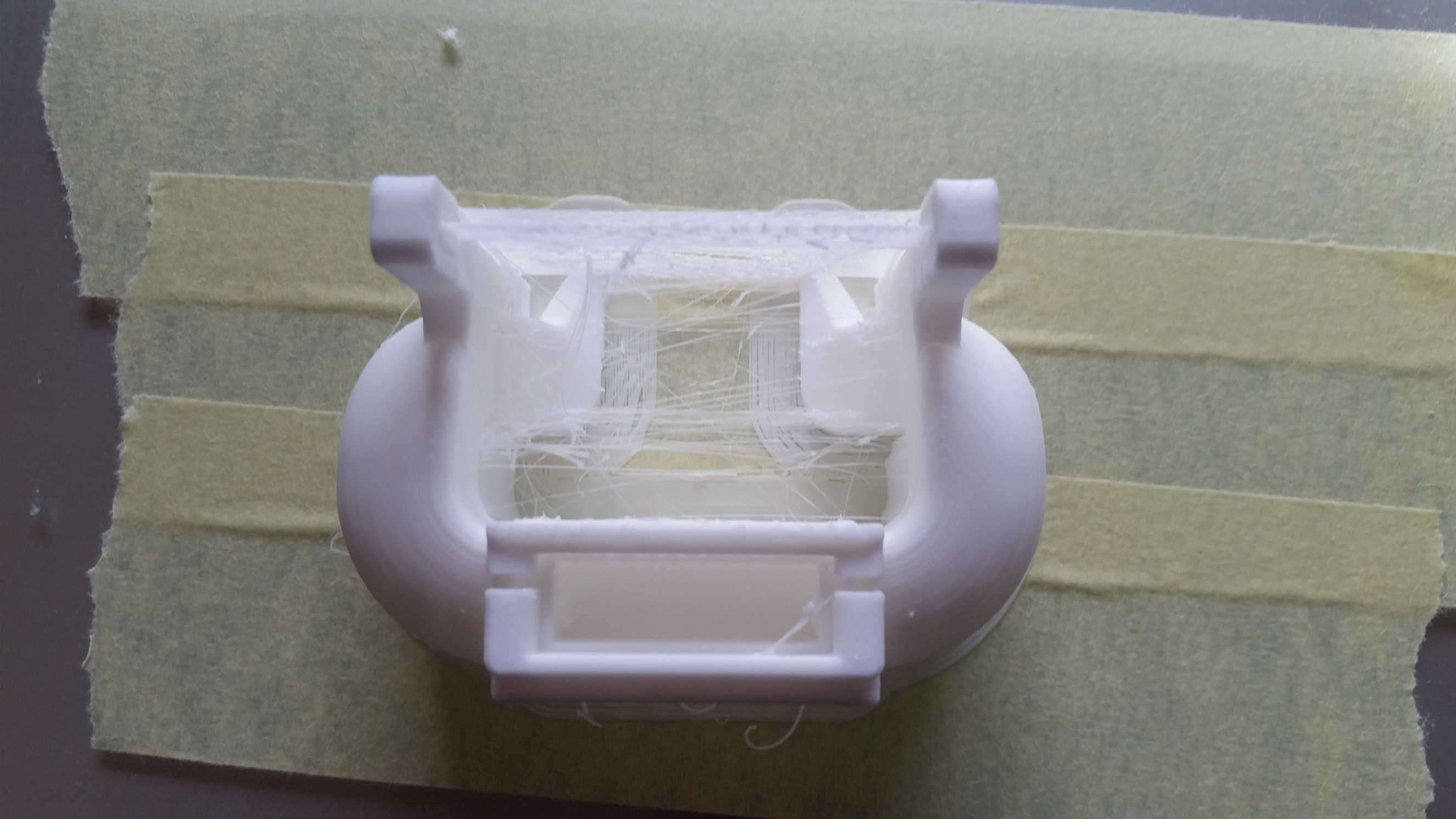

I've recently started printing with a CR-10S, and in general the prints come out well and after a little cleanup they look fine.
Still, I'm seeing some stringing and I'm wondering what the best way to minimize or eliminate it is. I've attached a few example pictures to show the problem. Again, the prints are coming out okay for the most part, but I'd like to get rid of the stringing.
I'm using Cura 3.6.0 with standard, out-of-the-box settings. The filament used is what came with the CR10 so I don't know how good it is. I have some Hatchbox and Amazon filament but haven't used any if it yet. Maybe the filament that came with the CR10 is of poor quality. (??)
Hmm, can't seem to upload more than one file (they're ~150Kb in size)
What are the typical causes of stringing, and what steps can I take to reduce or eliminate it?

First, if you havent already, do a PID autotune
Stringing is going to be one of two things...or a little of both...temperature or retraction.

Yeah wood filaments are notoriously stringy
As is PETG
Each filament does require some fine tuning.
As is PETG
