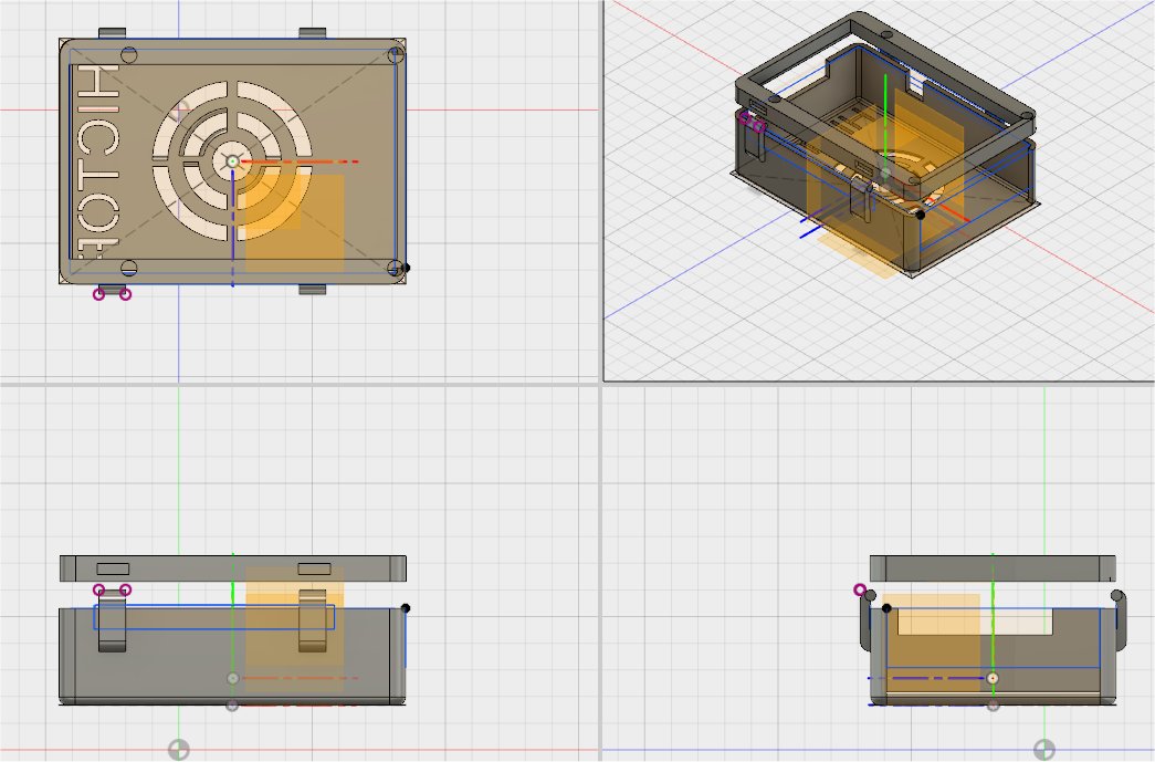

Example
I Posted this design for the Hictop Controller board.
We are here to help you with any 3D Printer problem.
You do not have to come with your problems though, You can post your Prints "Show off your Latest Print" OR "General 3D Printing Conversation".
You can Post your own latest designs and can even share your designs with the forum.
Example
