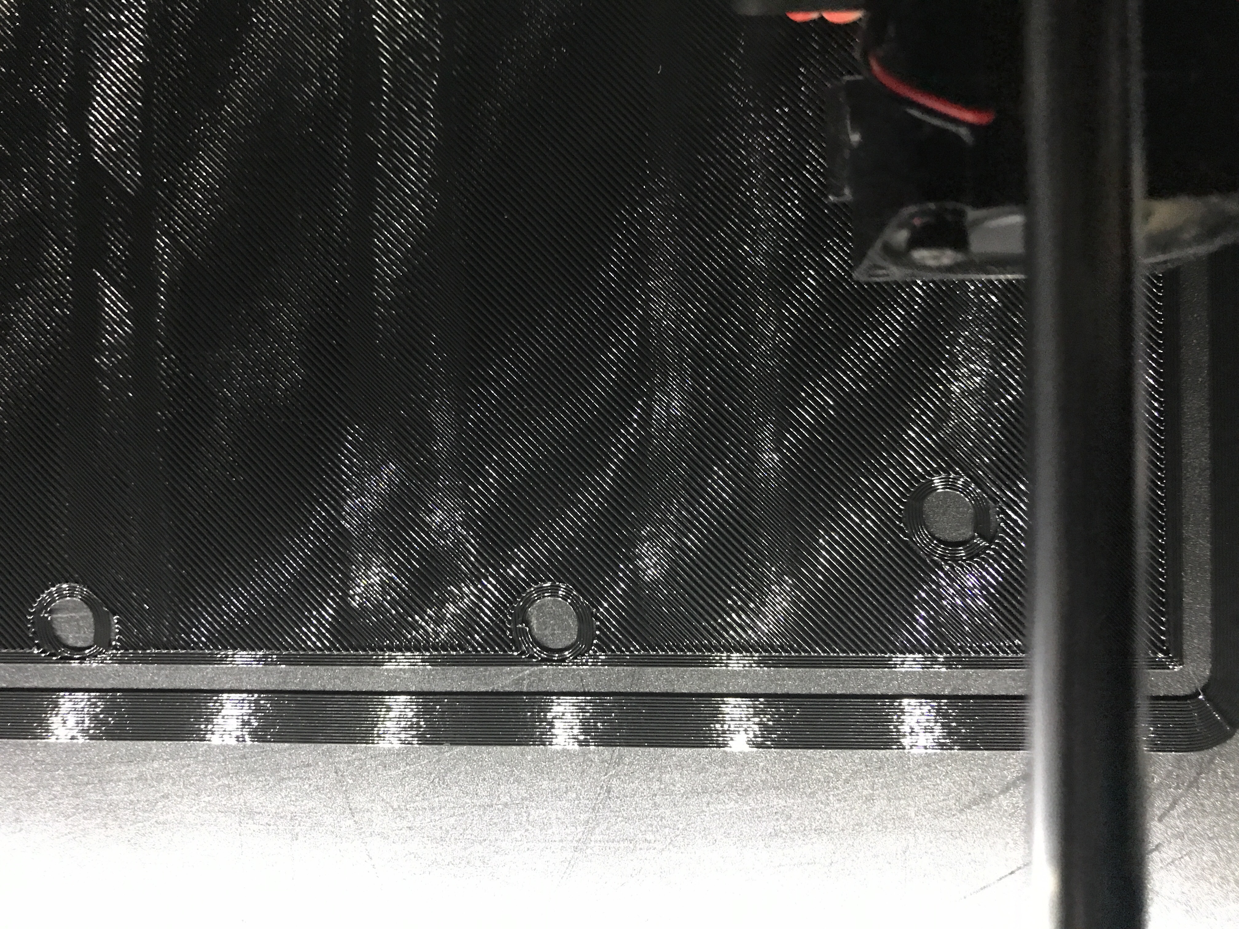

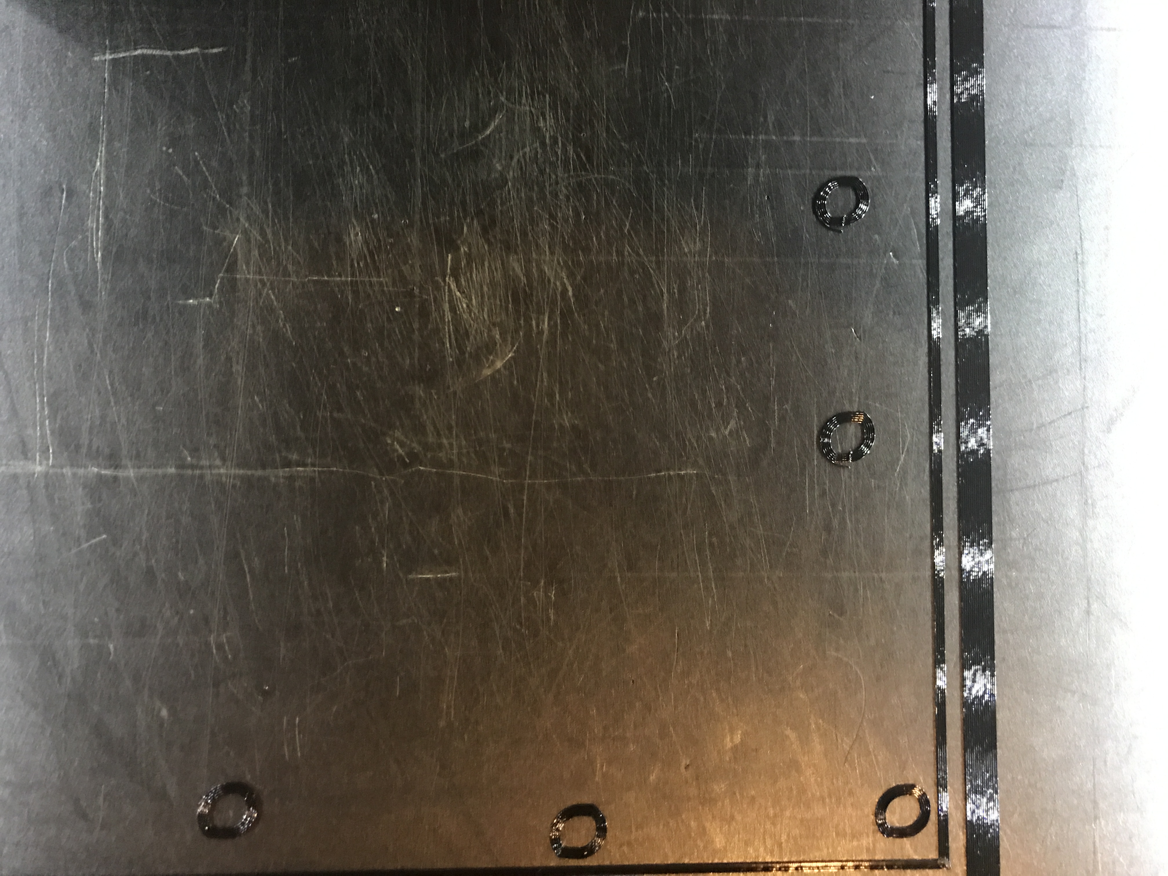

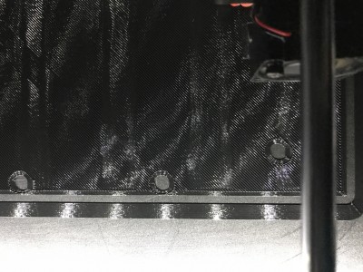

Please help anyone! Been using my raise 3D N2 dual printer now for about one year. Recently my prints have been suffering significantly. Printer won’t even draw a circle. They come out oval. I have tried everything tech support suggested with no results. Loosened almost every damn screw on this thing. Anyone else have any thoughts? Thanks in advance guys!

I cant tell if it is the X or Y axis dragging that out...how are the belts?

I would suggest the slicer, slicers do not slice circles they slice straight lines in facets or triangles to make a circle. If you use a Cad program to create your own models then I would suggest that you reduce the number of facets used to create holes or curves, as the slicers get confused and start combining them creating strange arcs.
Attached is a test STl file for printing holes.
Holes in MM demo.stl
(143.34 KiB) Downloaded 601 times
I suggest using the Holes in MM demo to calibrate your slicer or to test other slicers.
