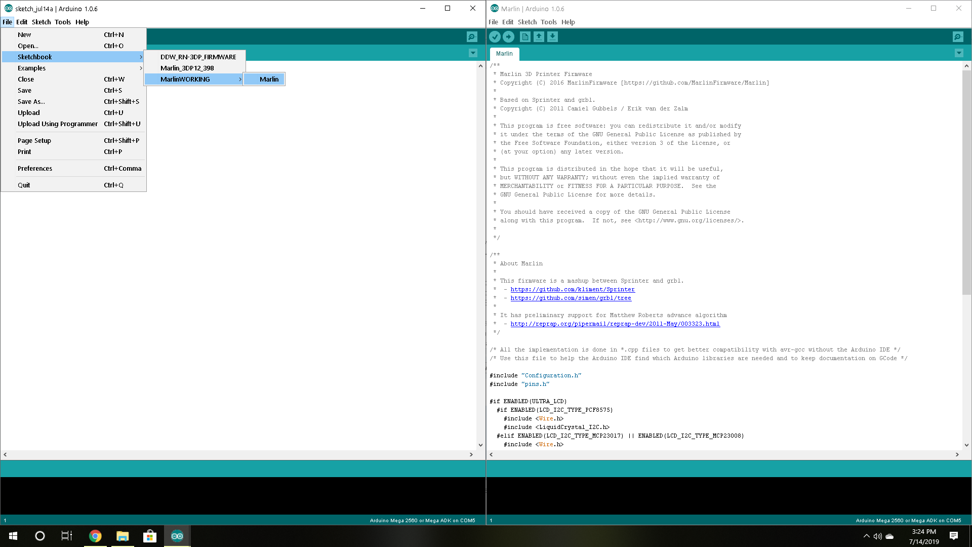

I downloaded the original Marlin-1.1.0-RC6 and copied all of the items from Chip Luck's firmware to the folder of the Marlin-1.1.0-RC6. I know very little about coding and after looking at all the tabs with things to change I easily get lost. I have been trying to figure it all out but its a little overwhelming as I didn't have to mess with any of this with the CTC 3D Printer, but am looking forward to learning. Why when I go to load a new sketch in the Arduino Sketches folder does it not show in the list? Also sometimes it will show the folder, then it will show Marlin (referring to the Marlin.ino file) but when I click on it only Marlin.ino opens in Arduino IDE. If I manually go to the folder it still only opens Marlin.ino instead of all of the sketch (therefor I cannot upload to my device since it is only showing one). I have tried multiple versions of Arduino IDE: 1.0.6, 1.6.8, and 1.8.9 all with the same issue. I have included an image of what I am seeing in the Arduino IDE interface

Well, your Marlin-1.1.9BF and Marlin 2.0 together seems to be exactly what I needed so far.. I just uploaded them in to the IDE, verified, then uploading after checking over everything. They have gotten me back to printing on this printer.. I will be doing some more research on the firmware to see what can be changed maybe reorganizing the Menu Tree to my wants. I just don't understand why I was having so many issues with others' updates or the IDE not recognizing them; but I guess I don't need to worry about it anymore. The bed leveling is awesome taking all of those points; does it save the leveling data on the board or should I just auto level each time before starting a print?
