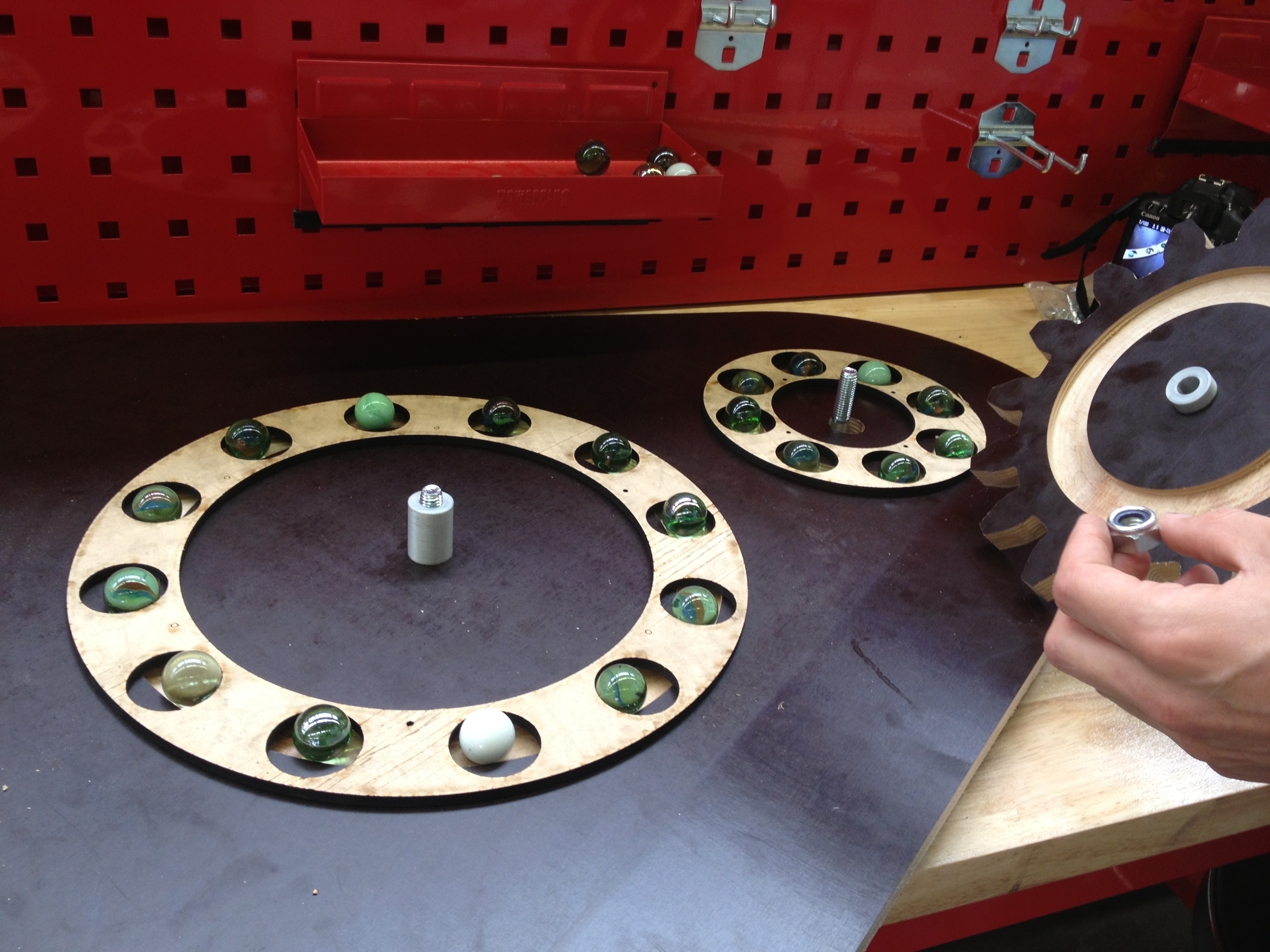

Re: Ultimaker Original+ Extended custom build at Stockholm Makerspace
Good idea...Meduza wrote: Yes, the printers are on lazy susans, it is a very convinient solution for easy access to the filament spool
... I see a direct application for my 'marble thrust bearings'
Nice...that design might come in handy some dayAmedee wrote:I see a direct application for my 'marble thrust bearings'

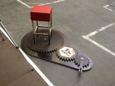

@amedee: like them!
here another 'lazy suzan' project with marbles: a platform to sit on for making 3d scans
