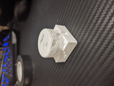

Hello strangers, I bought my first ever 3d printer 2 weeks ago. I bought a Creality Ender3 because it was recommended alot for beginners. As seen on the pictures it doesn't print uniformly. The first 2-3mm it prints perfectly but anything higher than that looks horrible. Being new and having no friends in the hobby I looked to the internet and tried everything I saw. Tried different extruder/print speeds but I just get the same result. Any help please? Thanks!

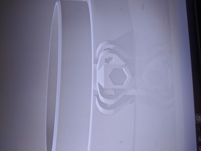

As for the file I used one of the test ones from Thingiverse.
https://www.thingiverse.com/thing:4584302

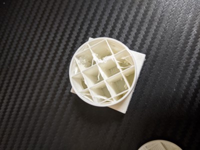

I used the 0.15mm settings for PLA you provided and it worked phenomenal except for the lower areas/upside down angles which are covered in globs of filament. I opened the top to see how the infill was and it did good. I decided to also test a slightly more complex part for further testing and apart from the globs on the bottom everything else was very fine. I can barely feel the grooves. Thank you for everything so far.
