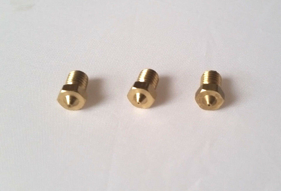

I purchased some E3D J-head structure, 1.75mm filament Nozzles 3pk for $6.36
If they last the same length of time as the ones I posted about then I will be happy.

That's a very good deal
