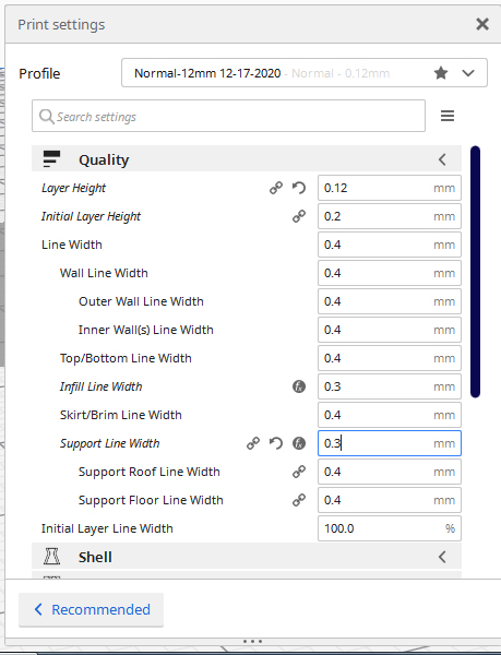

Thanks. I just gave this a try. Obviously it does show you what the setting are but a little hard to read. Good suggestion, though.
I put the page breaks in to try and sort it out a little...

Other option is to make screen shots and save. Cismontguy
- Posts: 1385
Re: Is there a way to print out Cura's setting under Profile?
The Screen shots are actually the best, it does take many screen shots sometimes.
