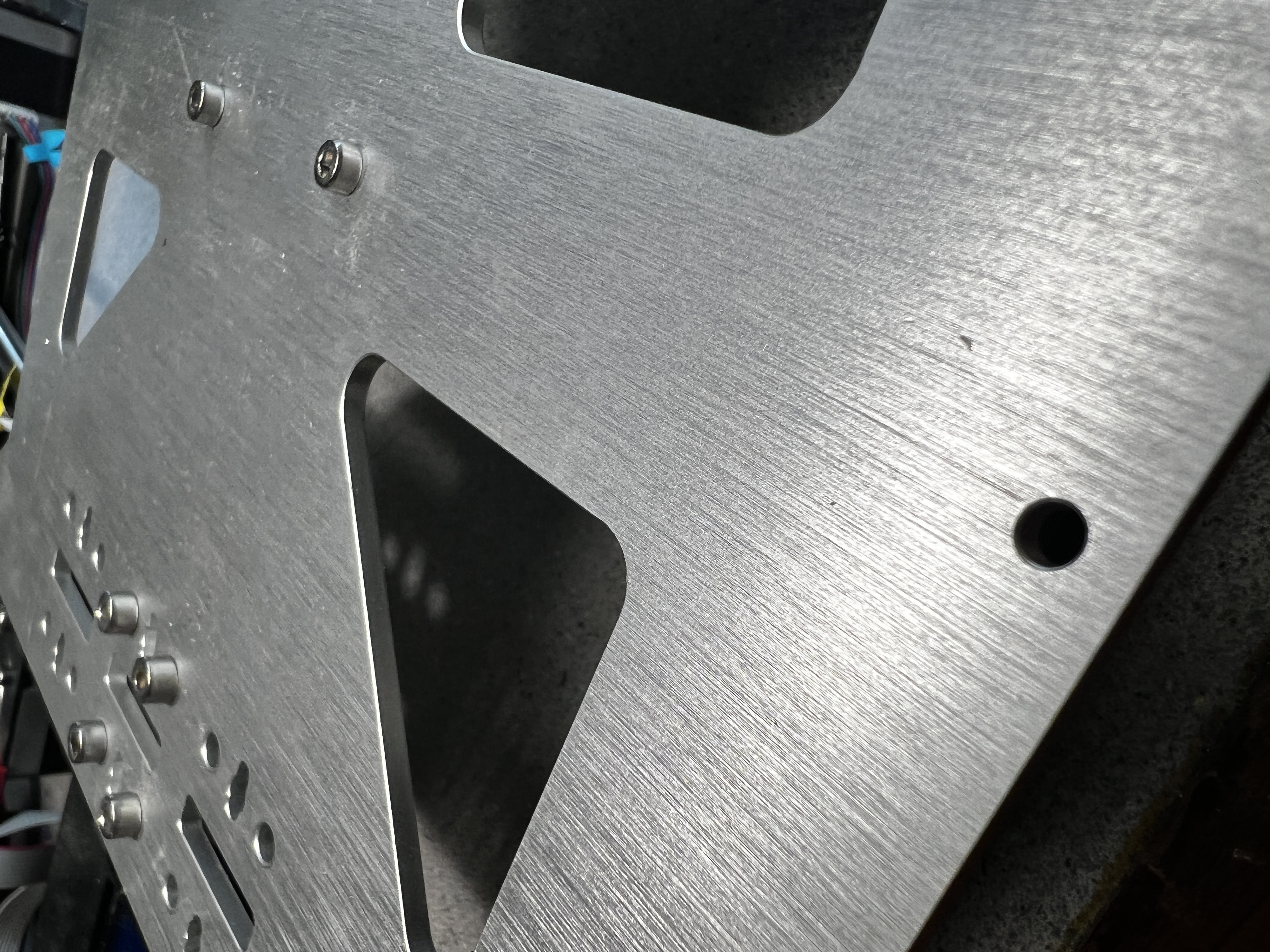

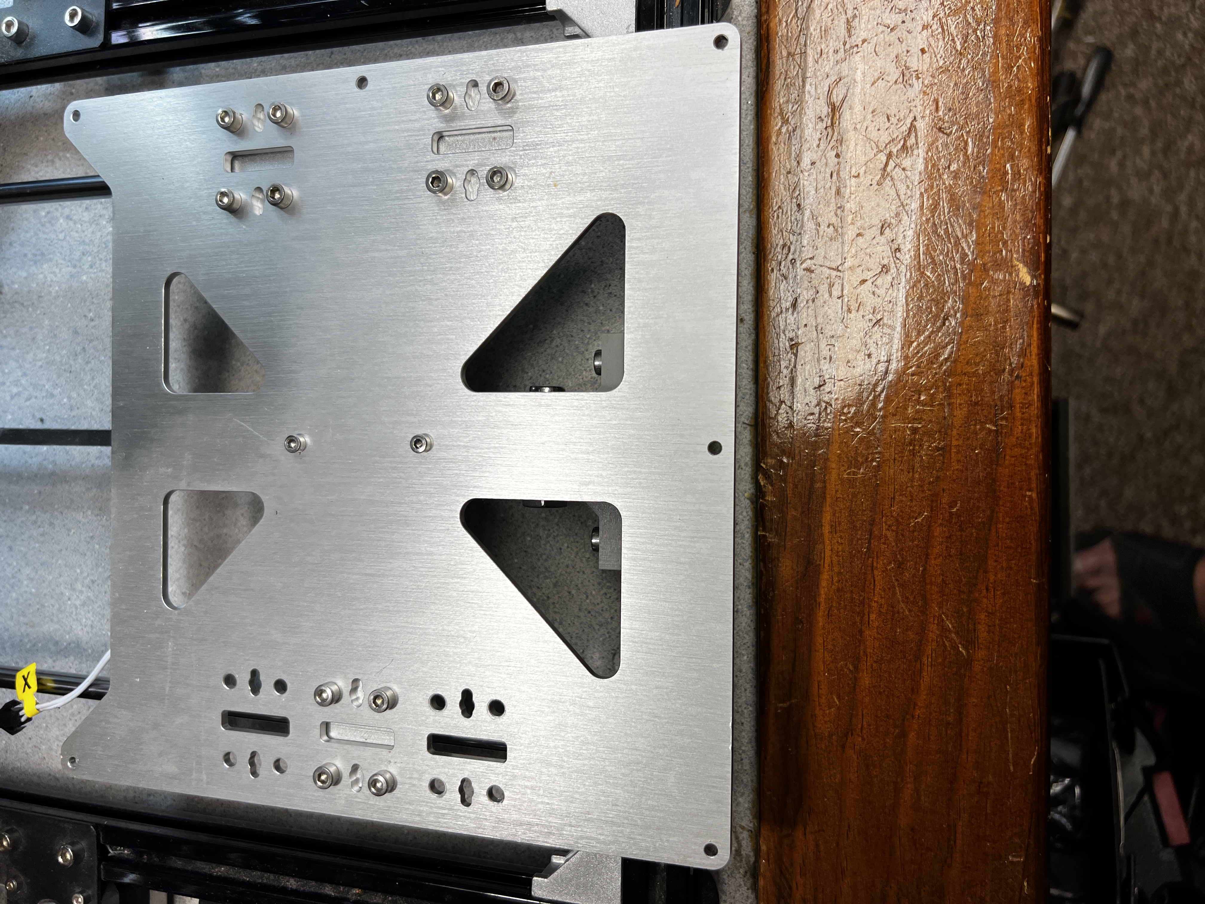

Would like to see your upgraded Base plate, please post more information.
I bought this from some retailer with Geeks in the name. I'll research that although you can likely acquire one of these anywhere. I bought this originally to add the 4th bearing block, and now it only has 3. I cant find the original frame at the moment, but this is a substantial upgrade.
