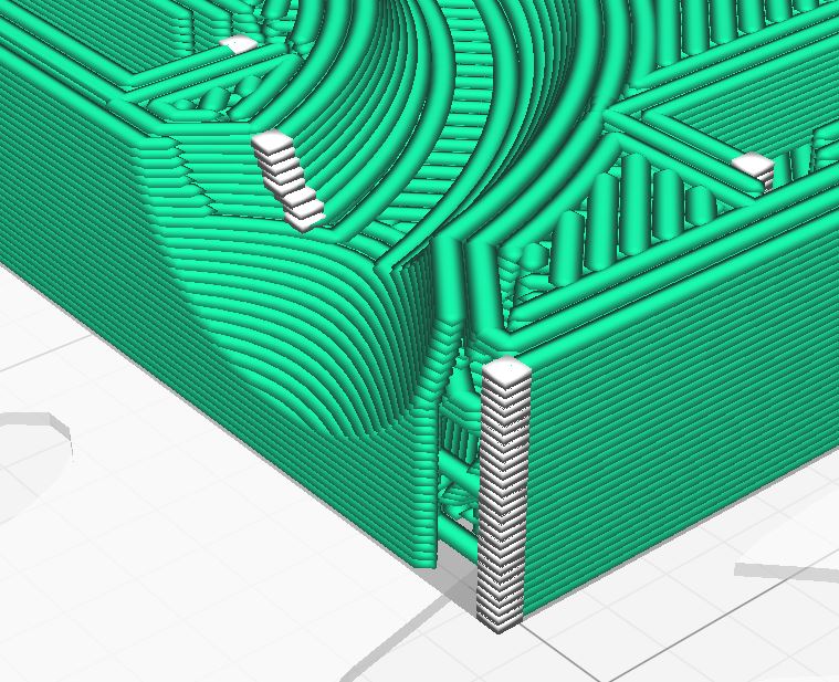

I tried hard to find a Solutionbut I dont know wich setting I have to tweak to get rid of the following Problem. At the End of each area of a layer the Extrusion stopps too early. I uploaded a picture of the Problem.

Check if you have Coasting enabled

I would also check to see if infill/perimeters overlap by 25%
