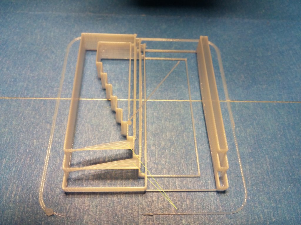

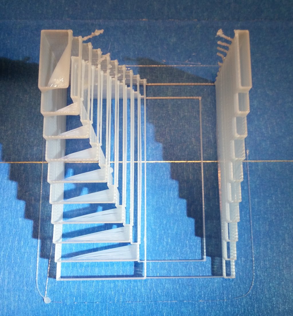

Was printing this 'ultimate extruder calibration' .stl to test some printer functions. It appeared to do fairly well for no calibrations on e-steps yet. However if you look at the left object and observe the strange twisting of the 2nd and 3rd step's of the object, the right side of the front vertical face is best I can describe is 'twisted'. The first step layer appears to be OK, so is the left side of each 'step'. I'm puzzled.
Link to .stl file here:
http://www.thingiverse.com/thing:9804
You can see some stringing between the two objects, and it gets worst toward the top.
Settings: Slic3r, layers 0.2, infill 0, perimeters 3, nozzle 205, bed 60/50, PLA batch 1

Backlash will not cause a miss-print. Look again at what it should have printed on the host, and the actual printed part. Think of 'stairs', the vertical walls on step 2 and step 3 on the left object are twisted and not vertical.Neotko wrote:Maybe it's backlast from the short belts?

I see now. The slicer prints in the air

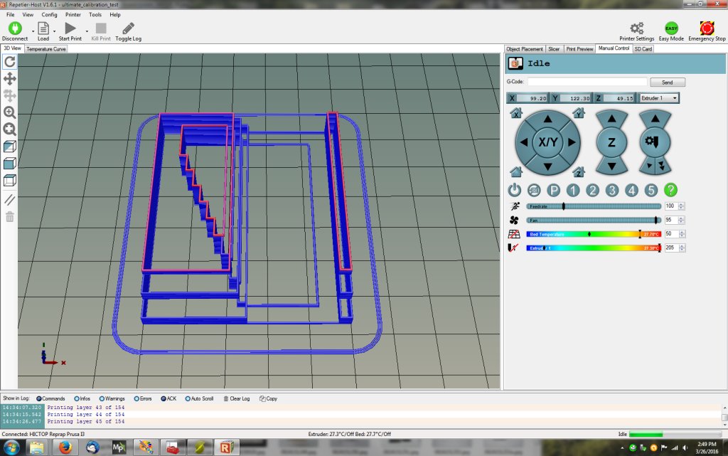

Yes, it will test and tax your printers bridging abilities and other print attributes. What host software are you using in the photo?
Re: Slicer issues?
Simplify3d

Ah!
Now I see what you are trying to print...
You are actually missing all the floors. The problem is your slicer (or the way it is setup for the bottom/top layers)
Re: Slicer issues?
Oh wow, you're right. I went to the Thingiverse link he gave and yes....there's quite a bit missing

Interestingly Cura default Prusa i3 settings worked and I'm pretty sure Slic3r was set for 3 top/bottom = now to debug Slic3r.
