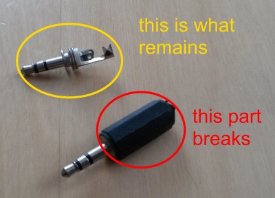

Threaded inserts will not work in this case I think:
I would like to create a spare part for the black cover.

I have one 3.5 jack plug under hand and it seems the same of yours shown on the pic you posted :?:
I print a test before share the files, I had just to screw easely with the the fingers.. :roll:
gudo
Posts: 108
Re: Identify a (non-metric?) thread
Post by gudo »
when seeing your pic, the thread of the metal part is very deformed, may be the problem is here !?
