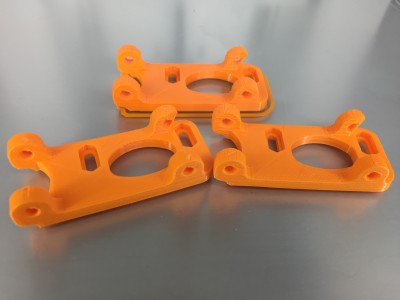

The infill overlap is a bit too high.
What orange spot?
Tweak this?

In the previews
Re: Tweak this?
The legend says is 'infill' and by the looks it seems infill from layers below. Try to inspect the gcode for that kind of things layer by layer. There's a button to see just current layer selected on the slider.

Do you mean the Outline Overlap, in the Infill tab?Neotko wrote:The infill overlap is a bit too high.
What orange spot?
Re: Tweak this?
Yea

Been reading this...
https://forum.simplify3d.com/viewtopic.php?t=1953
Going to lower to 27% and do a test print That finish could be better
Re: Tweak this?
Indeed. As I said the 3 thinks at the same time...
Also yea 25 is more than ok for almost anything.

Tried a different small part
Back, with 25%. Right with 20%
Left is Cura default
- Posts: 4077
Re: Tweak this?
If you click the photo and zoom in, note the S3D pieces (back and right)....note the sides of the part, especially where the hole mounts are
