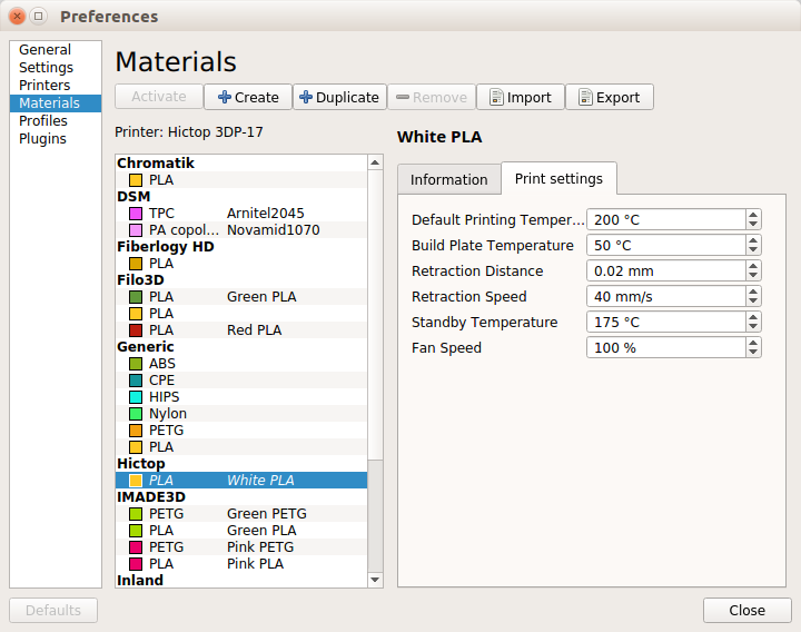

I have all of my filaments entered into Cura. A few of them have my own print calibration settings as well (I have been lazy and haven't run a calibration on each spool).
In Cura 2.6, open the Preferences interface and select the Materials tab. From there, you can either create new or duplicate existing entries with various parameters like diameter, cost, density, and even print settings like temp, bed temp, retraction speed, etc.

GrueMaster wrote: June 27th, 2017, 2:13 am I have all of my filaments entered into Cura. A few of them have my own print calibration settings as well (I have been lazy and haven't run a calibration on each spool).
This is great, I didn't know you could do this now!
