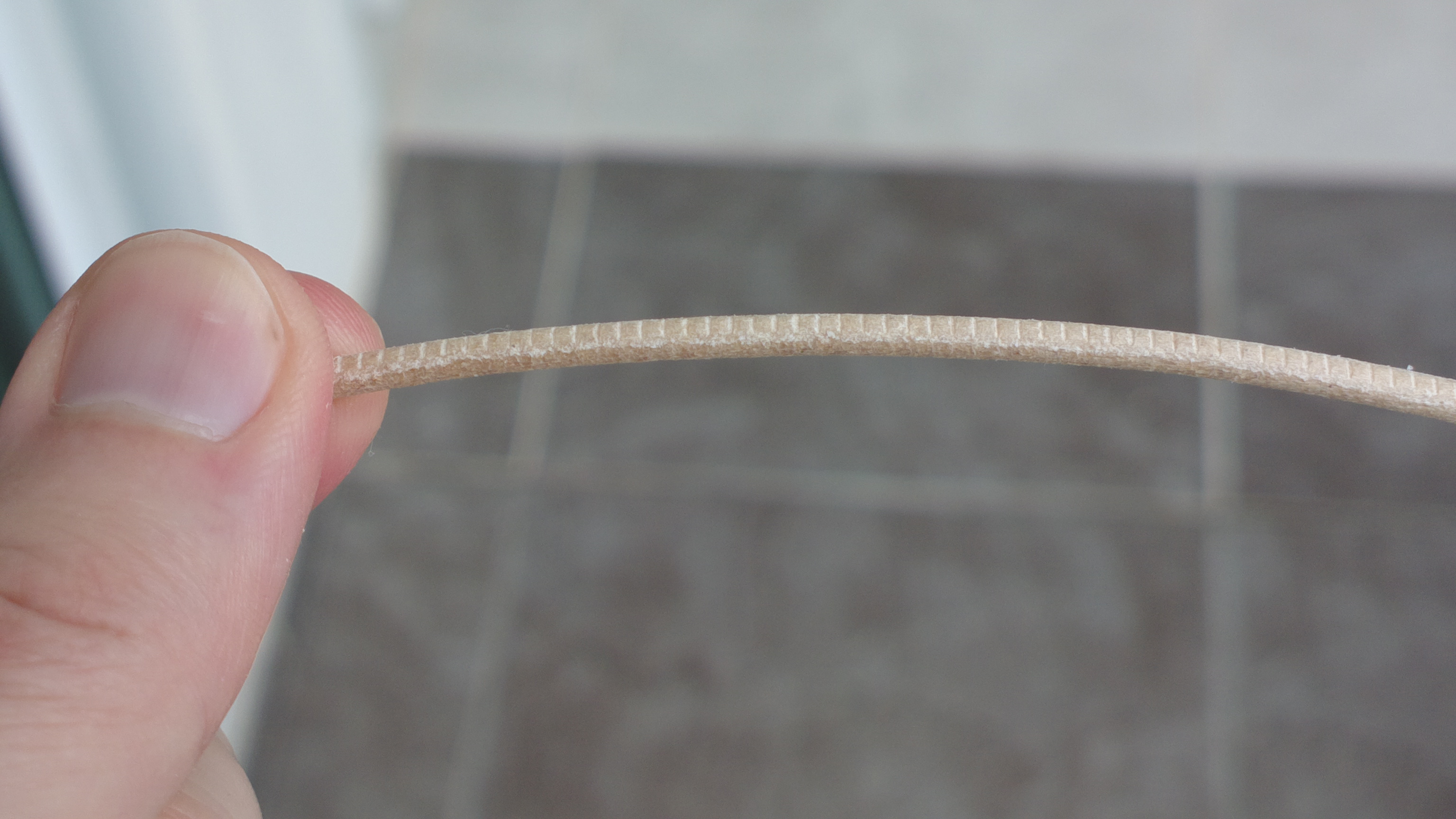

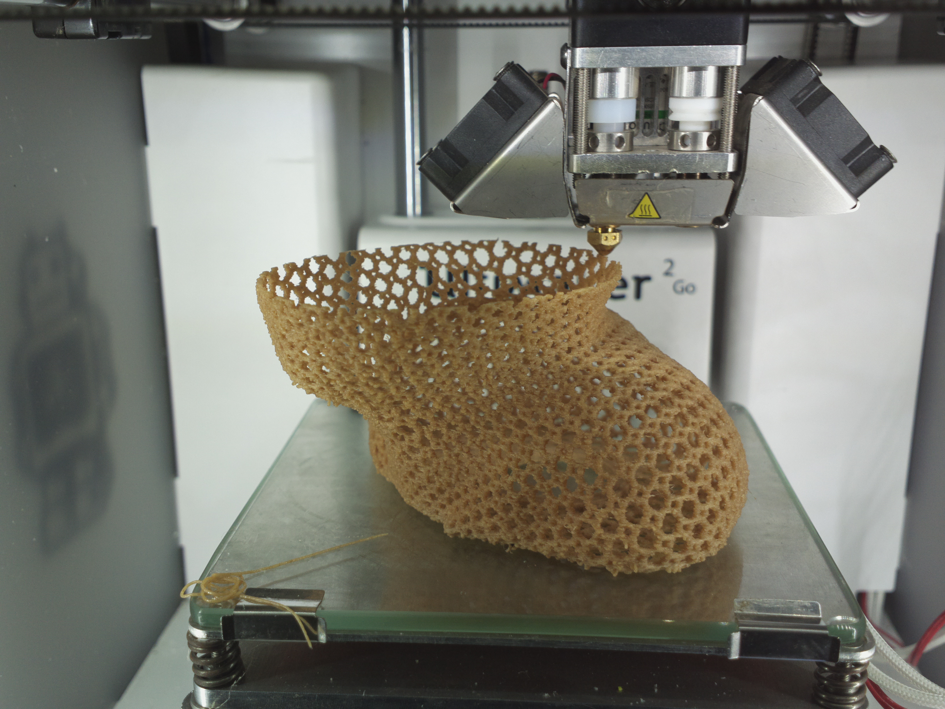

Who said Woodfill can't handle retractions?
The only modifications I have done is a different feeder gear and another type of spring in the original UM2 feeder.
Ambient temperature is 30 C and I am using a 0.6 mm nozzle. (0.4 mm nozzle just does not work with this spool of woodfill)

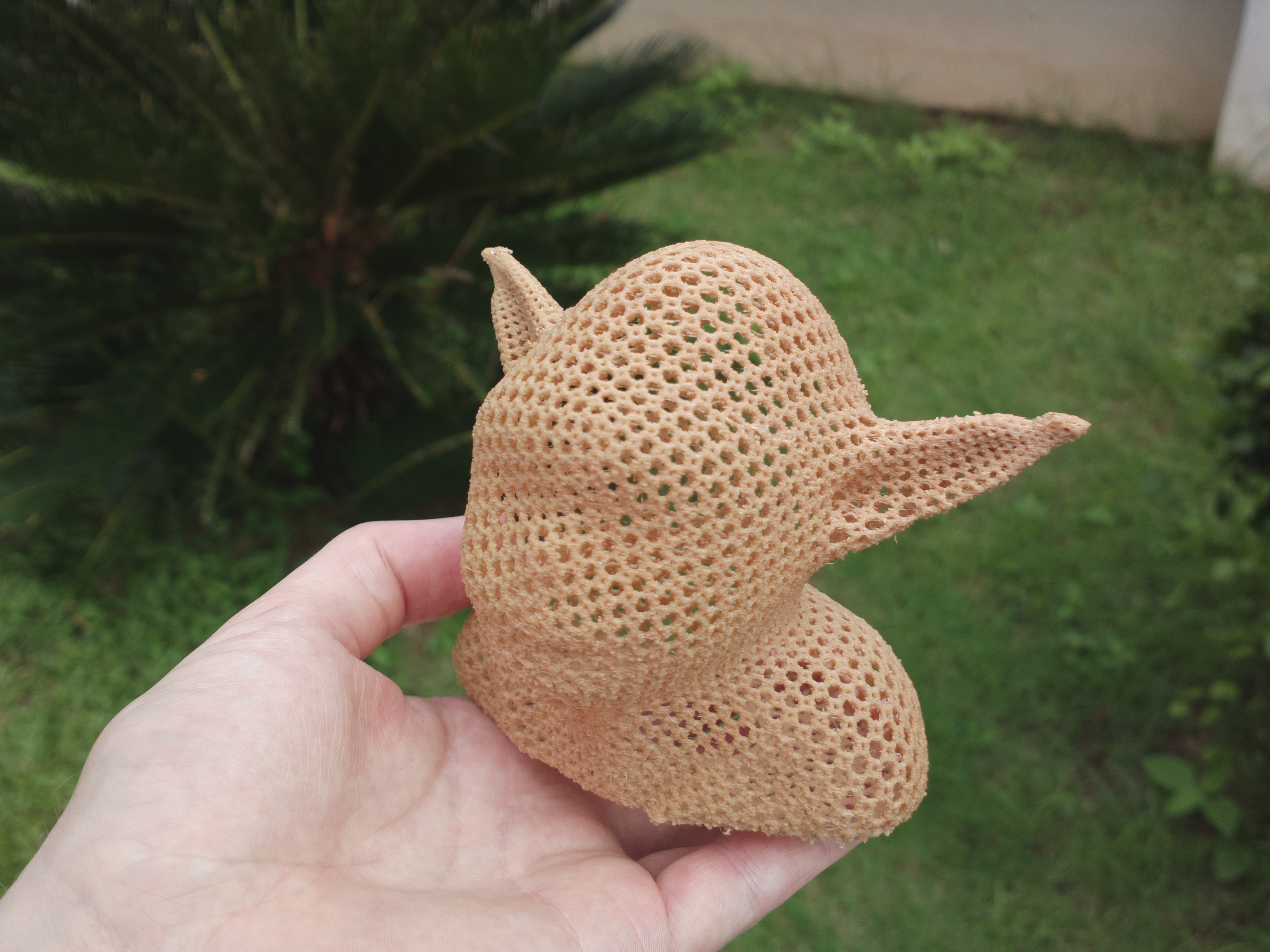

@Anders Olsson what make of Woodfill are you using?
I did struggle with Kai Pathy's wood fill although he did recommend a miniumum of 0.5mm nozzle, the modified Robert's feeder would grind the filament or deformed it as it was softer. although when I upgraded to the bondtech feeder it had enough pressure to be able to feed it without problems using the 0.4mm, and handle retractions too.
It's looking a nice model, I like that type of filigree and it looks great on Yoda.
The texture looks almost like yarn or bundling twine. Very interesting. I'd like to see the finished product after you do any post-printing processes to it (stain, finish, etc).

I think we all missed something very important in his picture....tell us about that second nozzle assembly on the right?
It is a very old spool of Colorfabb Woodfill, one of the first one they sold I believe.Izzy wrote: ↑June 18th, 2017, 2:48 pm @Anders Olsson what make of Woodfill are you using?
I can't make it work with a 0.4 nozzle, it just clogs whatever I do. It works fine with the 0.6 nozzle though.
The fibers in this particular batch are probably a bit larger than in more recent woodfill filaments, I recall reading something about that long long time ago.
The model is this one: https://www.youmagine.com/designs/oh-no ... y-dizingof

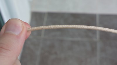

Had to scale it to 70% and rotate it to fit it in the UM2 Go, here it how it looked when it was finished: And this is how the filament looked after all those retractions:
My UM2 Go is fully equipped with heated bed and a 1.75 mm hotend at the second position.
I have used the second position for testing my direct feeder, however that does not work as well with the new feeder gear design.
Haven't had time to work more on that though.

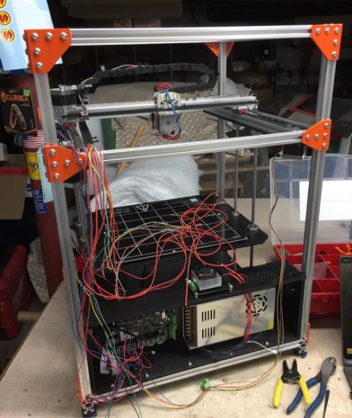

That's a nice result, I've been meaning to try a wood filament but been busy doing the wiring portion of my FT-5 build.
So. Many. Wires.

Next few steps are stepper voltage settings, uploading firmware, seeing if the motors and extruder works, PID calibration...it's marketed as a kit that is "easy to do" but I'd say it's for advanced users. Once you include the terrible instruction manual, I can understand now why their Facebook group is full of people stuck on every step of the build.

The kind of instructions that just says "make sure to square out the frame" but no tools or tips on how to get that done?
I tried making a squared out aluminum extrusion frame twice. I failed twice. Aluminum extrusion frames suck
