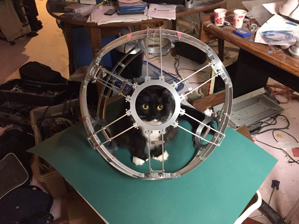

Molly feels the BB-8 frame is a toy for her to play with

I think Molly wants her own hamster ball
