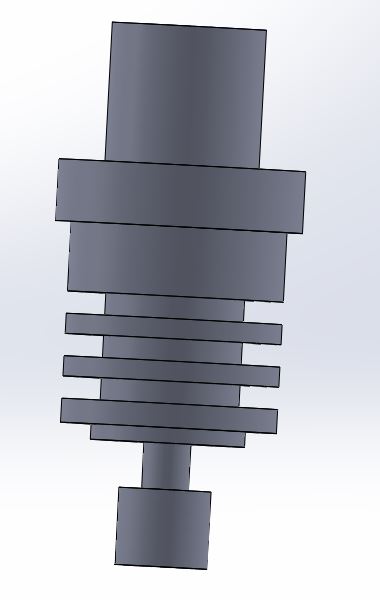

PS: I hate those drawings released by Ultimaker - those are so unusefull for machining - no tolerances, no propper measures,...
- drayson
- Posts: 254
- Location: Graz, Austria
Re: UM2 print head project

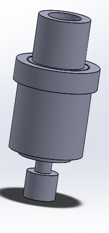

Made a quick sketch how the part could look like... see attched...
Dimensions of
- raw material: diameter 20mm, lenght 40mm, but could be less depending on the skills of the machinist
- machined: diameter 16mm, lenght 35mm
Please note that the lower part has a M6 thread... @gudo: is this possible to be machined with this material??
Would be a 1:1 replacement of 3 parts V2 with cooling ribs...
Nice!
Not sure though that suppressing the brass pipe is a good idea as it it an heat break. Also you would have to screw the nozzle against the PBI each time you change the nozzle...
And it is probably easier to tap a thread inside the PBI than machine one outside
(I am NOT a specialist in thermal conductivity, so this is just gut feeling)
