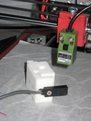

Here's what I have done with the original sensor
It works to make it like a magnetic Z stop then I level the bed manually and it works perfectly.

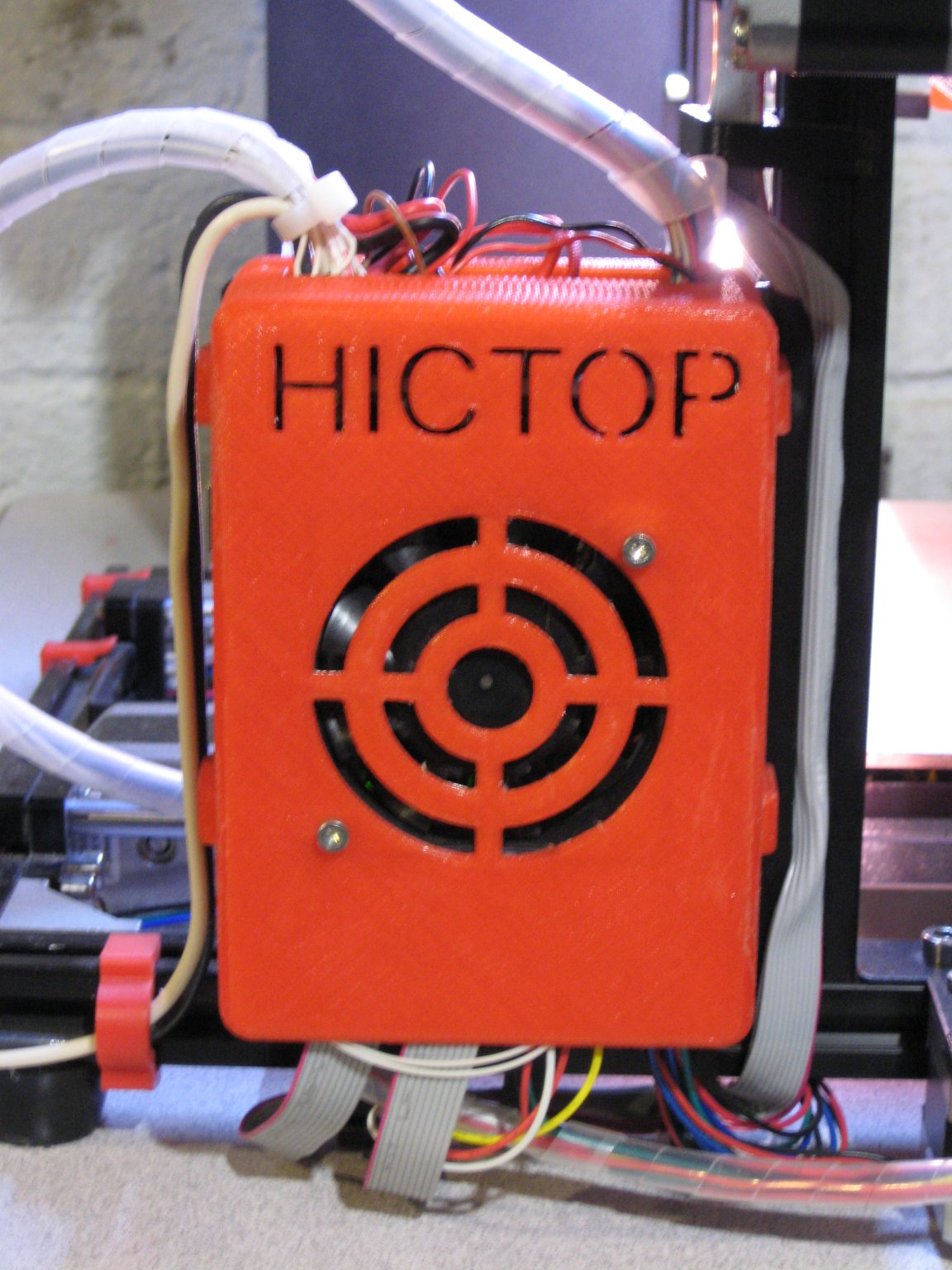

The Twins I designed the Controller Case with Fusion 360 Free and posted on this forum for FREE.
The LCD controller case was found on thingiverse.

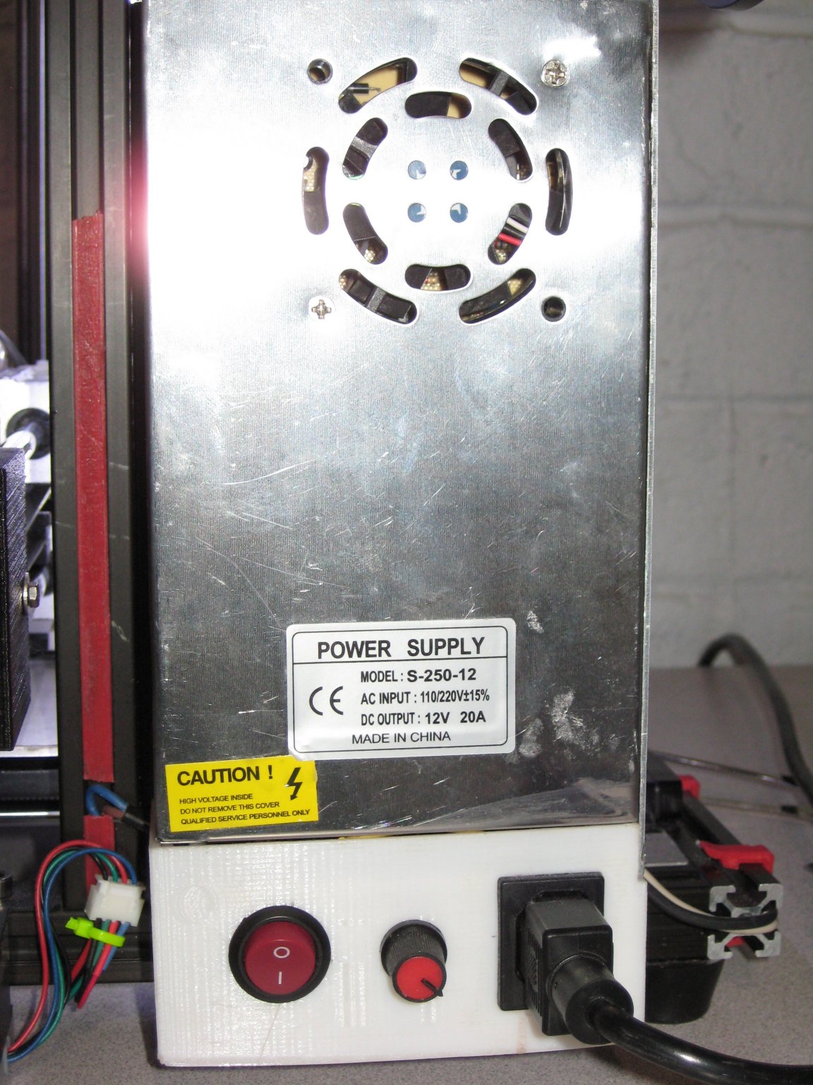

Designed the Filament run-out Sensor, the Parts Cooling Duct and the Power Supplies Case Covers all post on the forum.

My First 3D Printer came with a end-stop switch for the Z-Axis I added the SN04-N Proximity Sensor.
It had no automatic bed leveling, when I came across the Marlin 1.1.x with Automatic bed leveling I flashed the new firm.
Can not tell you how well the Original Hictop firmware worked never had it very long an what I had did not support auto bed leveling.
I had the SN04-N for almost 1 year before updating to the Omron TL-W3MC2, never had any problems with it over the Aluminum build plate.
Well back up a little: I did not like the position 65mm behind the X-Axis smooth rod sit was so far from the nozzle to get a accurate bed leveling.
So I purchased the Omron TL-W3MC2 to get the Sensor within 15mm of the Nozzle, however I changed the design to 25mm directly behind the nozzle.

Stock Proximity sensor is in original location config settings with SN04-N
#define X_PROBE_OFFSET_FROM_EXTRUDER 10 // X offset: -left +right [of the nozzle]
#define Y_PROBE_OFFSET_FROM_EXTRUDER 63 // Y offset: -front +behind [the nozzle]
#define Z_PROBE_OFFSET_FROM_EXTRUDER -.5 // Z offset: -below +above [the nozzle]
#define ABL_GRID_MAX_POINTS_X 5
#define ABL_GRID_MAX_POINTS_Y 6
#define LEFT_PROBE_BED_POSITION 10
#define RIGHT_PROBE_BED_POSITION 215
#define FRONT_PROBE_BED_POSITION 63
#define BACK_PROBE_BED_POSITION 268
#define MIN_PROBE_EDGE 10
