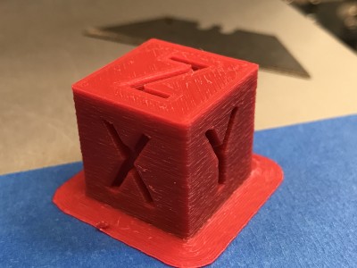

This is curious to me. Is there a file for a part to replace these? What are some of the symptoms of this condition?Roberts_Clif wrote: ↑December 30th, 2018, 10:00 pm The metal brackets that hold the Z steppers are too thin and allow movement in the smooth rods.
Even after bearing change and anti-backlash nuts installed, I am getting very fine variations is the layers. Almost like I am using Curas Fuzzy Skin on a VERY low setting. I will try and take a picture of the result of my latest calibration cube printed in ABS.

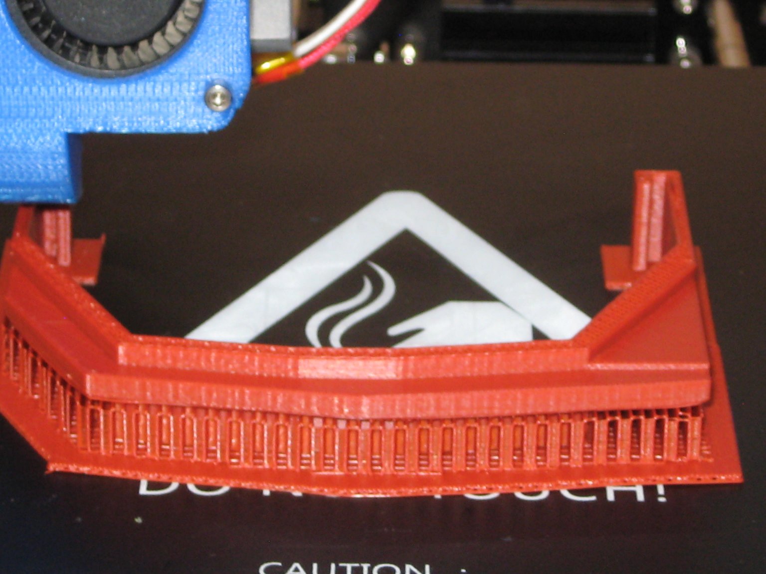

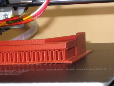

ABS Gutter clamp designed by myself Printed at Nozzle 228C - Bed 96C at 72% print Speed

Re: Extruder wont extrude Hitop 3DP12
It would appear that we are, did not take time to note this at the time of my Post.
Though it does print quite well, you can see even with all my 3D Printing that this model was attempting to warp from the bed.
I was not using any ABS juice and choice to print on This cheap 3D Printer Bed Surface.
3 PCS HICTOP 3D Printer Build Surface Build Sheets Heated Bed Cover Black
p.s.s Not promoting this product Just saying it worked for my 3D Printers environment.
Whoever said cheap is no-good is incorrectly stating that expensive is good. I had an Expensive Bed Surface and could not get anything to stick...

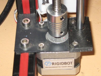

They are simple to install.
They have a tapered hole that allow you to loosen the two outside Z-Axis stepper screws place the mount and reapply the screws.
This will hold the Smooth rod with a lot better support. Seen in the attached photo
It Does, and I have and ideal to how to get this transfusion.
You will also see I have replaced the Z-Stepper motors with these rididBot Steppers, the originals still function.
I only wanted some spares and never put the originals back on...
