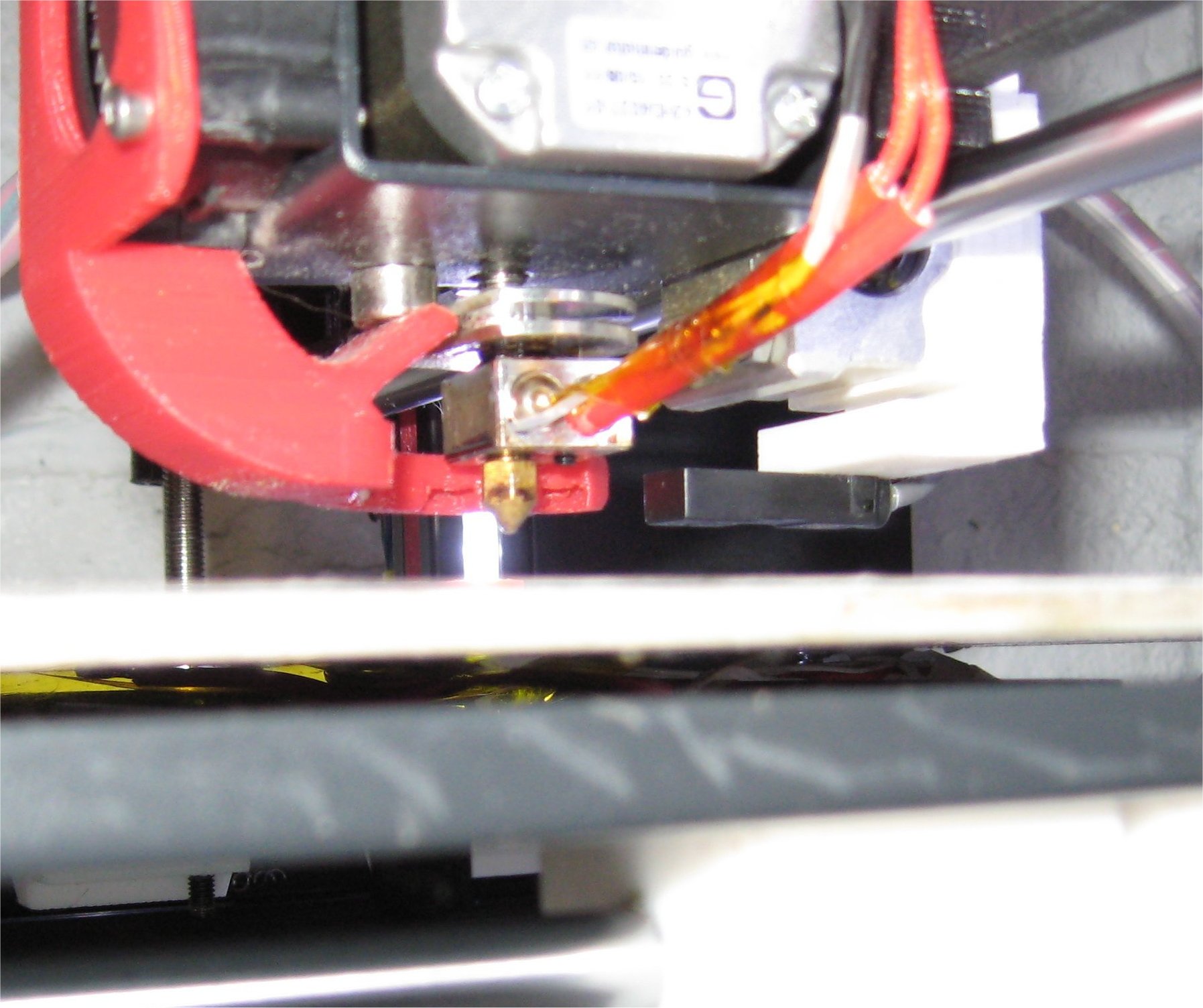

Hit a mechanical snag. The 3BTouch, 3d printed mount from several sources, including Thingiverse, shows attaching the 3BTouch to the linear bearing pillow on the back of the hot end. My pillows do not have the holes threaded all the way thru, I will have to remove and tap those holes in the pillow, so I can attach the the 3BTouch.
I can do that, it is just a pain. But maybe beyond the capabilities of some people.
Bob
Bob

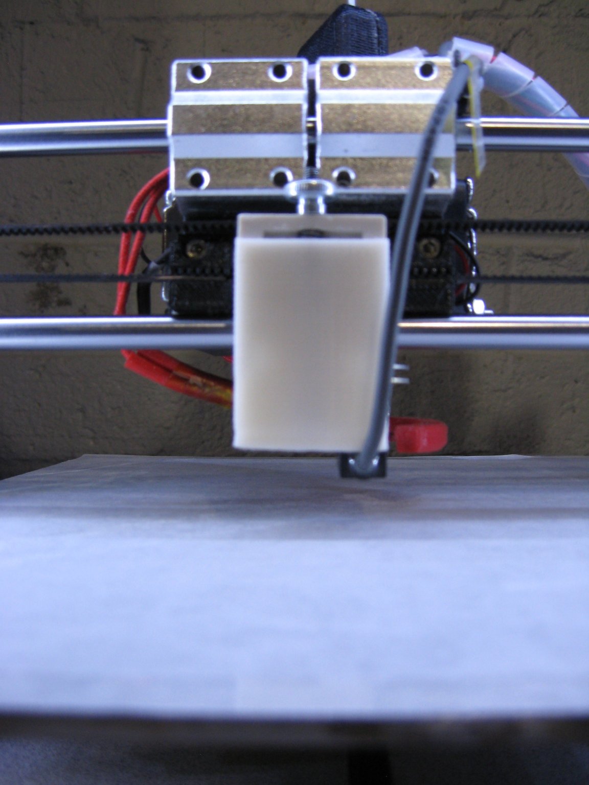

I connect my proximity sensors with a Adjustable Slide Mount.
Modified to work with TL-W3MC2 low profile proximity sensor on the White Mount below.
somewhere seen a similar BL touch mount Or we could modify this one to work with the BL-Touch
Using something like this
P.S. This mounts to the two lowest unused linear bearing holes, you can see them looking from the angle in photo below.
This is my newest an best Proximity sensor.

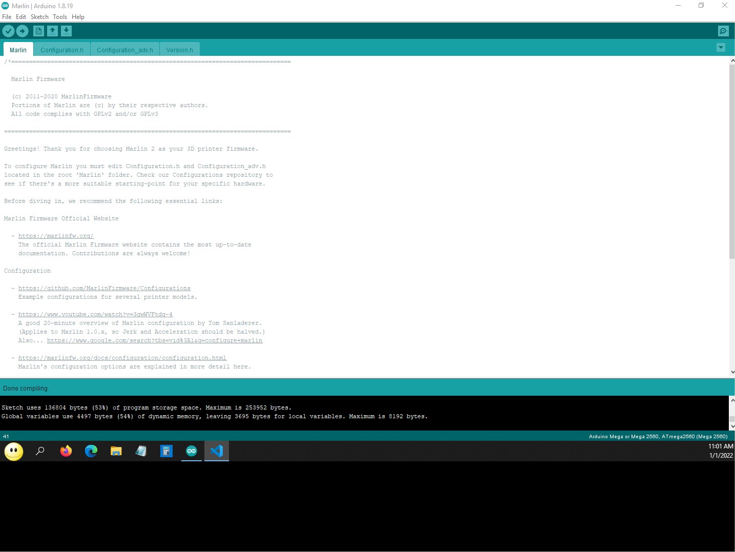

Today verified that the Firmware compiles with Arduino IDE it takes much longer to compile 2 min 30 sec vs 12 sec.

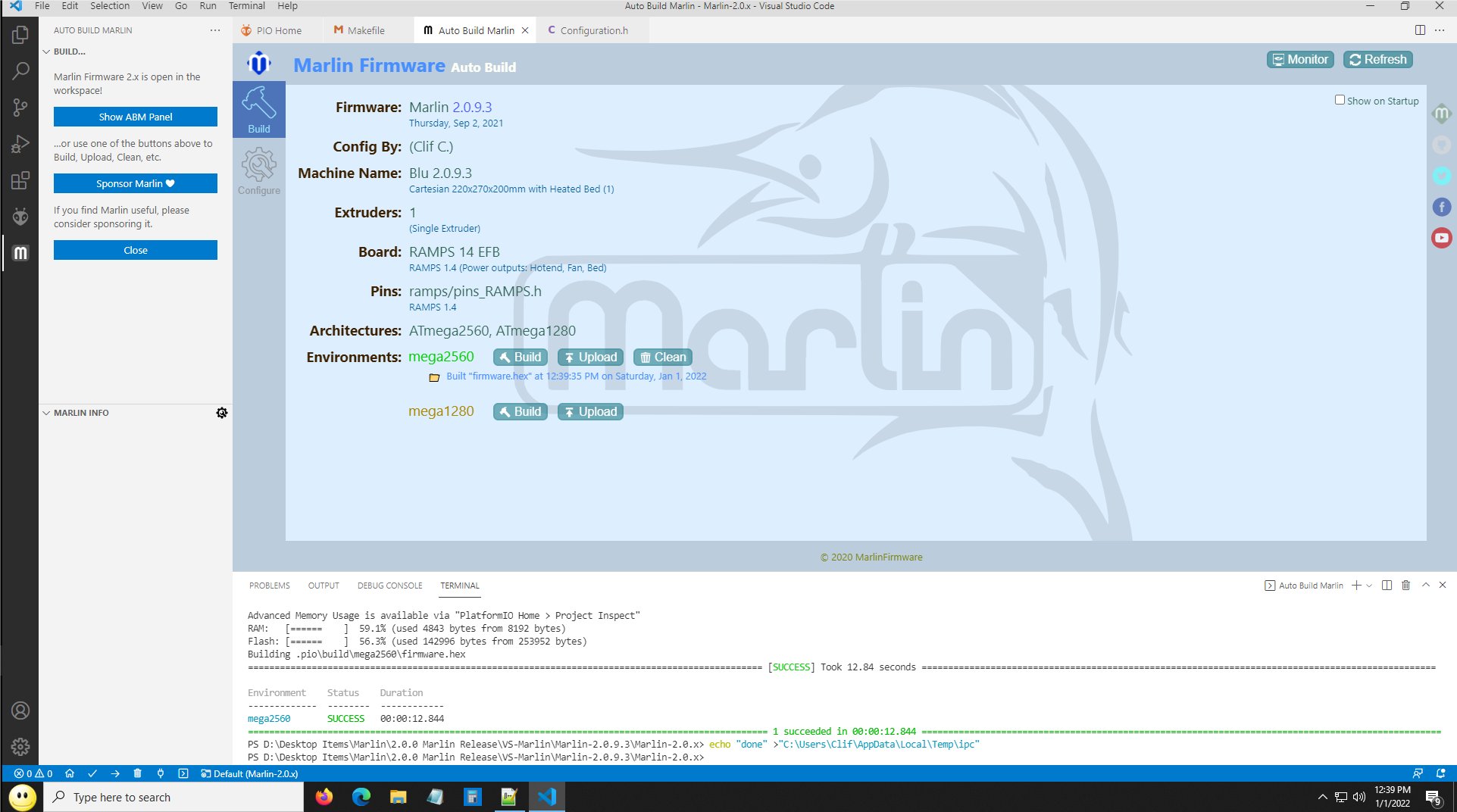

I still Prefer using Visual Studio Code > PlatformIO > Marlin Auto Build Instructions for Install found here.
I do have windows 10 using Classic Shell on top of the Standard Windows 10 Menu, :Noted by Smiley face Orb.
I downloaded newest Marlin 2 configure for my 3D Printers.

The compilers have an upload feature using a standard USB cable connected between the computer and 3D Printer.
Some Slicers have a flash feature that you can use to upload a compiled source code hex file to your 3D Printer.
Compilers are Arduino IDE would download I would install the newest, however this is a slow compiler.

Visual Studio Code > PlatformIO > Marlin Auto Build this is three programs two of which are installed onto VSCode.
This was shown in a previous post for Install information Click Here.

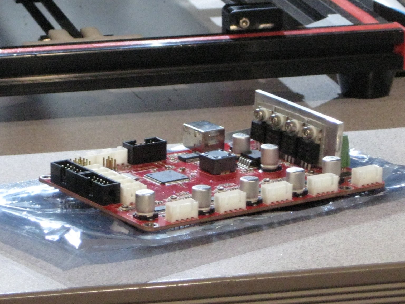

If my controller ever dies I will be using one of the below as a replacement.
Most probably it will be the Geeetech GT2560 V4.0 or BIQU MKS-Arduino-Ultimaker
Both having 3 extruders drivers then could upgrade my 3D Printers to tri-color mixing extruder or whatever I come up with.
Genuine MKS Gen v1.4 3D Printer Controller Board
MKS gen v1.4 3d printer controller board
It is always good to have backup Plans when working with things that could go wrong.

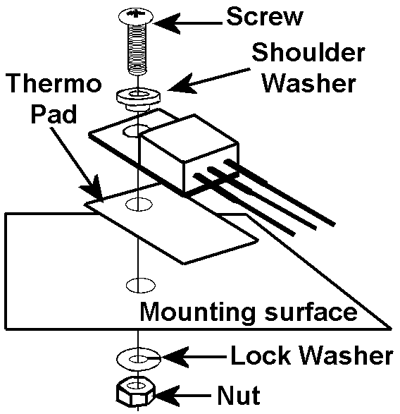

Don't know If you seen this but I have Added a to-220 heat sink an insulator kit to the Mosfet for longer life. Along with this aluminum bar as a heat sink. Give me some time to go thrugh configuration.

Re: HicTop 3dp-11 installing a BLTouch as a NewBe
OK here we go.
These two were reversed
I would enable an change all below
Your bed is bigger than you enabled.
You are limited the speed of the printer in this line
Here is a must have code compression program winmerge
Code: Select all
#define INVERT_Y_DIR true
#define INVERT_Z_DIR falseCode: Select all
#define S_CURVE_ACCELERATION // This allows for smoother curves.Code: Select all
#define X_BED_SIZE 220
#define Y_BED_SIZE 270Code: Select all
#define HOMING_FEEDRATE_MM_M { (50*60), (50*60), (6*60) }
