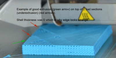

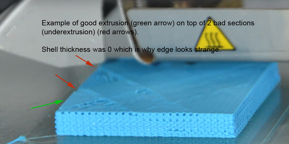

Well my favorite test is very simple. Start with a 30mm cube. Slice in (old) cura with no walls, 100% diagonal infill, and speed=100mm/sec to make math easier. When you print it, don't start testing until about 3rd or 4th layer when it is at full speed. Now pick a temperature and then start messing with the feedrate %. Since you sliced at 100mm/sec then feedrate of 50% gives you 50mm/sec. Increase and decrease until you are at the limits where you start to see gaps in the infill. Use a loupe or reading glasses and look carefully while it's printing. Once you determine the max speed, change the temperature by at least 10C and repeat the test after the temperature settles. In 10 minutes and a single cube you can get results for 4 different temperatures. Take notes as you go. Also you can further experiment with flow rate. I found you can safely increase flow to 110% or 120% but if you have to increase to 140% to close the gaps then you should slow down as you are likely to grind up the filament at these pressures (140% and perfect extrusion was only possible on a bondtech for me). I've done this test with many filaments, nozzles, temperatures, and feeders. I'll try to post a picture (I'm new at this forum).
Re: The Flex3Drive
Here's an old example. I have dozens of these cubes. This one was for the old black feeder that skips. But for the new feeder it's trickier - you have to look very carefully at gaps between the lines as it doesn't do sudden major skips but instead does underextrusion (filament slipping 10% or so in feeder)

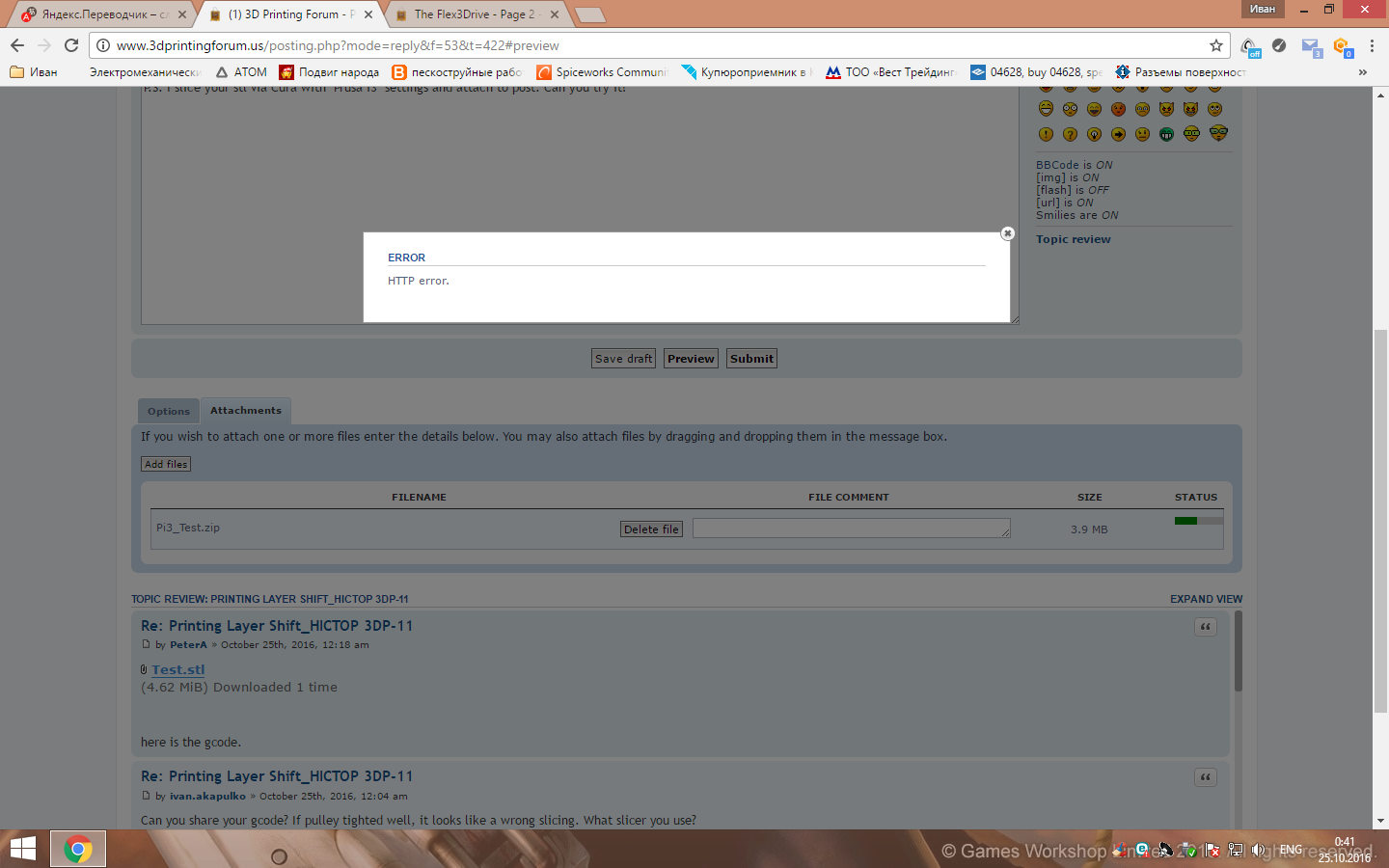

But still forum engine cannot upload large stl and gcode files. Can you remove this limitations?LePaul wrote:Side note...added ability to attach .gcode and .stl

Just about couple minutes before was trying to upload 14 mb gcode file, and forum engine told that is too big. Then i zipped it, and 4.35 mb upload smootly. 25 is enough, i think. In any case, for extraordinary situations we can use some cloud like Dropbox.

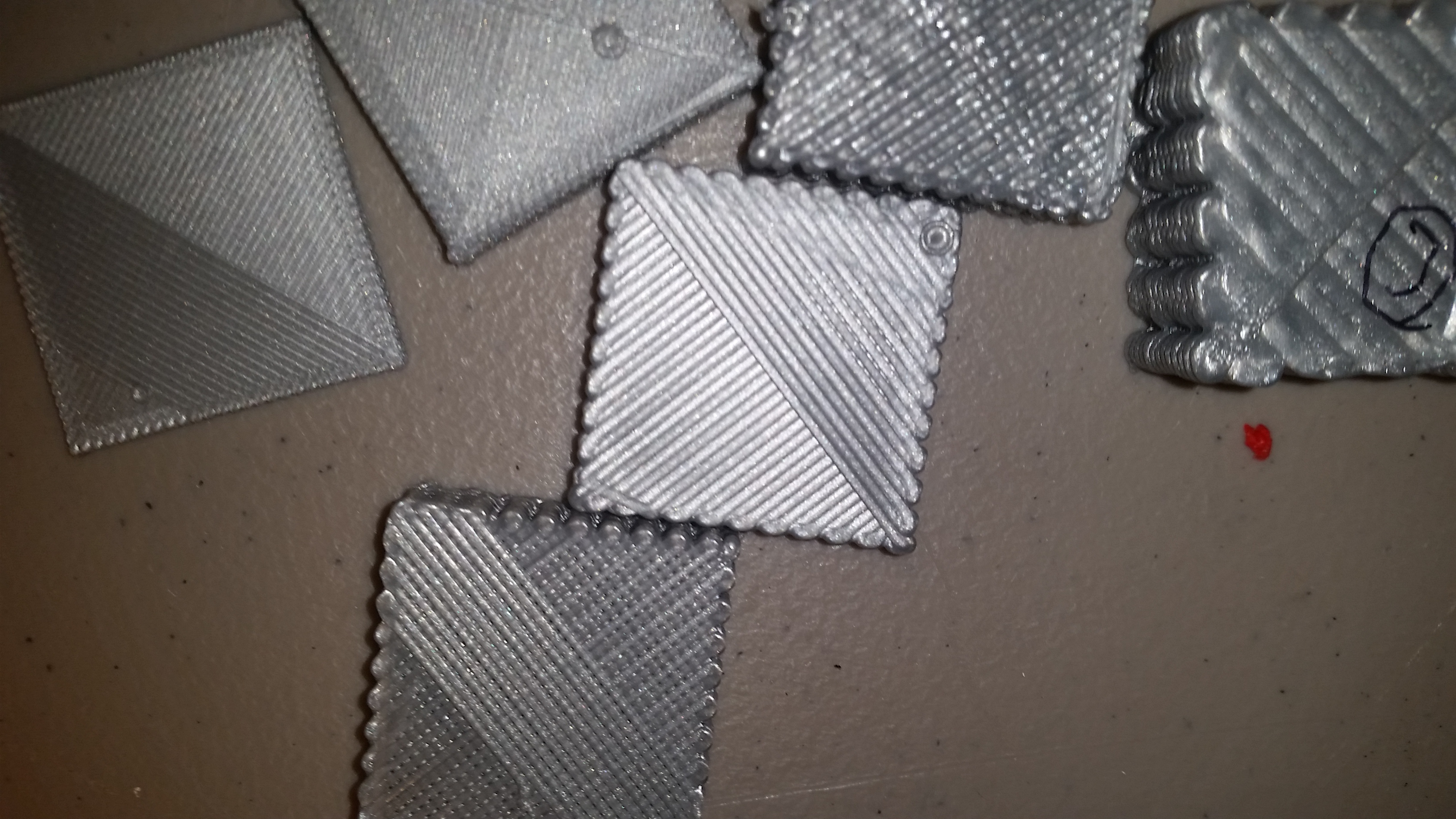

Here are a few test "cubes". On the top row 2nd from left is .4mm nozzle. Also here are .8 1mm 1.5mm and 2mm nozzles I believe. The center most square you can see about 20% underextrusion on the upper right corner/half. But the layer below is pretty good. The bottom most square has pretty severe underextrusion but still good enough to look great on a test cylinder - maybe around 30% underextrusion (30% gap, 70% fill).
When actually testing it takes seconds to change the speed and examine the print. Within a few minutes you know EXACTLY where underextrusion starts, and how much flow rate to add to fix it. Then you can test at a second and third temperature. So you get several results in the same time it takes to make one cylinder. You just have to take good notes.
