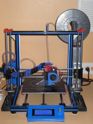

Found my problem. My new MPX.3 Backup controller from Hictop is Bad. Replaced with the Original Base v1.3 controller Flashed Marlin 1.1.5 worked perfect. Contacted Hictop will not talk to me, will not message me.
Printed the LCD case for Blu. Now will do some testing to see if any problems arise.
Printing a pop bottle bird feeder on my New Surface from Hictop Rep so far only build surface that has worked besides Vinyl transfer Paper Tape.
I like the Front LCD though, have not officially decided if I like the LCD style or not. Believe may re-mix it and post here for others.
