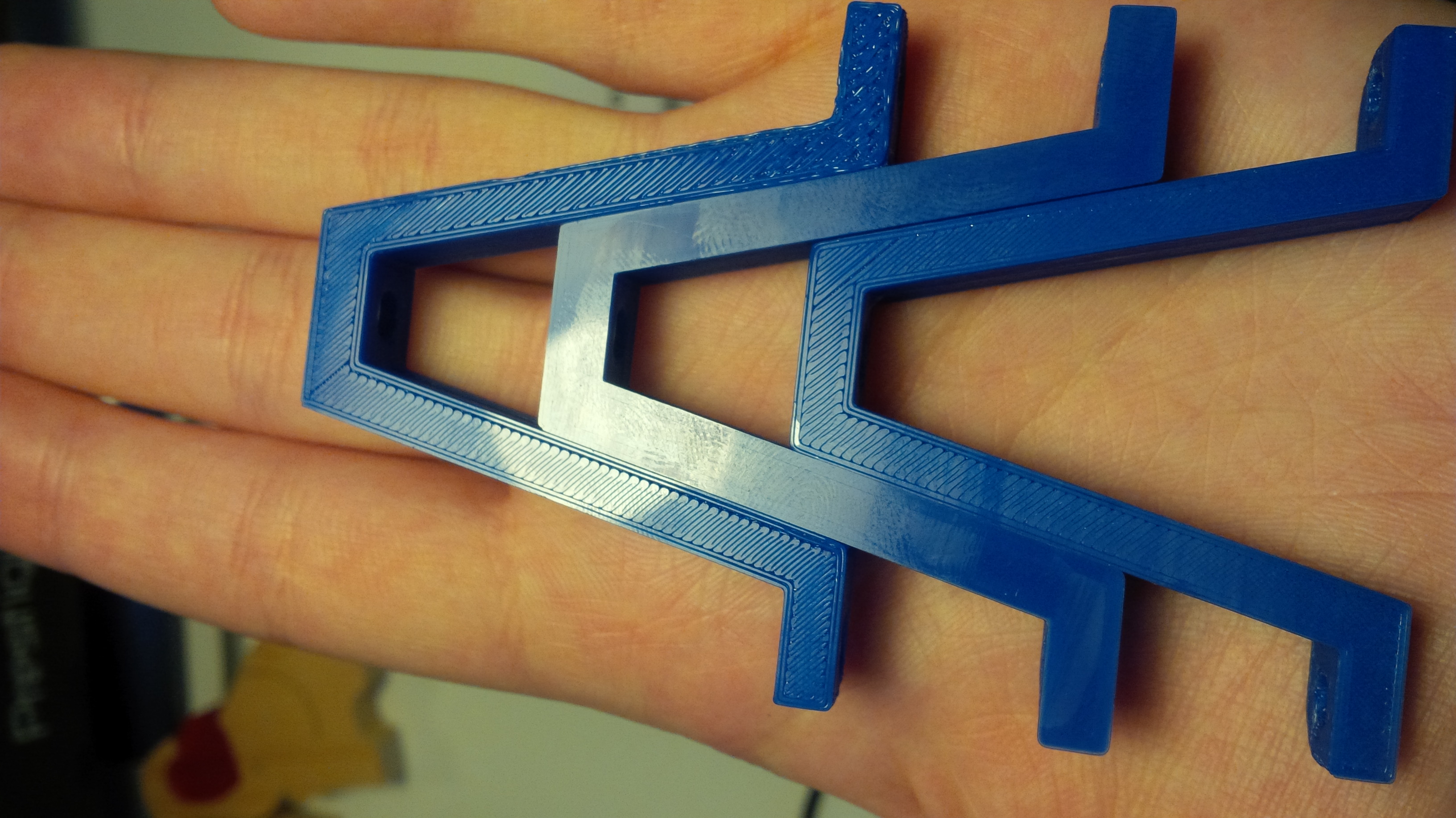

So I placed three of those on one plate.
Now with the new leveling(by eye and feel rather than paper), "new" coupler(aka, less shit), and the new glue(tesa stick lover now) it seems I can finally reliably print more than one part, one at a time 8-) The dream!
However I think my leveling isn't perfect yet as you can see from the difference in surface looks(they are all totally flat though). Any ideas to fix this?

Posts: 4062
Where on the bed was each piece? The middle obviously looks amazing, the top (far left in thumbnail) needs help. Other one not too bad

Yeah, I figured that, but I have no clue :P
Also, since all 3 points are coupled it's hard to just turn one 1 up right?

It could be that the glass is not 100% flat in combination with only 3 leveling points.
Post by Amedee »
or the X/Y rods bananas...
(Although the glass plate is not always perfectly flat, the probability to bend the rods is higher than bending the glass... :roll: )
Where they in that order on the bed, or was the middle and bottom ones swapped. I would think that there was a slight difference in the bed level.
The only problem I had with the glue stick was the build up, and scrapinging it off, I now use a good quality hair spray ( you can see from the picture I use polish not hair spray on my head :lol: ) from my wife, which I find gives a better hold on the plate for PLA's.
If you want to tweet the bed level I print 3x 1 layer thick washers, I place 1 close to each bed levelling screw in Cura, run the print, then measure them to find the differences, remember that the screws are M3 with a pitch of 0.5mm so if you need to alter one screw by 0.05mm it's 36degrees or 1/10th of a turn. IF you aim for 0.1 mm or 0.2mm depending on what you normally use for your 1st layer you will be on the ball, it's well worth spending the time to get it right for better prints.

There's a glass store near me...might be interesting to get a different piece and compare. Anyone know the glass specs off hand?
Also check the levelling screws heads, make sure they are below the level of the aluminium plate, mine were proud before I gently increased the countersink.

nilrog wrote:It could be that the glass is not 100% flat in combination with only 3 leveling points.
"Only" 3 points is still the best solution possible, since three points define a plane without trying to bend the bed, anything more and you will have to rely on trying to bend the bed to shape.

Izzy wrote:If you want to tweet the bed level I print 3x 1 layer thick washers, I place 1 close to each bed levelling screw in Cura, run the print, then measure them to find the differences
And to verify that your bed is flat you should print one in each corner.
Meduza wrote:"Only" 3 points is still the best solution possible, since three points define a plane without trying to bend the bed, anything more and you will have to rely on trying to bend the bed to shape.
If you have a perfectly flat plane, then yes, 3 points is the best/simplest. I never disputed that. The case was if the bed was not 100% flat.

Post by Meduza »
And if your bed is not 100% flat in any direction a 4 point bed will probably not solve it since it can be bent in quite many ways that cannot be fixed with a 4 screw setup either, to be sure that we can fix any bent surface we need a infinite amount of screws at a infinite number of places, and that seems like a very tedious bed leveling process to me, and i rather pay some more for a flat bed from the start ;)
