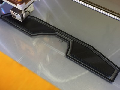

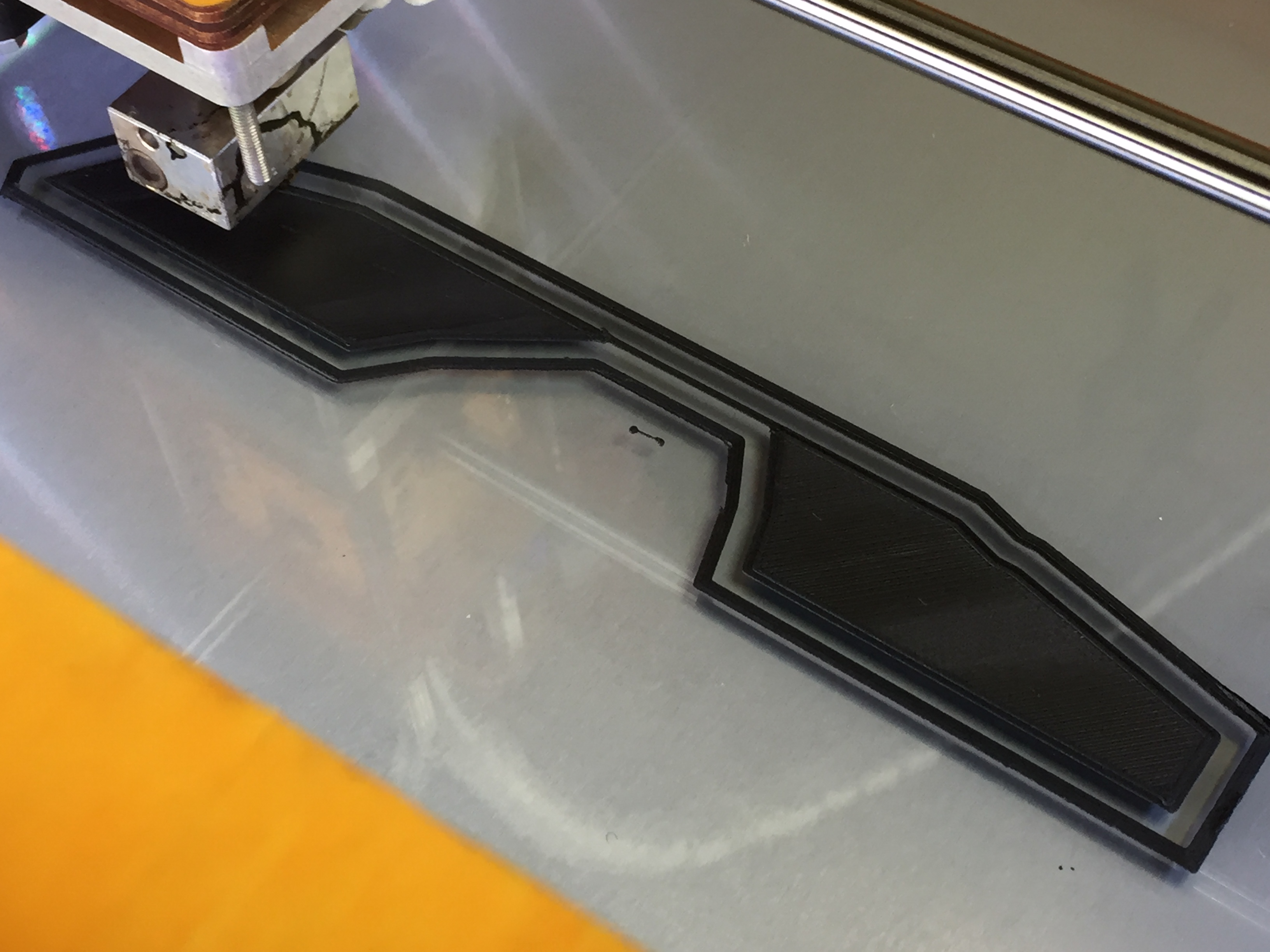

Re: Fan shroud upgrade
Off we go. 5.7 hours to go since I opted to print slower (40 mm/sec)

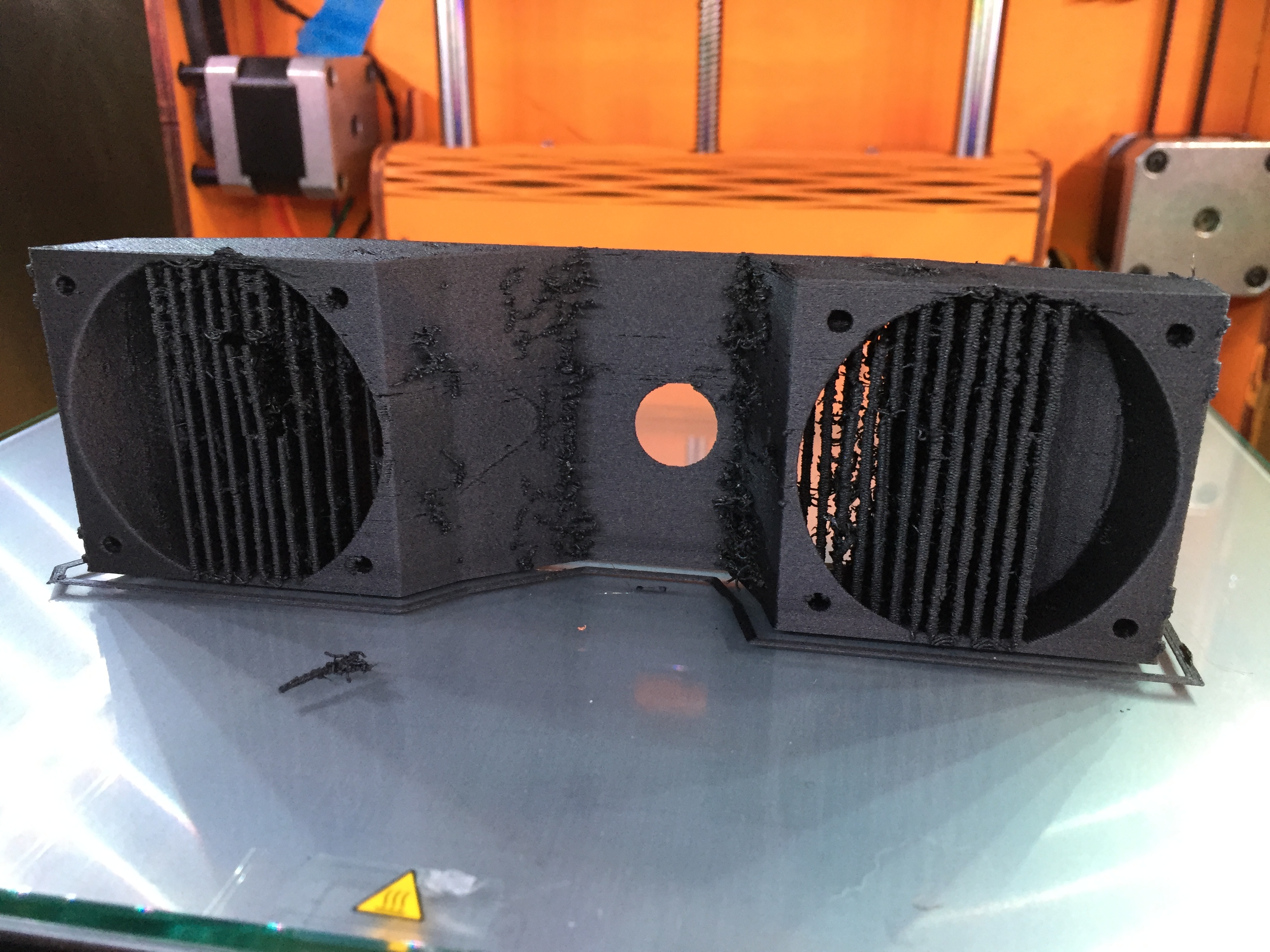

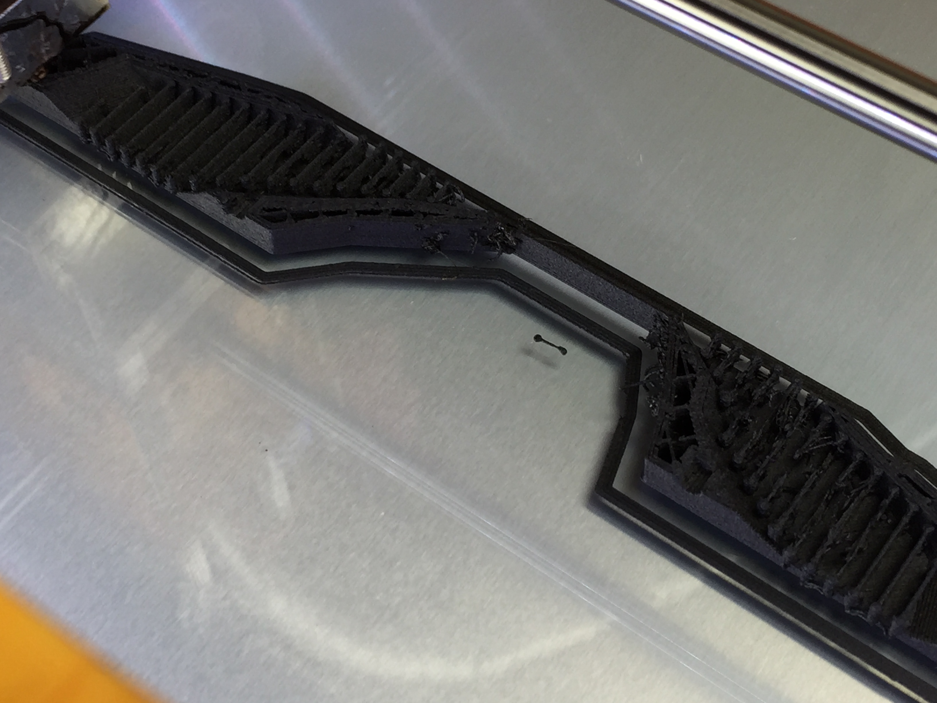

I'm at a loss why the supports look so bad on one side
It's me or your walls don't touch? Maybe it's the photo but seems they have gaps.
Posts: 4077
Somehow, by the grace of God, I have a usable part

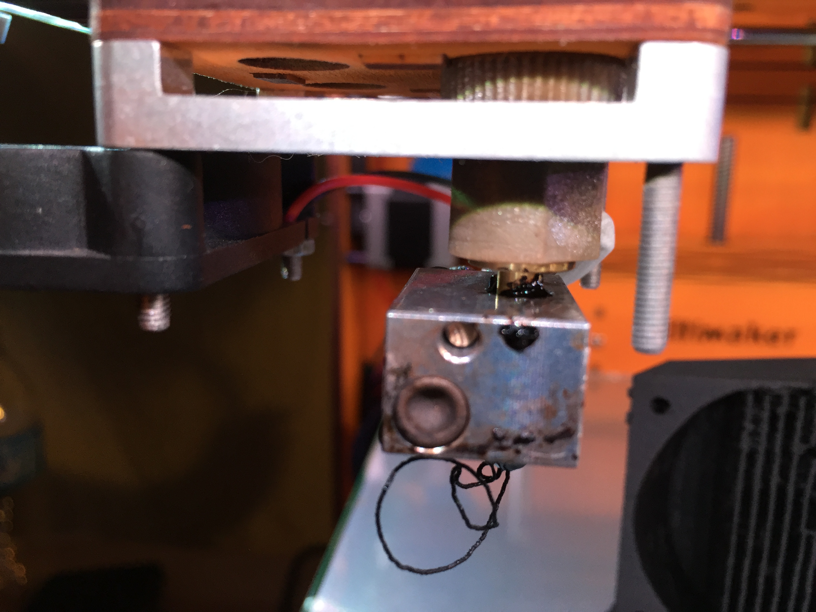

But now I am wondering if I should consider replacing the pieces above the heater block (I have spare parts from the dual extruder Kit I never used)

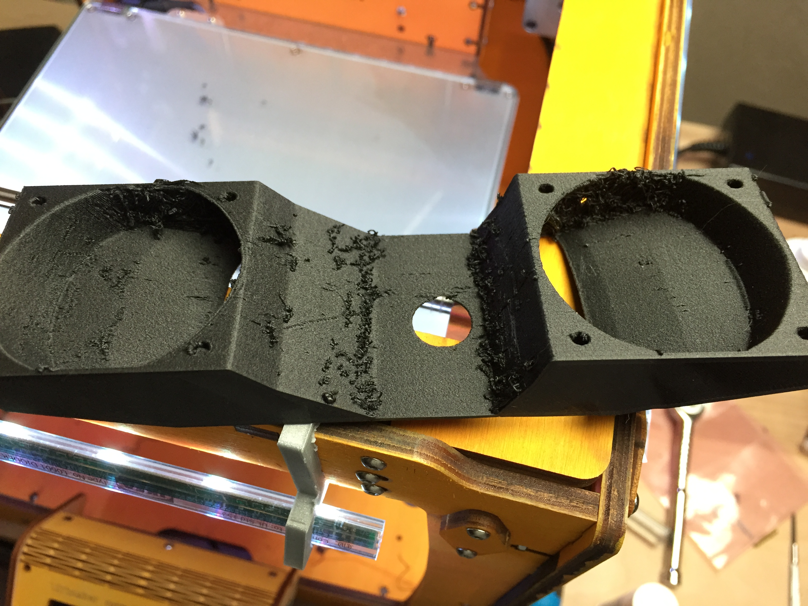

After removing some support material.
Boy this stuff (CF20) can't bridge at all even with support.
Carefull cleaning it. It stings like a b..
